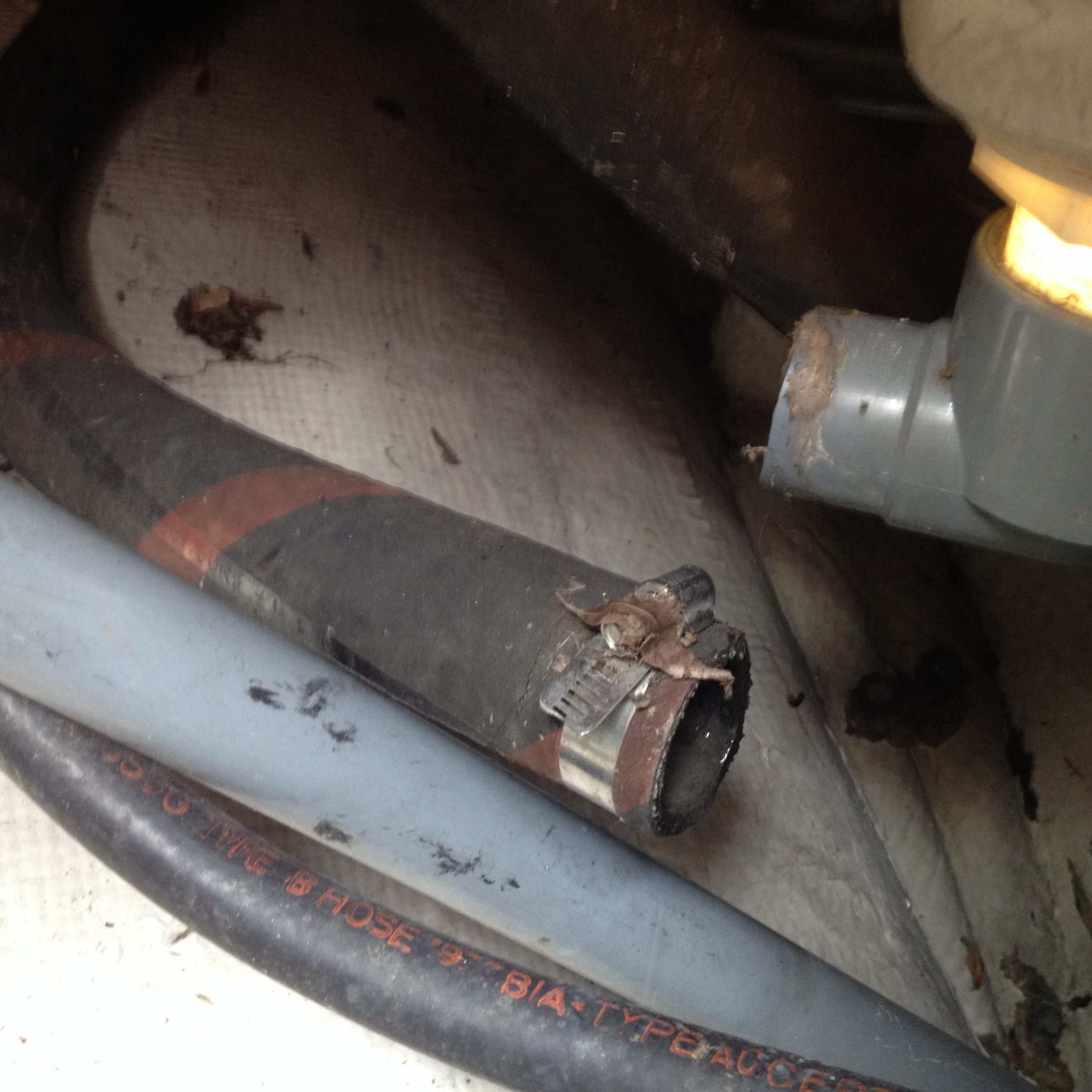

I had a similar water collection while motoring, only determined the leak significance when I also saw the bilge outlet spewing water beneath the toe rail. Ultimately I found that one of the scupper drain hoses from the cockpit had come undone. I could only access this hose from the starboard side lazerette. The hose dropped to the level of the stern drain port and when we motored through a wave or wake the external port would dip below the typical waterline, burping a half gallon of water under the motor and right into the bilge. Easy fix...no more leak!
