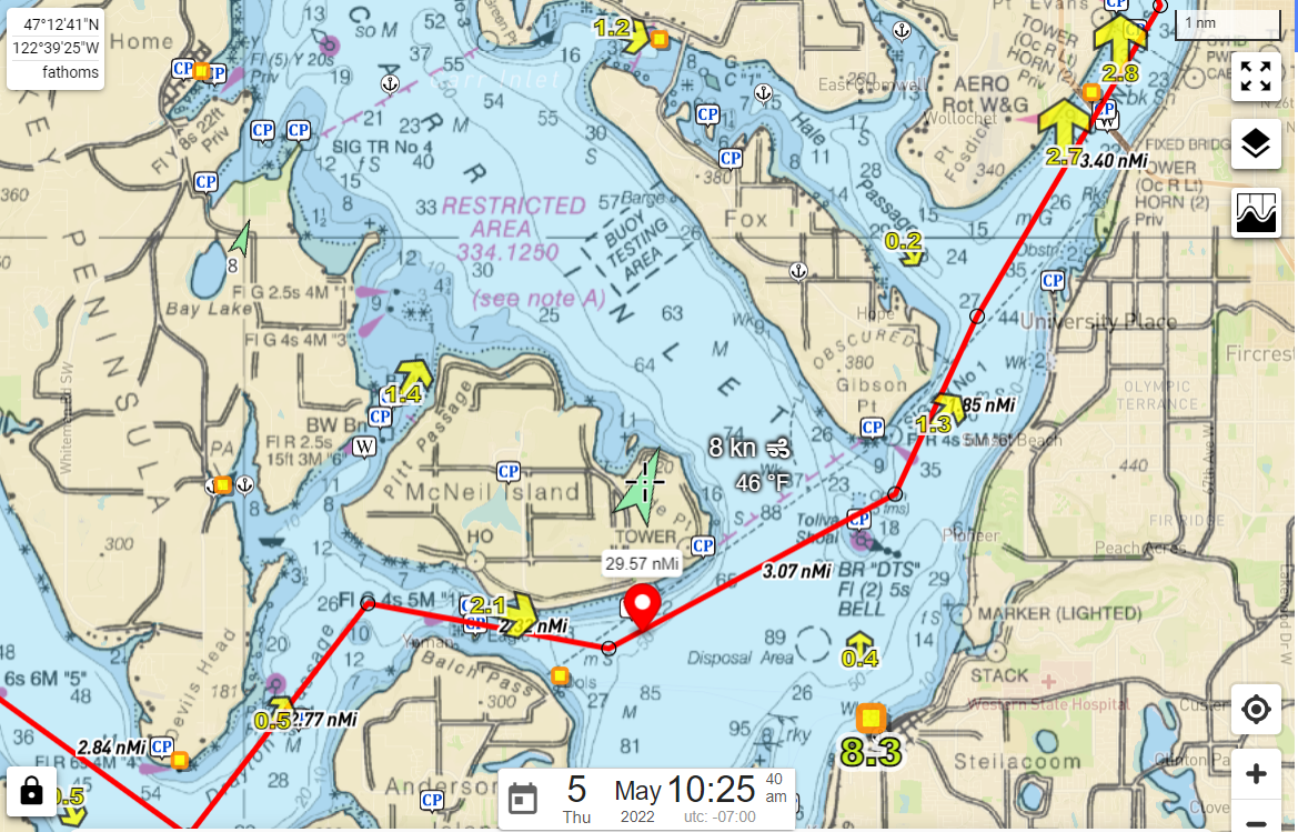

Thanks for the replies. I have already been doing numerous "trips" on DeepZoom and that prompts the question. The first day in no problem. Anacortes to Kingston. Depart Anacortes 5/4/22 08:00 with an ebb tide down to Partridge Point. should arrive 1-2 hours early for change to flood so will need to hug the Whidbey shore for current relief in the eddies. Then pick up a nice flood to push us down to Kingson. Might end up going farther because that is 50kn of a 11km trip.
Day 2 (5/5/22) is the bigger problem. The Narrows are adverse from 08:30 to 15:00 and that is about halfway. If we are to do the trip in two days, it would take a very early start to get through before ebb or a very late arrival to go through with the flood. I do not know the Narrows so do not know if it is possible to go through against the current. Add to that the forecast 15+kt southerly it doesn't sound to good to me. In my old friend (Deception Pass) that is a fool's errand.
Apr 5, 2009
3,327
If we push day 1 to Eagle Harbor and leave at 05:30, we might get through before it goes over 2 knots. We would still have several other smaller passages with more than 2 knots but lots of day to push through them.

We’ve been through the Narrows a couple times. Sounds like you have it pretty well figured out. We’ve always tried to schedule the Narrows as close as possible to slack, but you have a couple knots of boat speed on our little 22 footer - we move awfully slowly against a 2-knot current, but you’d still make progress. Even at close to slack, we found the Narrows to swirls a little; it might do so a little more with more water flowing, or maybe that will die down as the current picks up? That could go either way
We’ve stayed in Colvos Passage, W of Vashon. Mostly to avoid some of the shipping traffic. No complaints there, but no knowledge about the E side.
We’ve gone N of Fox island, but watch your clearance on the bridge - our mast is shorter than yours, and even after repeated calculations, it makes this skipper’s heart beat pretty fast to look up going under that!
Pitt Passage (W of McNeil) is known to be tricky, but here are good instructions in the Migael Sherer guide (A Cruising Guide to Puget Sound and the San Juan Islands). We’ve followed them many times.
Where are you headed? Be careful you don’t go advertising too widely for all the great S Sound destinations :)

The narrows can get going pretty good, I have yet to experience a "no go" scenario heading south due to current but you can sure spend a lot of time motoring against a 4+ knot current. Planning goes a long way and if you can't do that, usually diesel overcomes the issue but slowly. I have had no go scenarios due to fog. I would time it during the most slack time you can. Heading to Olympia, I would cut between McNeil and Anderson through Balch Passage. Current can get going through there but it is a pretty short distance. Filucy Bay is a good anchorage or overnight if you looking for something in that area. Penrose is another but a little off course.
There is a consistent northerly current through Colvos Passage. Going north from Tacoma I always take Colvos. Going south I always take it if motoring because it is significantly shorter than the west side and you don't have the commercial traffic lanes. If sailing I tend to take the west side due to wind direction and width of the waterway.
If you are looking for site seeing opportunities I would consider Carr Inlet and utilize Pitt Passage (check current/tides) and either utilize Penrose on a mooring buoy or anchor in Filucy. Don't go to the inside of Fox unless you can make it under the bridge. Case Inlet is really cool also but it's a long way and you cant get around the northern side of Harstine due to bridges.

Thanks for the heads up on the Fox Is bridge. With a 42' stick will will most surtainly not be going under a bridge with 31' of vertical clearance! It looks like we might get some current relief by going north of McNeil but not sure it would help much.
We go through Deception Pass in up to 7 knots of current going our way without concern so are used to the swirlies. I just don't like going against it and going nowhere. One day I watched the Lady Washington back under Deception Pass bridge because she tried and failed to get through against the current.

Thanks for the heads up. I figured that the Narrows would not be anything like running Deception at 7 knots. I have only gone through Deception against the flow once in the hundred or so times through and that was a day when slack was about 30 minutes early due to wind. It took me 30 minutes to move the 1/4 and I was beginning to wonder if I would need to throttle down and back out.
I posted the current predictions for the approximate time in a previous post. We are looking at Thursday morning.

Hayden, from what I remember during a trip in the summer of 2018, there was a significant back eddy that overcame any adverse effects from the ebb and in fact assisted the trip south. We did cross over after rounding Pt Defiance but I cannot remember exactly where we did that. I know that we had been following the west side of the Narrows well before we crossed under the Narrows bridge and remained there until we turned to Starboard South of Fox Island.
All my cruising guides are on the boat and I am not. I believe one of them gave detailed info as to how to transit the Narrows.I will caveat all the above with: slack or flood is better. But . . .
Thanks Len. I will be going to my boat later today and will grab my copy of Tidal Currants of Puget Sound.
Hopefully it will show the eddies you mention. I use it to find my way south along Whidbey in an ebb.
