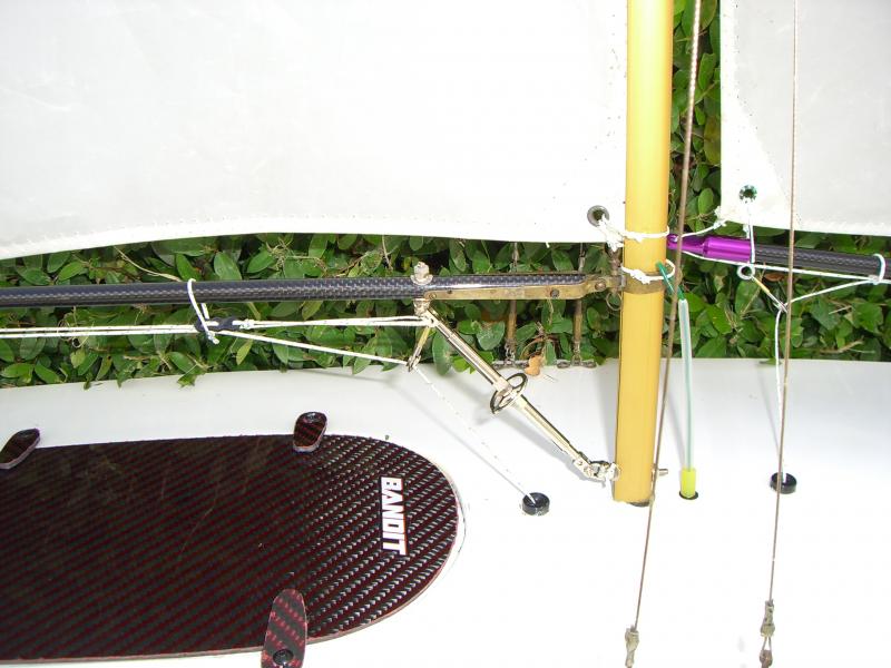

This is how I do my model boats.
One line through the tack gromet around the mast that holds the sail to the mast.
One line through the tack gromet to that holds the sail down that can be mounted to the mast via cleat or around the boom if the boom secured.
You might try a line around the open ends of the fork in the boom to keep it attached to the mast.
There is another line around the mast that just hold the antena wire to the mast for the r/c reciever.
