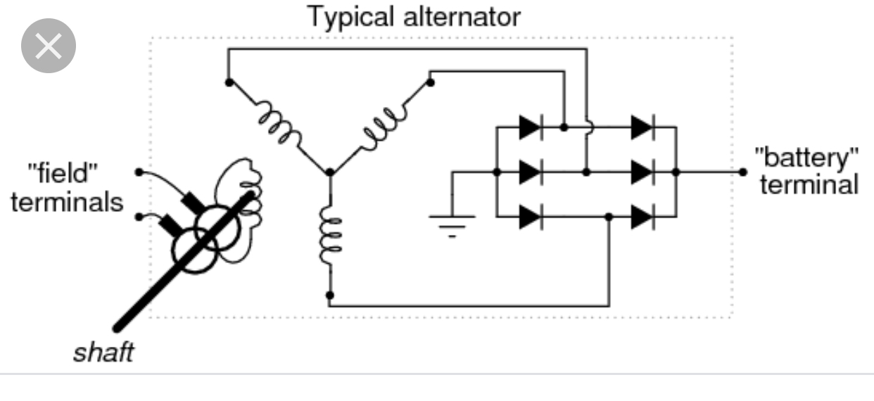

Since most tachs are connected to the alternator, this can indicate a blown diode. The alternator may still function, but not as well as before.
May 20, 2016
3,015
I doubt a diode would do this. The tax signal is measuring the AC frequency, so is measured before the diode pack.
jviss
Feb 5, 2004
7,090
Tartan 3800 20 Westport, MA
If your motor is a diesel (and most gas), then more than likely there is a blown rectifier diode in the alternator. The Tach counts the number of alternating current (AC) cycles from the alternator.
The 6 diodes are arranged in a three phased full wave configuration. If one or 2 diodes are dead, the AC pulse will be missing at least 1/3rd. The needle usually fluctuates a tiny bit but the weight of the dial arm smooth it out. That's why at high speed, the needle seems to be steady.
Bring your alternator to any automotive electric shop and have them check it out. It is not too expensive to replace the diodes.
It's possible you switched the battery selector while the engine is running. That action usually blow the diodes."
from:
https://forums.sailboatowners.com/index.php?threads/tachometer-needle-bouncing.138102/#post-891251[/quote]
capta
Jun 4, 2009
5,069
I lived with this problem for several years and new diodes fixed it.
May 20, 2016
3,015
I guess I’m confused why would they measure the ripple on the DC side for frequency ?
This is the only place where a pulse is lost with blown diode - and it would be consistent, not blown for a couple minutes then working again.
