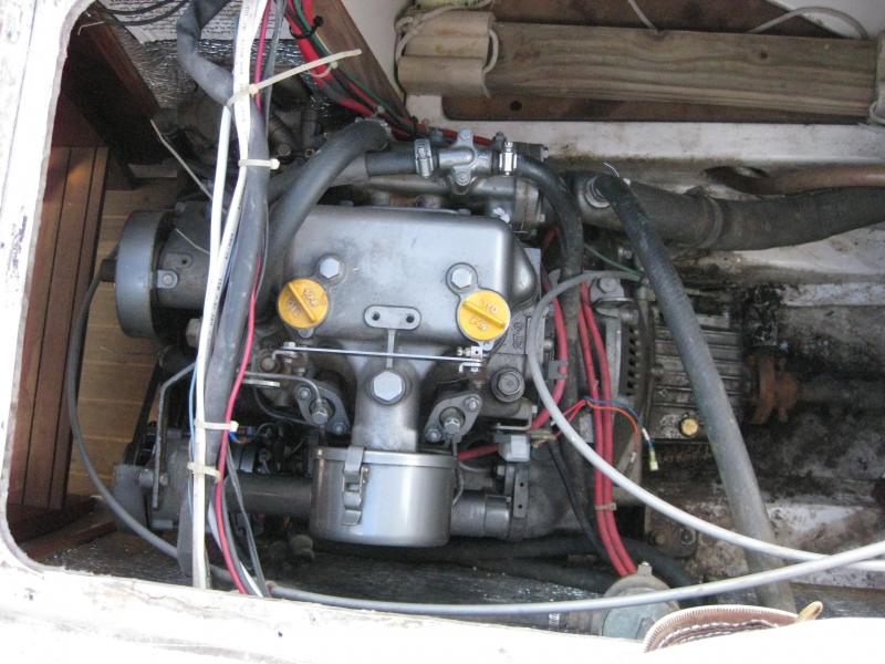

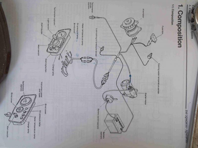

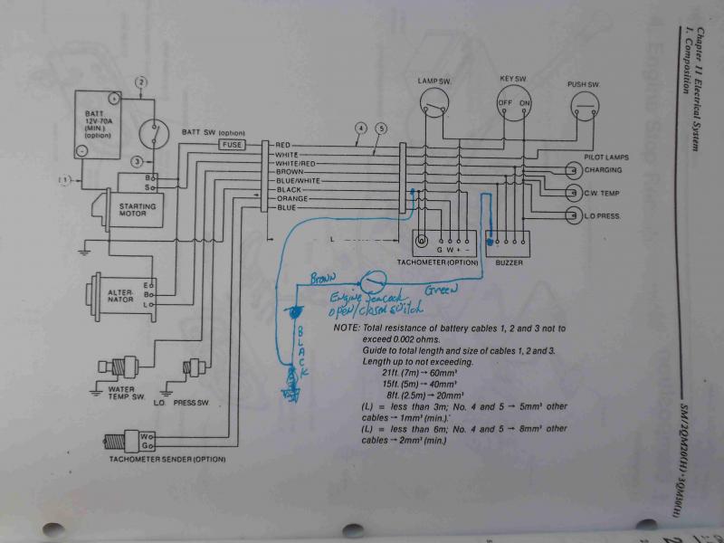

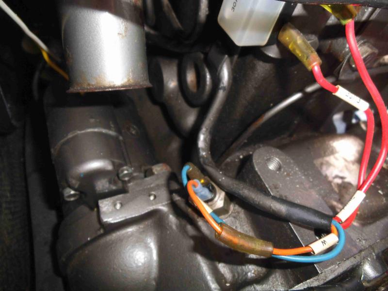

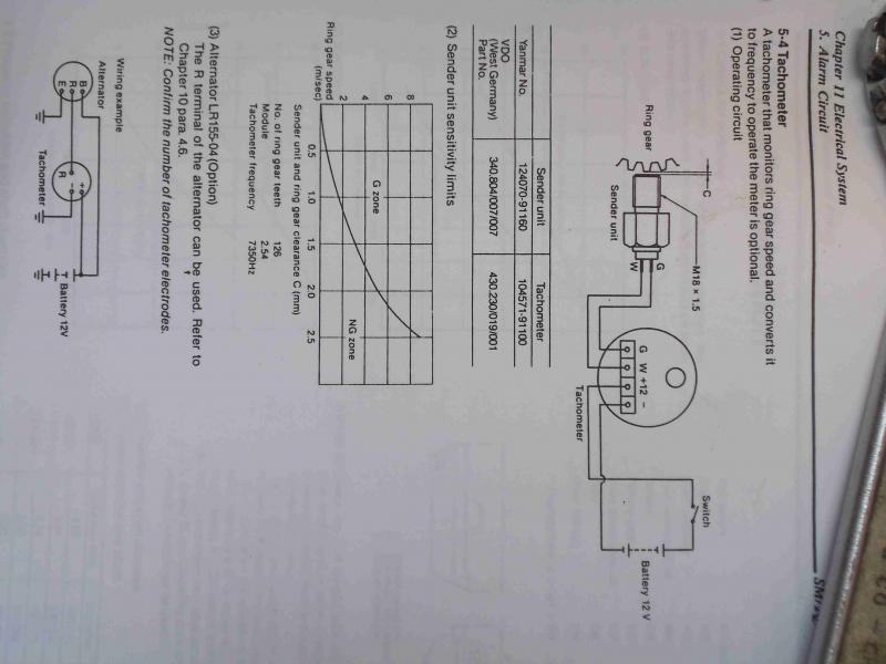

Attached are pic's of the 2QM20 manual pertaining to the tach system/circuits. Also, a picture of the actual sensor on my engine showing the orange and blue wires that are specified in the manual. Please excuse the blue ink writing on 2325.jpg which documents my "forgot to open the sea water seacock" alarm circuit that I added to my boat after a scare when I left the berth without the seacock open. Note on the bottom of 1024.jpg, that Yanmar states that the R terminal of the alternator can also be used for a tach. Maybe this output will enable a generic after-market tach gauge? You will have to do your own research on this. Hope something in this will help.
rardi

thanks for the info and pic. Looks like I have the wiring but on pick-up screwed in the flywheel housing.
JC
