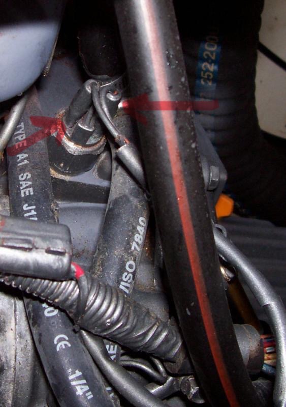

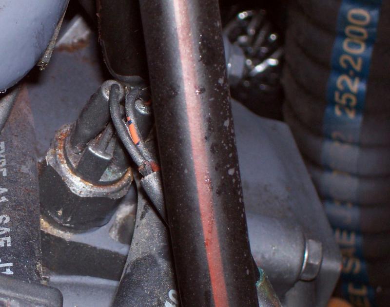

I did what I have done in the past when this happened. I took the 2 connectors off the sensor on the transmission, cleaned them with a quick wipe of emery cloth and put them back. Now all is good again.

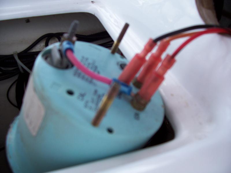

In fact the connectors looked bright and clean when I removed them, fit tight and snug. I checked the same at the tachometer and they were clean as well.

Yep, I've got a randomly reading tachometer on my Yanmar 3JH2e. There is probably corrosion inside the wire that increases the resistance in the wires. One of these days I plan to replace the wires from the sensor to the tach. Another Yanmar harness failure.

I spray the contacts with Deoxit D5. It has given me excellent results but I have no idea if it is the best.
Be warned, it is very penetrating and loves to get into LCD's and ruin stuff like clocks, scales etc so use with care.

There are two multi wire connectors in the harness between the sensor and the tachometer. Clean and check the sensor wires in those connectors as well.
