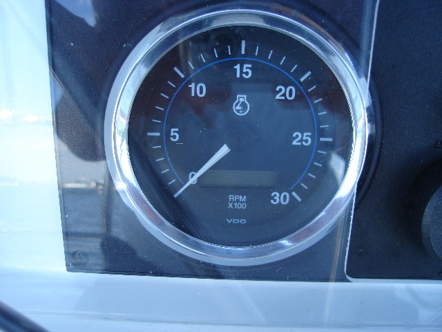

I bought a VDO programmable tach on eBay including shipping for $20. With a very slight modification it fit in my panel perfectly.
A programmable tack is one that you can adjust the number of pulses per rpm of the engine. It is necessary so that you can adjust for the number of poles in the alternator and the pulley ratio of the engine to the alternator. You need an optical tach (borrow or buy for about $25) to calibrate.
See pix below for old and new.

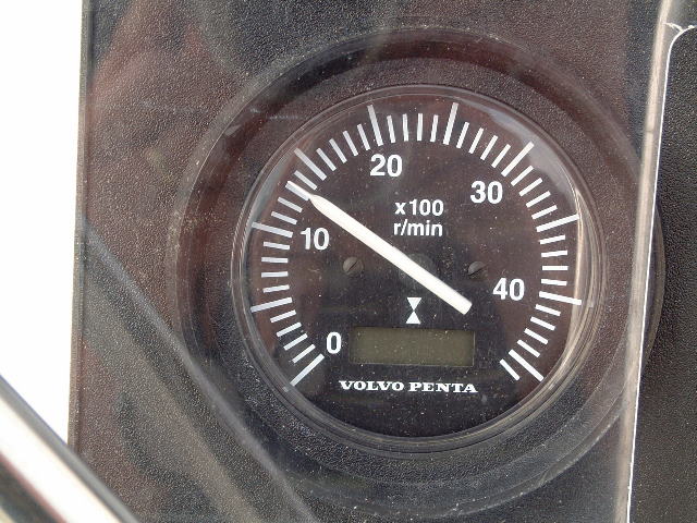

i just bought a used panel on e bay last week and gave $100.00 pluse some shippingi needed some of the orther things in the panel so i just bought the hole thing .....that was good for me......i also need the tach pickup for the flywheel and found one that is the same thread size as the yanmar at a local NAPA store for $29.00...so now i am not sure if i have to add anything to the flywheel to make it pulse or not ....usealy when useing a proximity switch there has to be some thing to break the circle in order to make it pulse so i ahve some more research to do i think..... pic below
