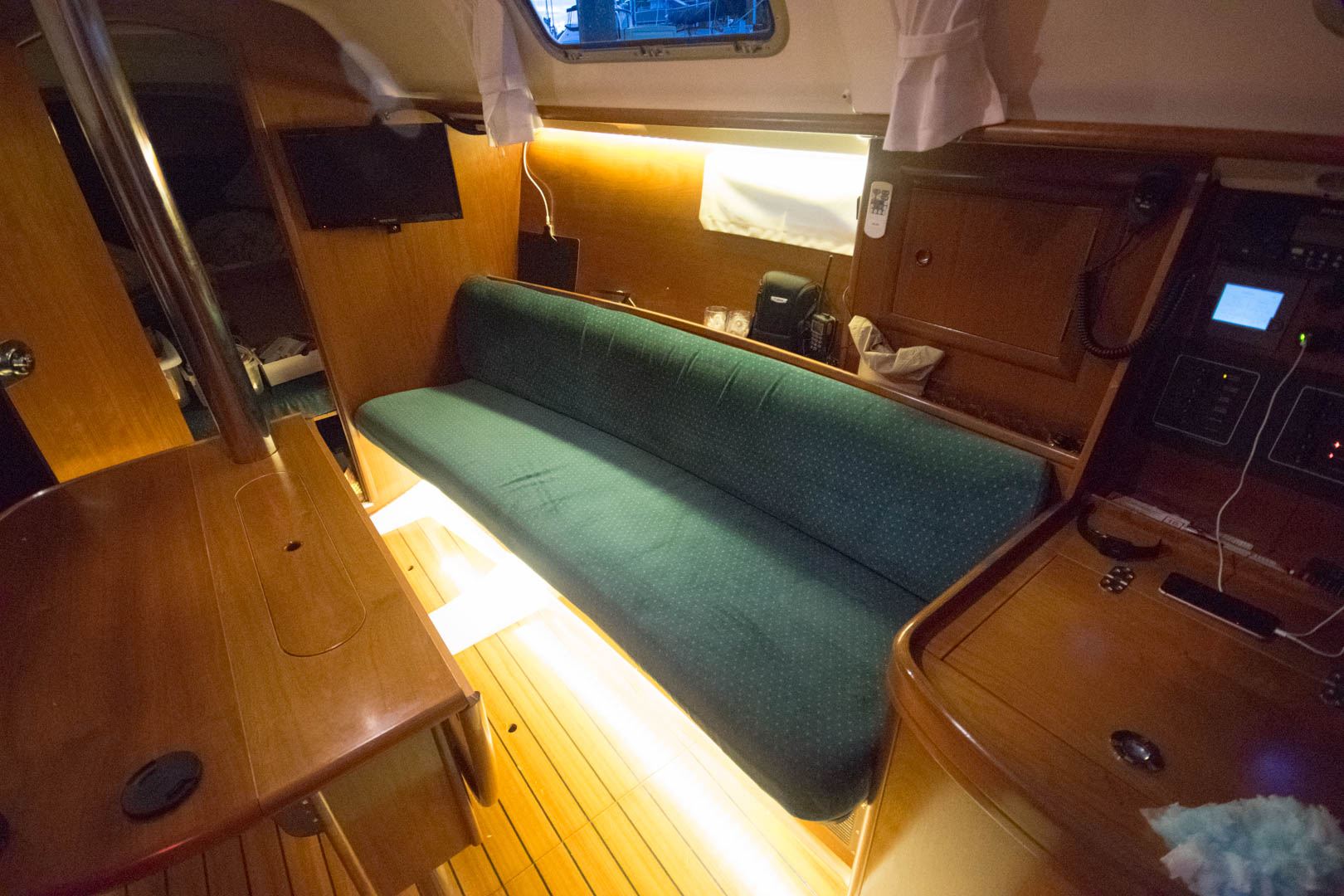

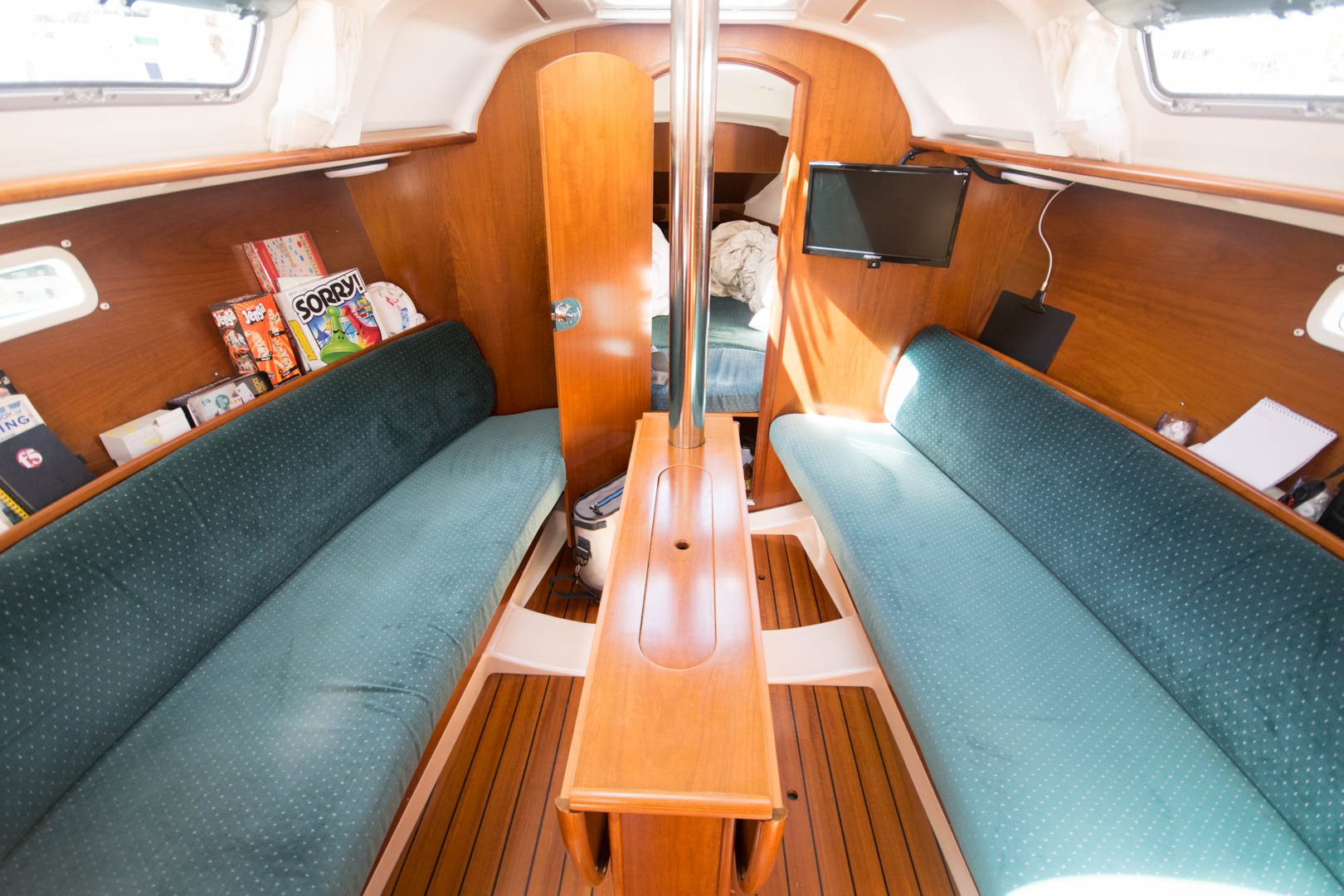

Sorry was looking for pictures today. It is all wood from what I can tell. No inlays in the table, but it folds down, and has some complicated edges. The edges look really good, it's just the central portion of the table that looks rough. That's probably because it's always available and the center section is always available.
There's no way I want to remove it - it's around the mast.
Pictures attached below.

Interesting lighting Steve. Is is practical as well as pretty? I am looking for ways to improve the ambiance in my salon. The ceiling lights are harsh.

Since the mast goes through it, only the center part is worn and it is a different color anyway, I would just sand the top of the center part down to wood and refinish that. It will look a lot better. You can refinish the rest later if it still looks like it needs it.

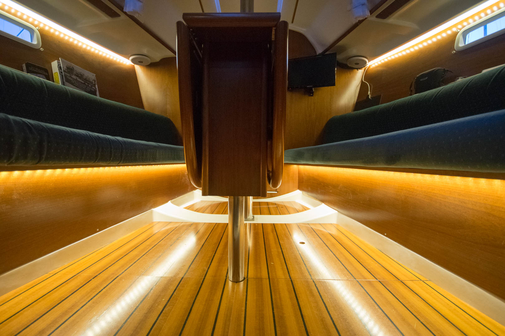

The lighting is very practical. I wrote a bunch on it at https://www.sailbits.com/blog/2016/07/ambient-led-cabin-lights/
I am super picky about the quality and temperature of my light. I even replaced all my overhead halogens (documented here https://www.sailbits.com/blog/2016/04/halogen-light-replacement-cree-leds/) with something that was LED for power savings, less heat, but also a much nicer warm temperature.
The LED strips that you see in that picture are very functional - I can dim them to a ton of different levels, change colors to a red or blue when underway at night, etc. I also have the same setup in the owners cabin which is wonderful to leave on super low at night while at anchor so getting up doesn't require much light adjustment or stumbling around.
Plus they just look really, really nice.
Thanks but I definitely do not want the middle piece to look totally different - we use the table expanded (I can't find any pics!) a lot, and that would look super weird!
