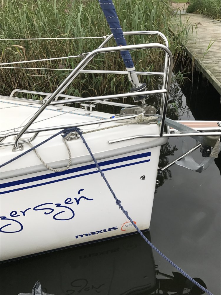

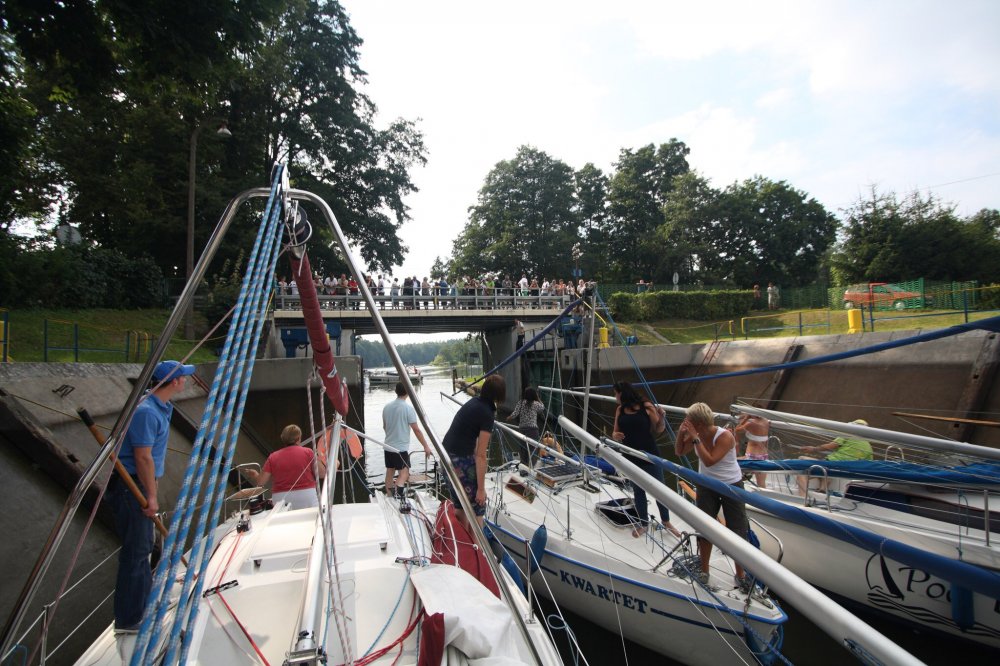

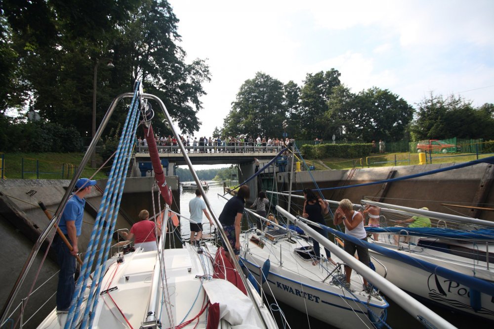

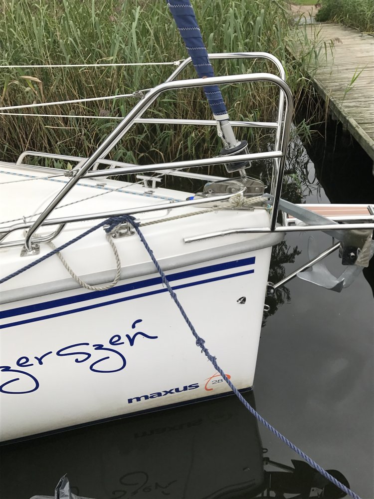

In the northeast of Poland they have a lot of interconnected lakes and a great sailing tradition. Their road/rail infrastructure never considered sailboats except in rare cases like a section of road that turns 90 degrees by hand. I digress.
The majority of the boats have a tabernacle mast raising/lowering system. You can see it in the picture. It is the rail running just above the top sides, almost parallel to the water and follows the shape of the bow. It is hinged at the two aft points and a block and tackle system connects at the fore end, the apex of the bar.
The process to lower is disconnect the gooseneck and lay the boom to one side.
Pull the lock pin which also has a safety ring at the base of the jib halyard (probably not the right terminology). There is a line that runs from the base of the jib halyard back to the cockpit. It runs through the blocks between the base and the attachment. It is the red with right tracer on the port side in this picture.
This line controls the mast falling backwards. Ease it and a little push and down she goes.
To raise, pull or winch the mast back up, pin it, reconnect the boom, and off you go.
Here is another picture showing the mast laid down. The blue line with white tracer is the line that controls the mast.
A couple of the groups I sailed with got good enough to take this down in under five minutes. Could be done by one person, but it was always nice to get everyone involved even if some only helped wrangle all the lines and stays.

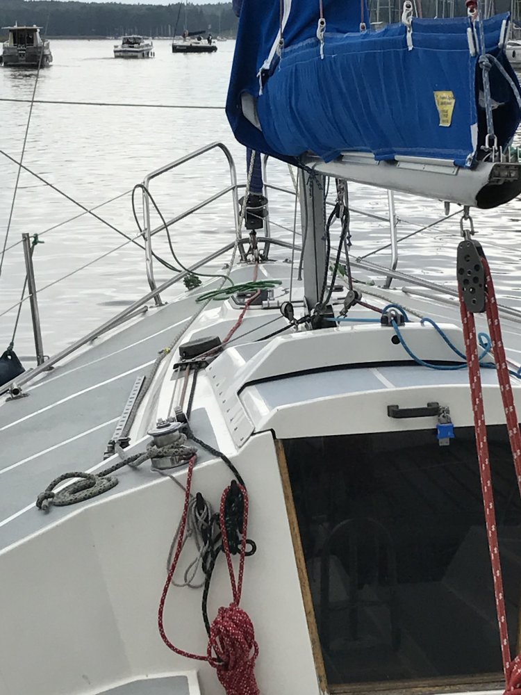

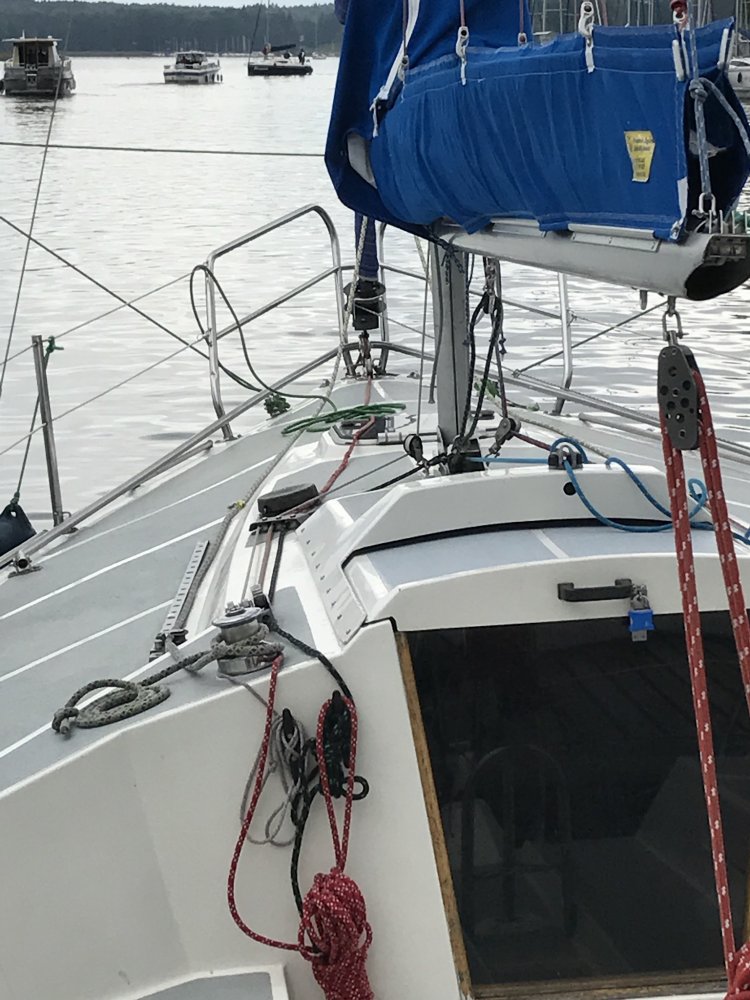

Hey all, thanks for the tips! [I switched emails so wasn't getting notified]. I did not mean to imply complete removal - this is just to lower it about 10' to clear a bridge which crosses the harbor, like so:
(in fact, the exact harbor shown) Plenty of similar boats in the harbor, and I've taken pics of dozens. Layouts are all pretty similar. Mast base gets a pivot-pin, fore of mast sawed to the rotation curve. Back shroud has a quick release (anyone know a source for slip hooks? Google-fu not working), middle shroud gets a new pivot, in-line with base of the mast (so that it remains taut as mast lowers), fore-shroud just droops, furler/jib dropped to deck and swapped w halyard. Boom is used as gin-pole, stabilized w lines to mid-beam (I think this is the weak-link honestly; due to age of components), and lowered via the backstay rigged to the boom (either manual tackle or powered winch to control the drop). I need to pull my stick anyway (mast base plywood is crushed finally) and the rest of the rigging changes are non-destructive (i.e. if I never use it, no harm, no foul). I'll have plenty of opportunity to test in calm water. To talk myself out of it, I'll crew on the local beer-can races and see how gnarly it is in practice. Other challenge is finding a rigger willing to assist. Meanwhile, I'm floating at top of the waitlist and watching Craigslist to see if a better-suited boat shows up (but I *love* my H30) -K

Thanks @jssailem- Do you have concerns with the rig upright or just while lowered? Structurally, once upright and secured I don't see any reason it would be structurally weaker than now so long as I use quality components of correct size. Probably better since I'll be replacing some elderly parts.
I think my mast is only in the 300lb range (old Kenyon I think) (plus weight of boom/main). Santa Cruz harbor is not in SF bay, but Monterey Bay - and the rig would be lowered for only about 50yards while crossing under the bridge. The harbor is wide on both sides and generally calm - main concern I would have is boat wake setting up an oscillation.
Looked at some of the existing boats again yesterday - honestly from what I see my design will be significantly more beefy than most (saw lots of turnbuckle extensions out of stamped sheet, etc)
