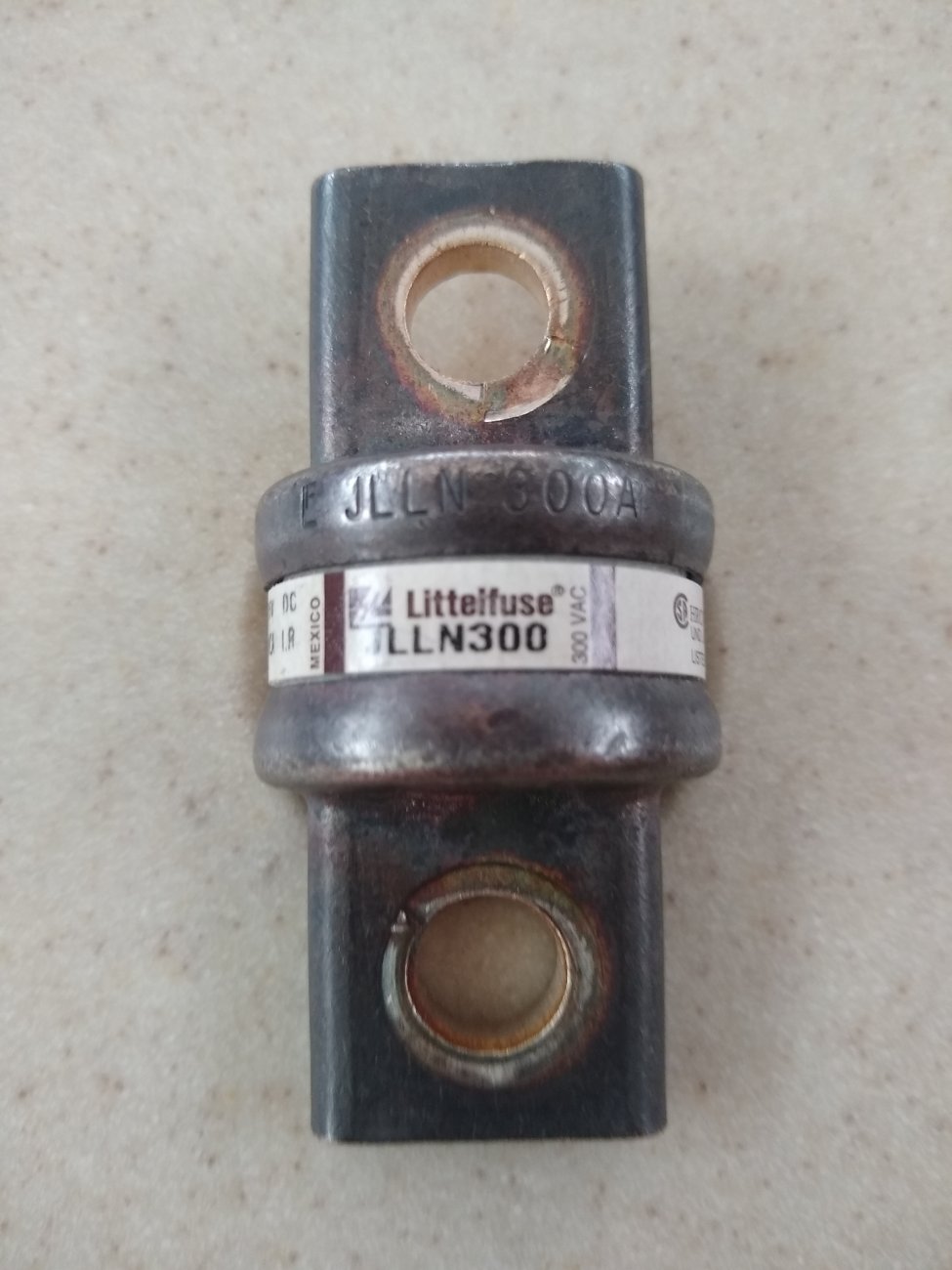

Is there any melting on the fuse holder? High resistance and heat can damage the fuse element if it gets hot enough. Hard to tell from the image if that fuse has been hot or that is just surface corrosion.

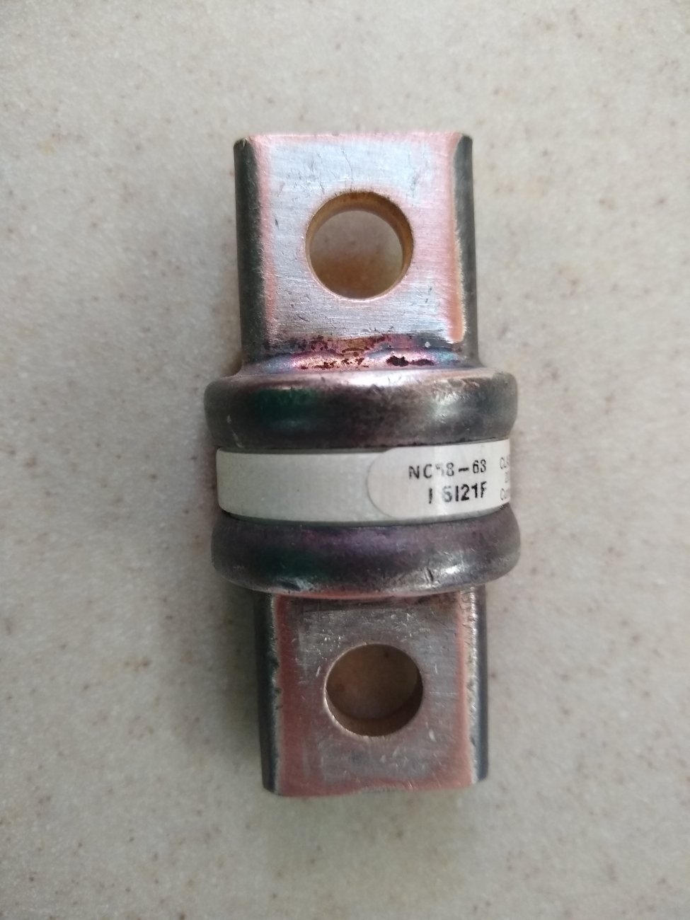

Maine Sail, after reading your reply I cleaned the old fuse with sandpaper (see photo below) and re checked continuity. Same issue as before. I checked many times and am 99.9% sure fuse is "sort of closed/open".

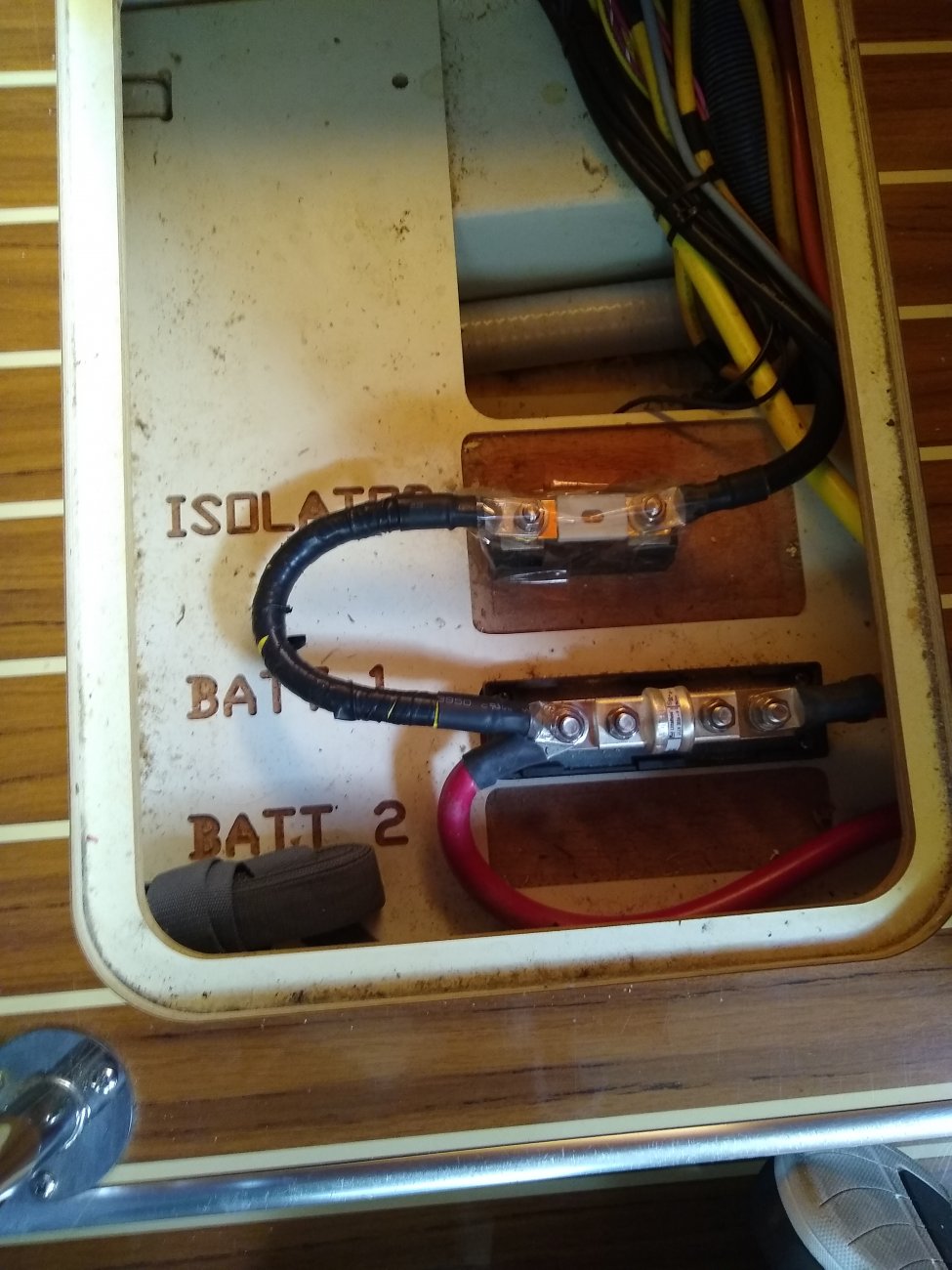

One thing to mention, this is a Hunter 41 with the standard alternator which means that there was never a connection to the house bank due to the fuse being blown. Every thing was trying to run off the inverter, hence the shaky needle. Every time the engine was started there is a Solenoid that energizes and bridges the house and start battery circuits. This gave all loads on the house side power from the start battery and made every thing seem normal, except for the thruster which didn't have enough power available from the lone low amp battery plus the stock 70A Hitachi alternator.
