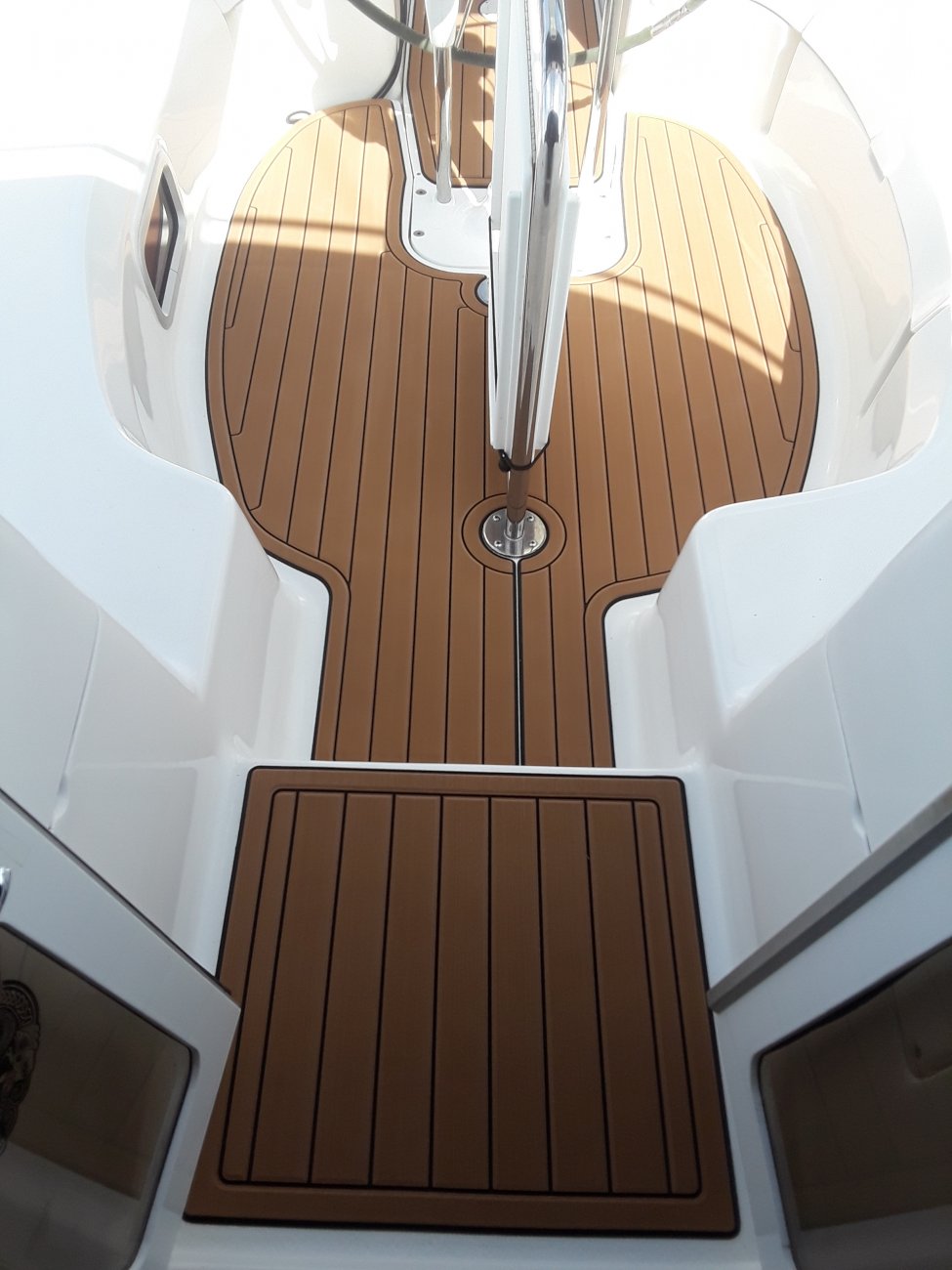

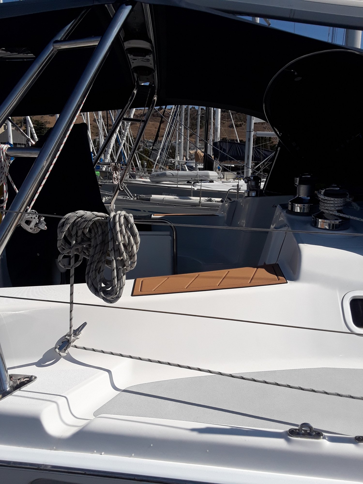

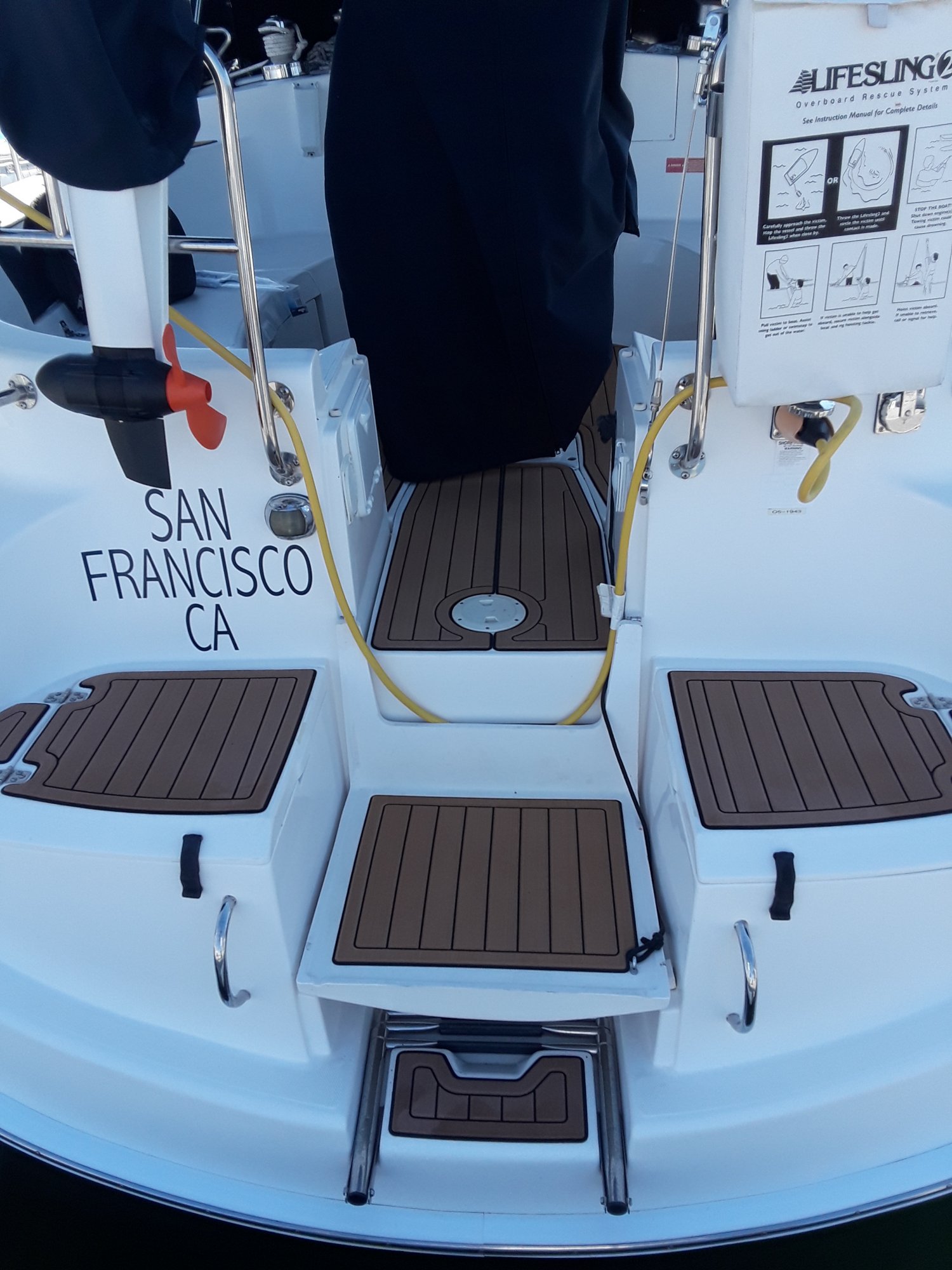

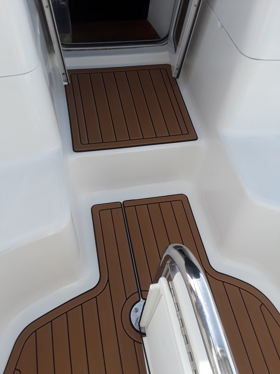

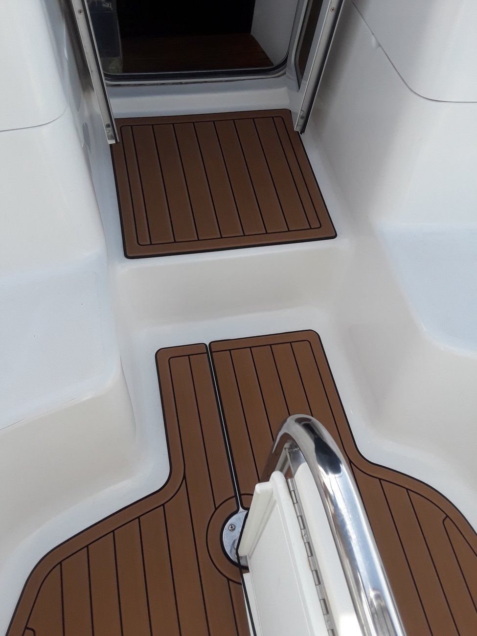

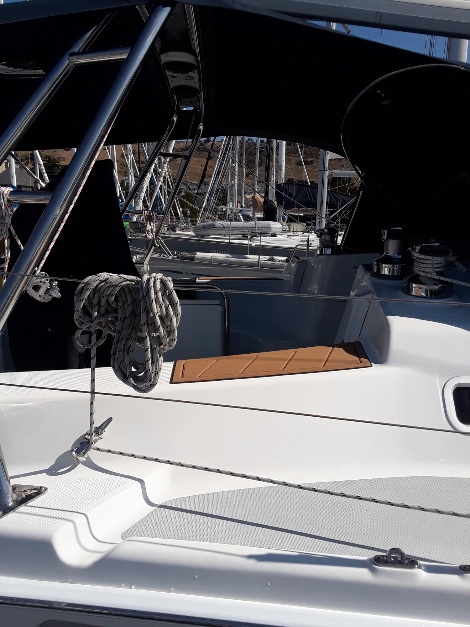

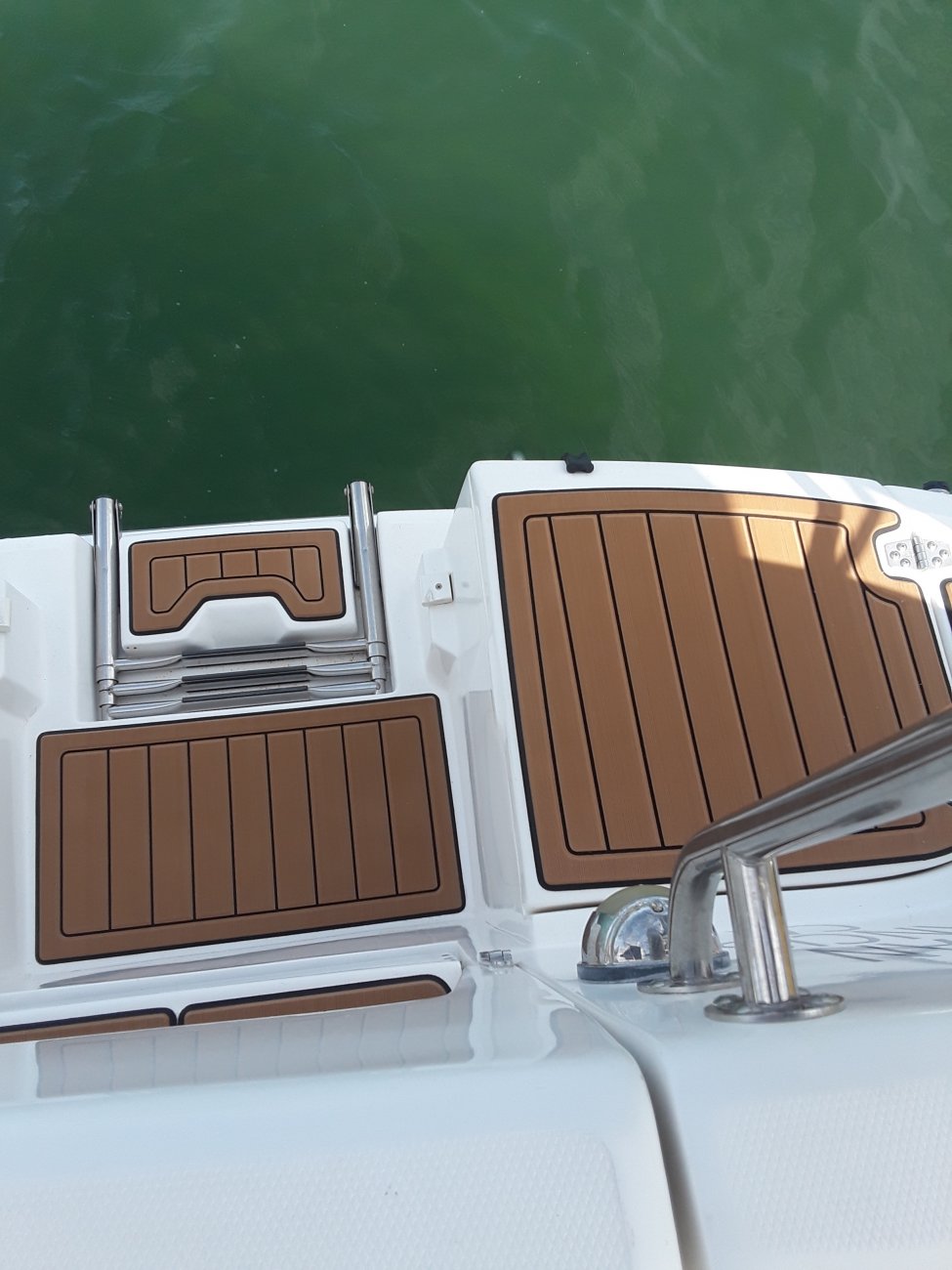

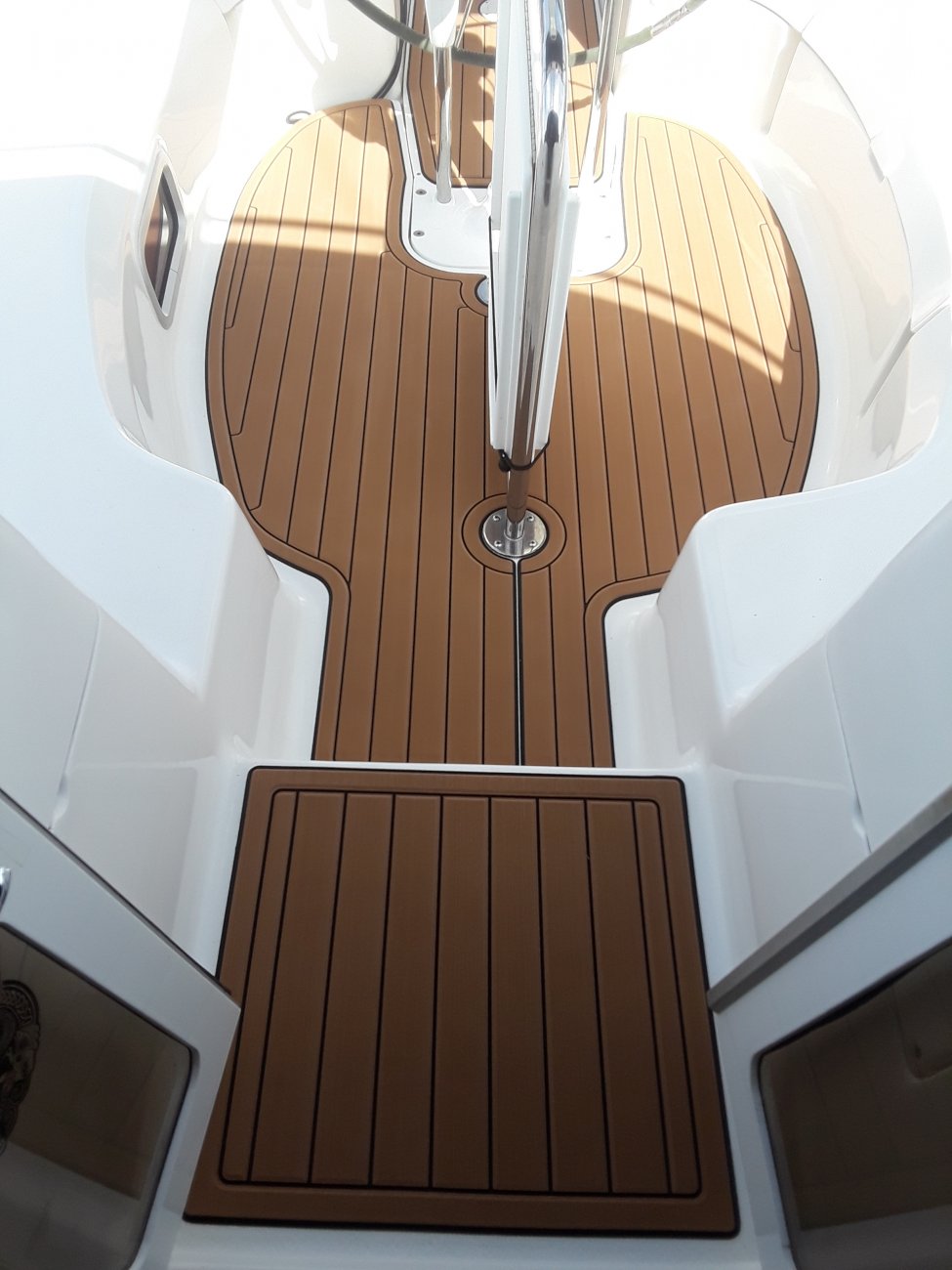

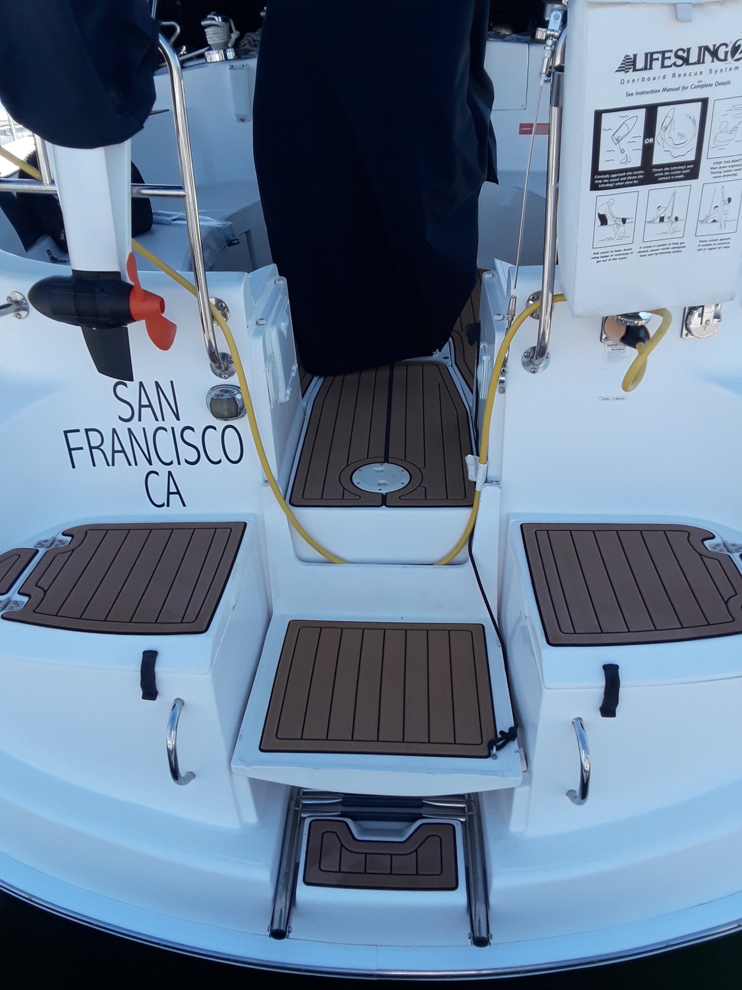

I researched the many products out there, including PlasDeck and SeaDek. I selected SeaDek based on cost and reversibility, i.e, product does not have to be glued down. I had a local certified SeaDek supplier scan my Hunter 46. Then he designed it CADD and priced up the project. To minimize scope and cost I limited SeaDek to the companionway, cockpit and stern. The photos show the finished project.

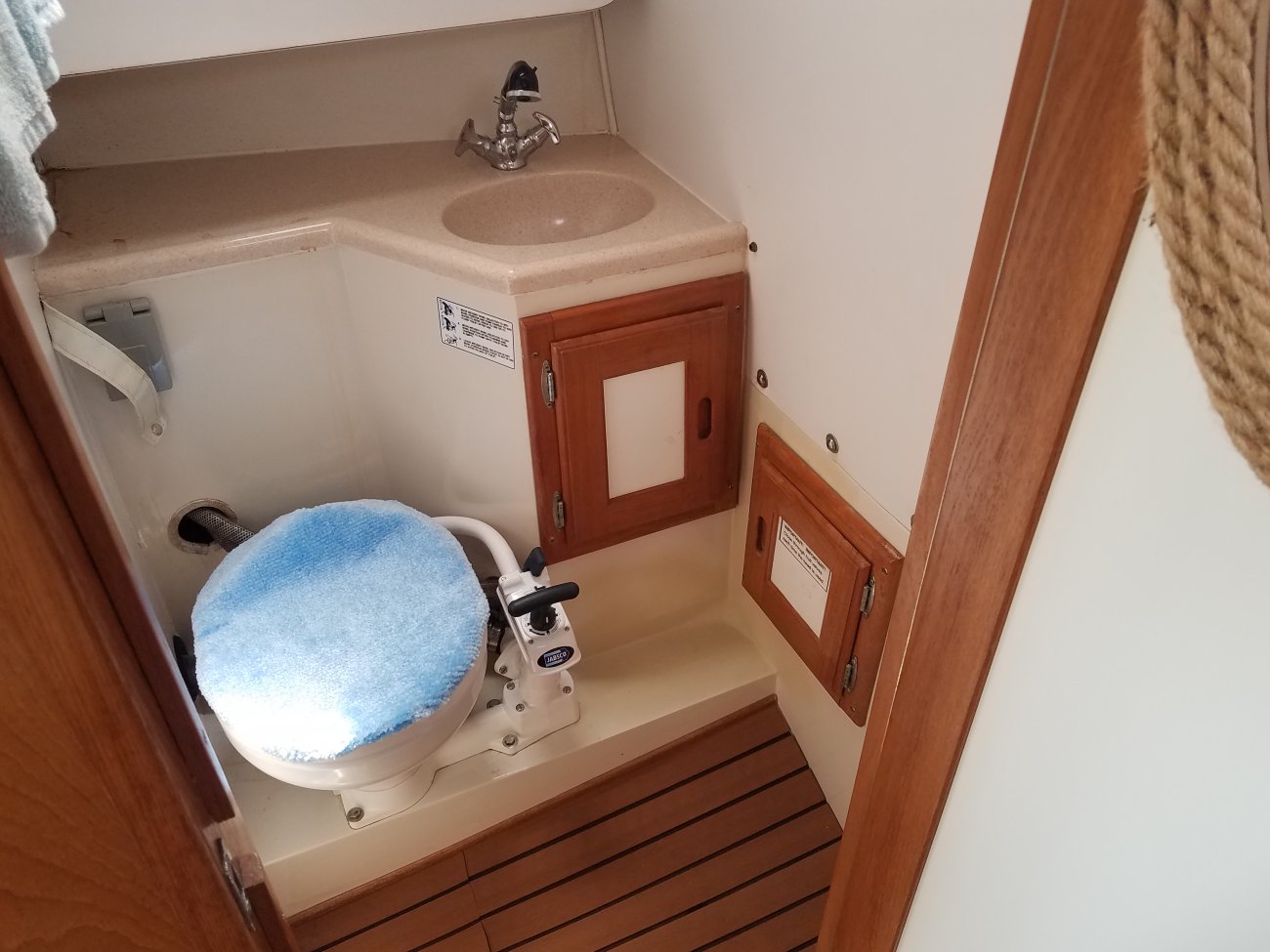

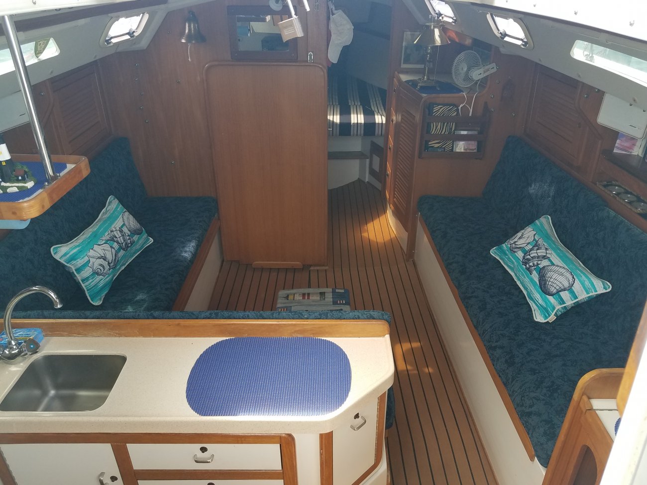

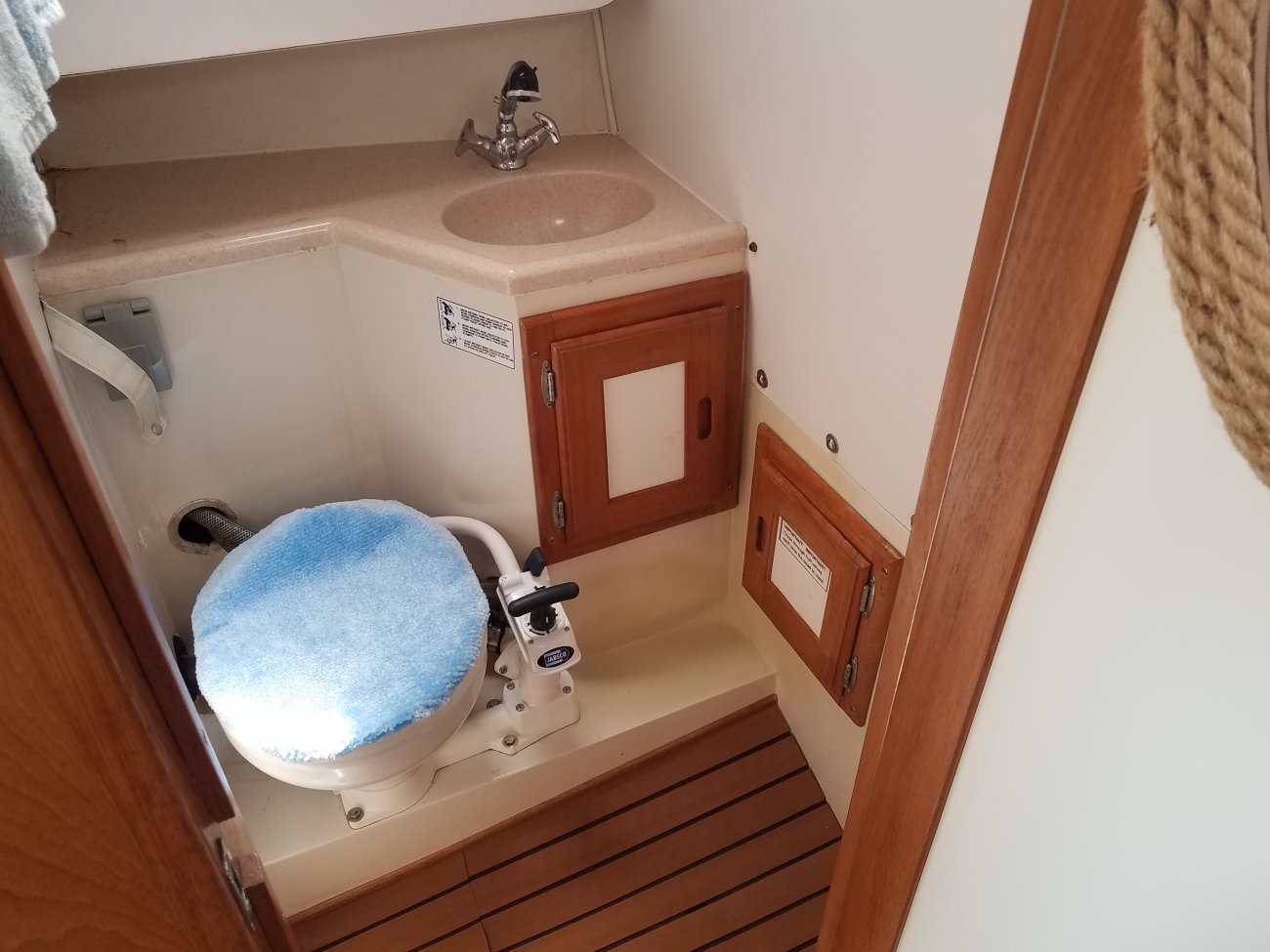

Got my eva self sticking off eBay for $50. per roll. 36"x 84". I found that laying it as a carpet installer would; without a template worked out pretty much okay. I added a matching wood color plastic cove moulding from Home Depot along forward to aft at the side edges really dressed it out. I used Gorilla glue for that. I enclosed some photos. I hope they attach. Happy Sailing.1 Center.jpg Head 3.jpg

rpell1, The EVA Fuax Teak Sheet With Adhesive For Boat Flooring looks great!! Nice work and very cost effective.

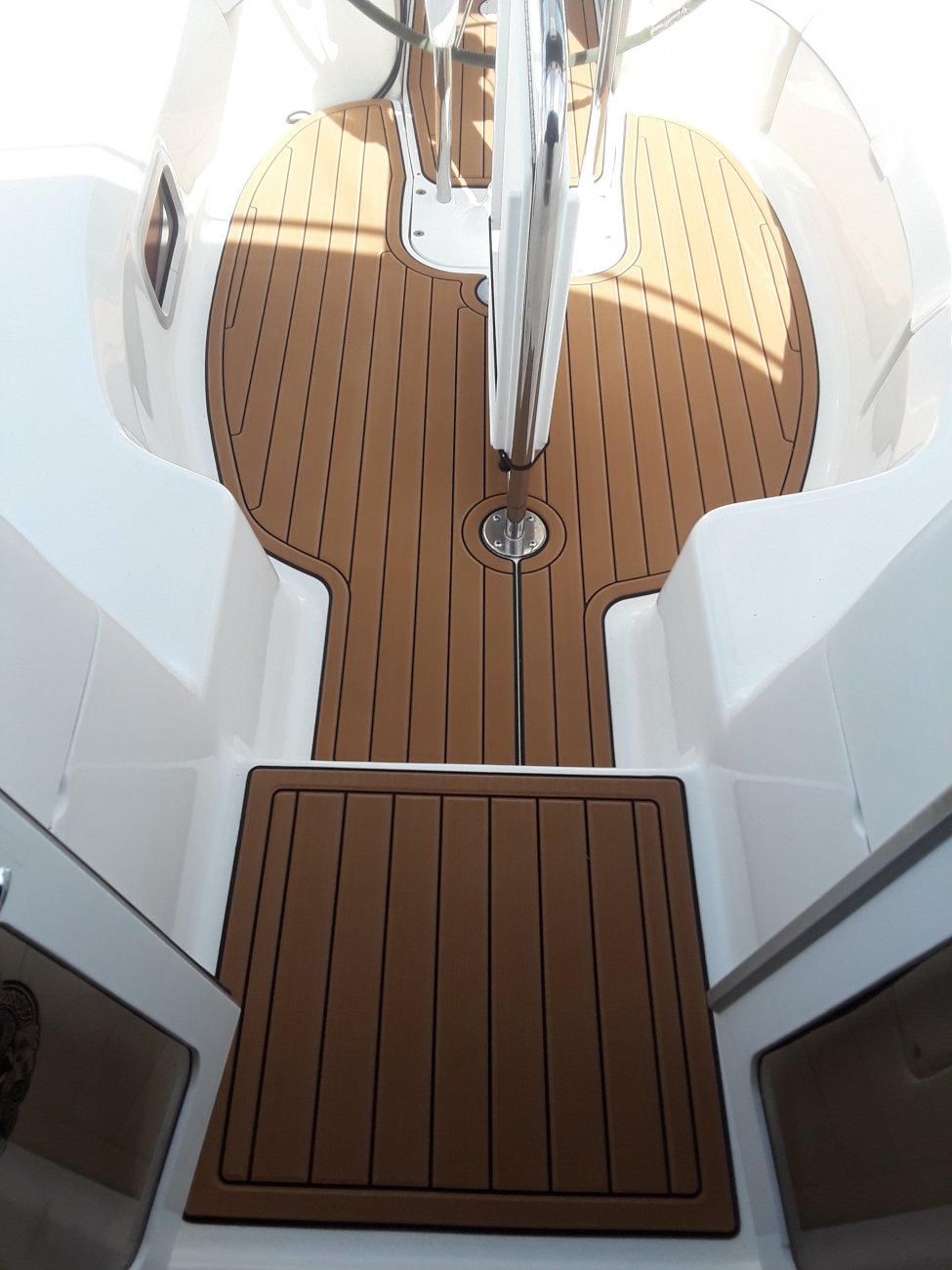

Another photo of the companionway and cockpit. Interesting to find out after the cockpit was scanned that it is not symmetrical because the companionway is offset. Side benefits are it is comfortable to walk on and easy to clean.
