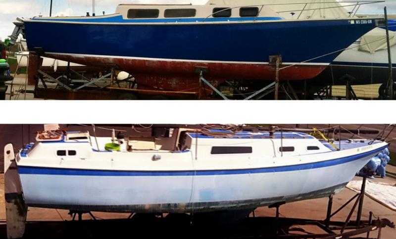

I have two 1976 32' Clipper Marine Sailboats. One is an aft cabin ketch, the other is a sloop. The sloop is the parts donation boat for the other nicer one.
The Aft Cabin model has a standard mast, while the sloop has a taller mast and a roller Furling. Taller by 2.5 feet apx.

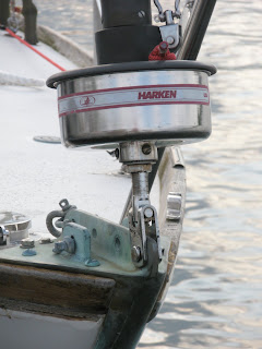

My goal is to get the R F moved to the other, nicer boat, that does not have a R F. The R F is a heavy duty Harkin, something like pictured here.
I believe all the SS rigging would transfer over switching masts, but you never know for sure till you try. They are the same model year, but slightly different in design.
Would it be easier to shorten the R F ?

Measure both rigs, then compare. Don't assume just because they are the same year and hull length that every thing else will match.
I think it would be more logical to simply shorten the foil on the RF unit to fit the lower aspect ketch rig.... You can find installation instructions for your particular RF unit on the Harken website... The instructions will show you how to adjust the length of the RF unit to fit your headstay.

Measure the headstay, Gary.. The mast on the ketch rig may be further forward (?) to keep the sail plan balanced?? As Joe said, it is relatively easy to shorten the Harken .. Shortening the headstay that the Harken is on by retaining the bottom turnbuckle and using a Norseman or other compression fitting on top is relatively easy as well.

Cutting the foil and re-terminating with a mechanical fitting is far easier and should take a couple of hours at best...

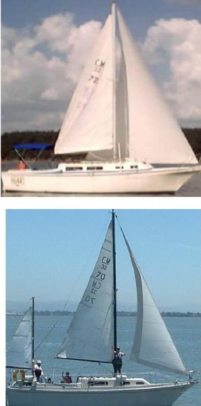

Here is the two sailboats models, google images, not exactly to scale, but pretty close.
I will put them both in the water side by side and do measurements.
I will sail them both in the same winds and see how they compare.
Then decide what gets switched.

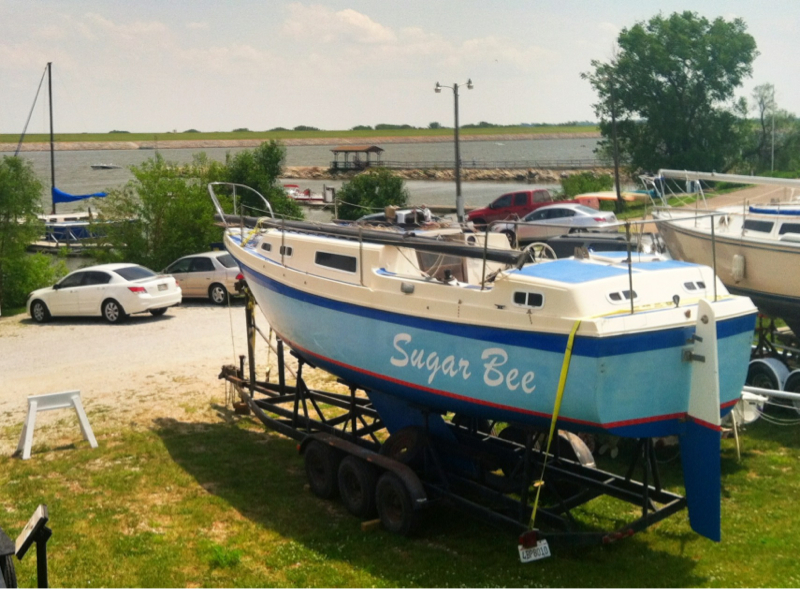

Met with Mike of http://www.selectsail.com/ today. Mike and I decided give her a season just as she is, and if I want to do minor or radical changes later, we have all winter.
She splashes Sunday, knock on wood!
Boat that is coming out of the water, is also pictured in background.
Mike is a great guy, give him a call for all your sailboat needs in Eastern Nebraska.
Mike and another guy crawled all over my two boats for an hour figuring out the best course of action.
