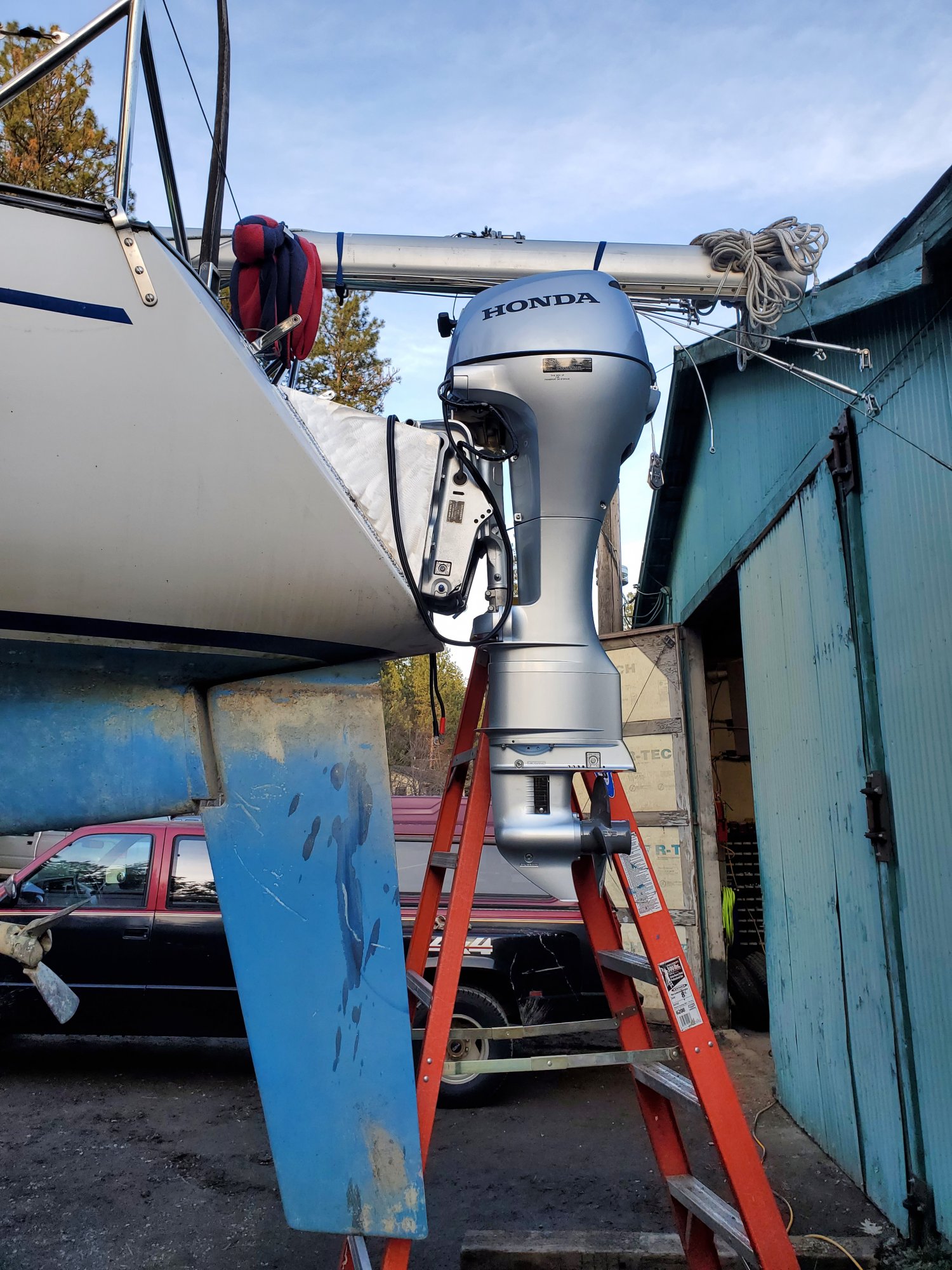

Decided to go with a Honda 10hp xl with electric start. Having a custom mount built. Am still considering a remote throttle.

Interesting. Are you going to be able to use your old integrated fuel tank to feed it?

looks great. this is the future. the inboard is dying perfect use of a reverse transom.
sailors are slow to change, they live on tradition. this is the new look.
