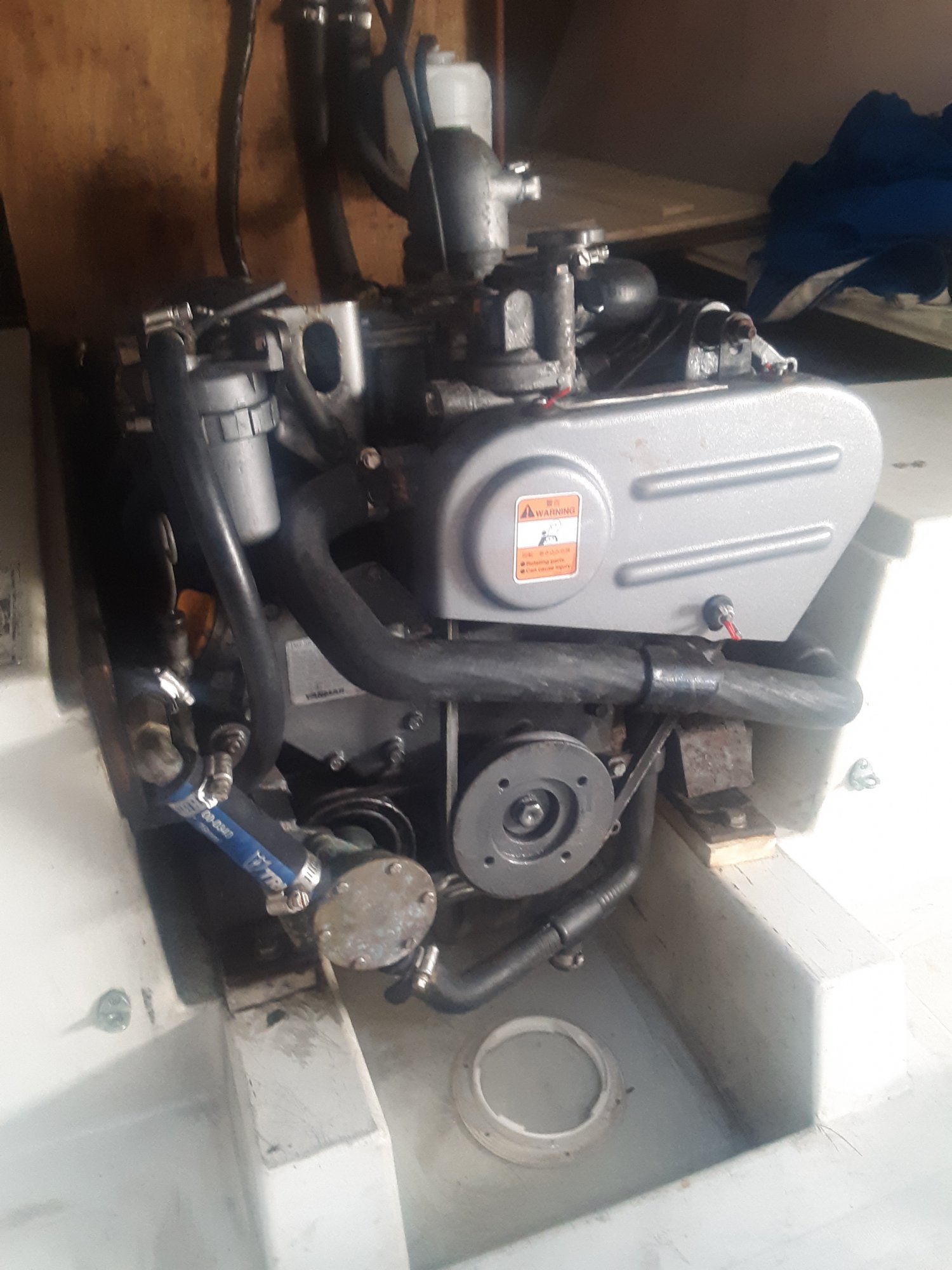

I have a 33' Aphrodite 101 after 40 years the one lung Yanmar needs to be retired. Changing it out in kind has proven to be a real hassle. A firm that rebuilds Yanmars, highly respected, talked me into going one size larger. When it arrived it was determined there was no way it was going to fit.
As anyone who has a one lunger knows they are loud and it's there job to try to beat themselves to death...
An alternative I'm considering is to just attached a 10 hp 4 stroke to the stern. While the boat was designed to sail in the North Seas we only sale it on a fresh water lake.
Does anyone have any experience with converting to an outboard?

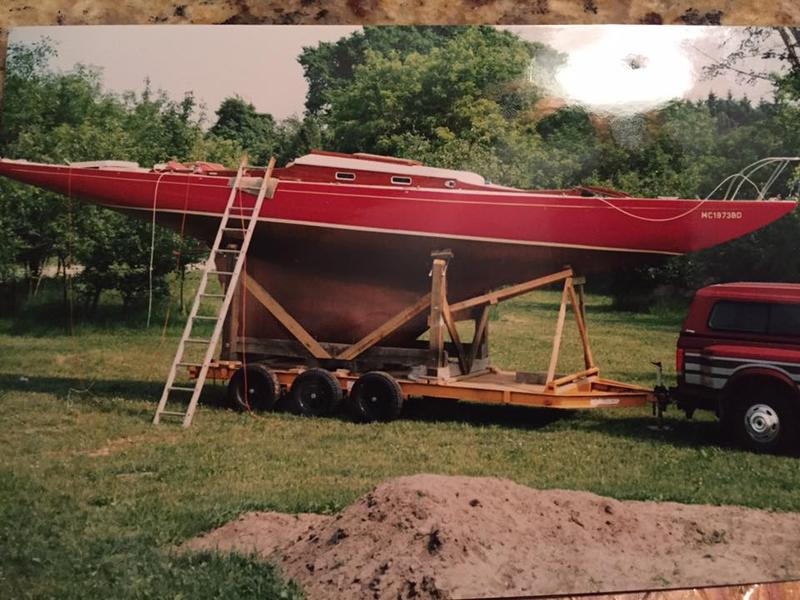

as a young pup, dad had an alden US ONE Design, 38' racer. it had an outboard well. had a 71/2hp outboard that went in the well and was pulled out and a plug was put in it while sailing.
no aux. just a pusher to get in and out of the harbor. pic is a sistership.
it's what you know. it's what you want.
