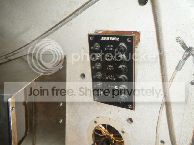

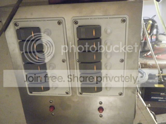

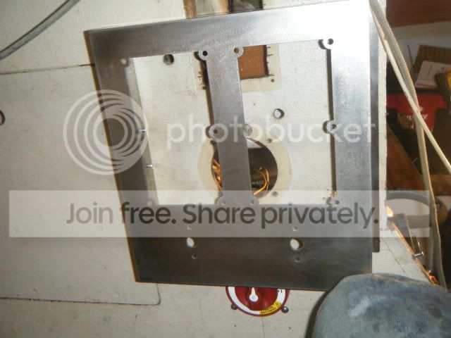

hello all
Ross - beautiful electrical panel....
this is thee electrical panel I built for my last boat ... a Mac25
sincerely
Jess

Those work! I always wondered why the manufacturers installed the electrical panels low in the cabin.
