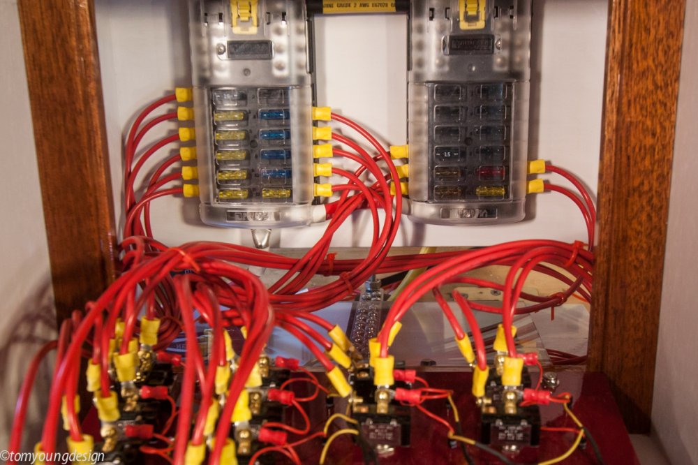

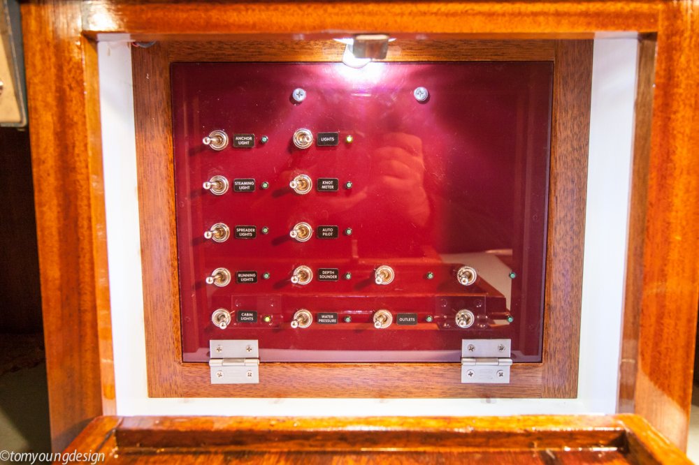

Build your own sub-switch panel? When I built mine last year, I used the Blue Seas ATC fuse blocks (2). That removes most of the wiring from the switch panel allowing a compact switch panel if space is limited.
BS fuse blocks make it easy to run a fused circuit to a switch or wire direct for fused '24 hour' circuits that are not switched.
The switch panel can be most anything and size.

That's nice, @TomY . For mine, I need a compact, horizontal strip of switches. The fuse block is already in place.
Where did you get the switches?

I used Del City as they had a wide variety of marine rated switches in various sizes and configurations. A few of my switches are STDP. Most of the rest I bought locally.
But it's easy to get switches not rated for 12VDC (from non-marine suppliers) if you're not careful. Blue Seas tech was helpful in questions I had about the LED indicator lights and wiring.
Take your time designing the actual switch panel planning space for wiring, on paper first. It was fun! I've been enjoying the results this season.
