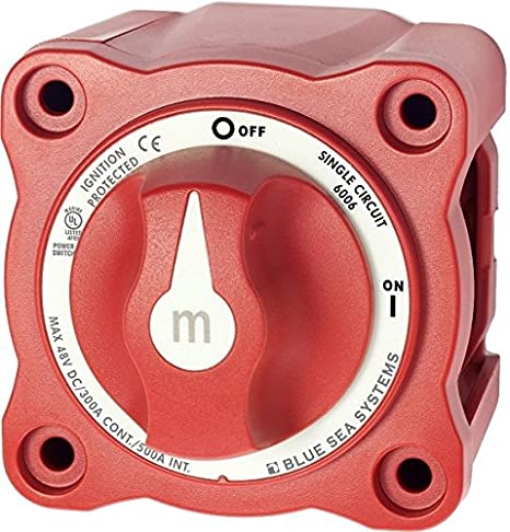

I would definitely want a master switch. Something like:

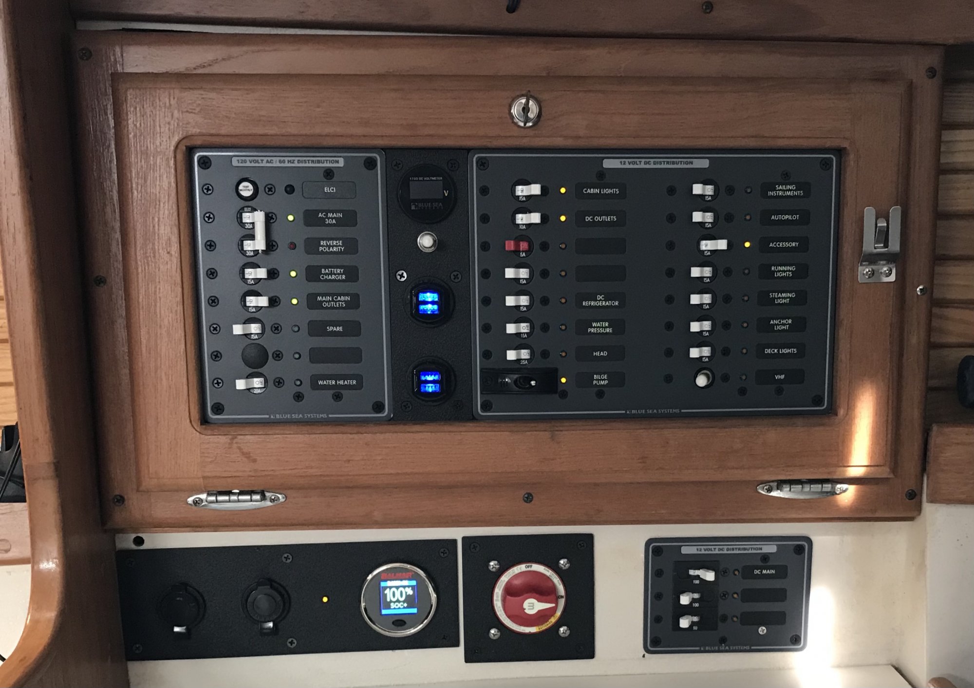

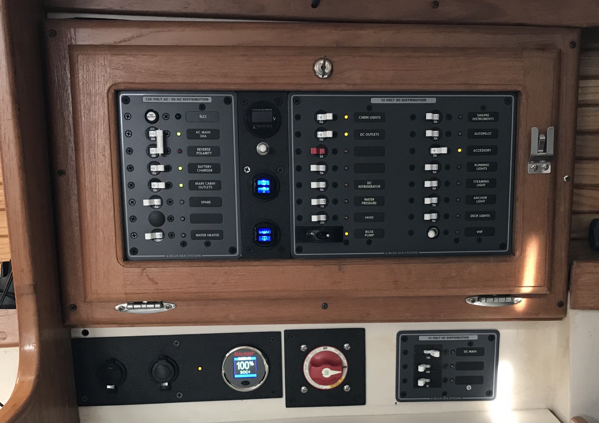

I remade the panel that houses the radios/stereo/AC breakers in my 387. Black Formica over plywood. Interestingly it's exactly what Catalina used in the first place. Lousy pic:
