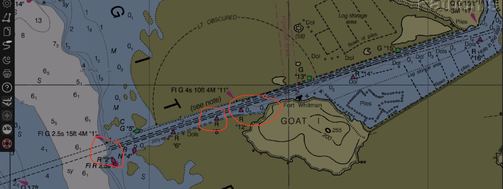

Here is the info I has helped me manage the Ditch.
First You should probable seek the higher tide feasible. I powered through on a 36' Catalina with a 6 ft draft. The owner was nervous as we approached #8 Marker and the east end of the breakwater. The depth meter as recording 12-6" of water under the keel. We crawled through at 2 knots. Never touched. Tidal level was at +1. I think you should have no problem as a +2.
The areas of concern are circled in red.
The first issue Circled in red (assuming you are coming from the north), is to stay to the north side of the channel center (use the range marker) as you approach the end of Goat Island. Not on the north edge of the channel as there are rocks around the bases of the north side markers. They are visible at minus tide and they extend out 6-10 yards from the marker piling.
Water enters the channel between the end of goat island and the start of the breakwater. There is bound to be some shoaling in that area, near the beginning of the break water on the south side. I stay north edge of center channel. The shoaling does not appear to extend more 30% from the South side.
We saw a shallowing of the water near the # 8 Red marked on the south side. Again stay closer to mid channel.
When you get to the South end of the ditch stay to the north side of the center as giver yourself room from to clear the channel before you turn south. The tidal currents here flow north and south as well as out of the ditch. The currents are carrying silt from the bays either side of the ditch. So give the end channel markers some room on both the north and south edges. Don't cut the corner!
On a high tide you should have a safe passage.

Nice post, John. Our draft is five feet, Brian. A safe transit for our boat requires a +1 foot tide state. Never had an issue at that state, so for your boat I would transit at a +3 tide state. The southern end is the thinnest part of the channel, especially around channel marker 6 and 8. Also, plan on following an ebb heading north and a flood south waiting at least an hour after flood/ebb slack before transiting. That way you get the current flow advantage, which I've seen at over 3 knots, but typically 2.5.

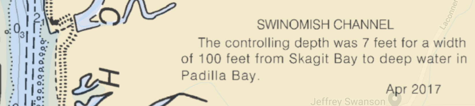

"Trying to figure out if we should attempt deception pass at slack tide or have the option of going through the swinomish channel (La Conner). Chart says the channel's controlling depth is 6.8ft for 100ft wide."
Navionics shows *12 ft* almost all the way through the south part of the channel, and notes on the chart, which are not obvious *with different zoom levels* indicate something similar to this one (grabbed off a different chart that was easier to copy). I also see other notes along the Navionics charts indicating the same thing at various spots.
So I was using 12 ft as my mllw level (on average, knowing there was silting). I'm not even sure I originally got 12 feet from anymore, it was a while ago...but...
PHEW!
23,520
It is all about the definitions : NOAA 2004
CENTERLINE CONTROLLING DEPTH. The controlling depth of a waterway which applies only to the center of the waterway; it is usually the result of a reconnaissance-type survey consisting of only a few lines of soundings which do not provide adequate coverage to determine the controlling depth of the entire waterway.​
CONTROLLING DEPTH. (1) The least depth in the approach or channel to an area, such as a port or anchorage, governing the maximum draft of vessels that can enter. (2) The least depth within the limits of a channel; it restricts the safe use of the channel to drafts of less than that depth. The centerline controlling depth of a channel applies only to the channel centerline; lesser depths may exist in the remainder of the channel. The mid-channel controlling depth of a channel is the controlling depth of only the middle half of the channel.​
DEPTH. The vertical distance from a given water level to the bottom. The charted depth is the vertical distance from the tidal datum to the bottom. The least depth in the approach or channel to an area, such as a port or anchorage, governing the maximum draft of vessels that can enter is called the controlling depth.​
