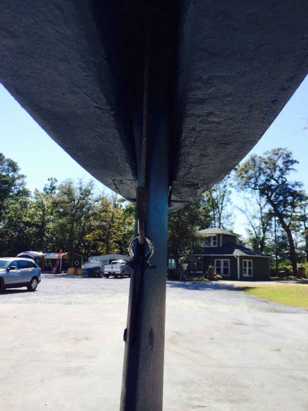

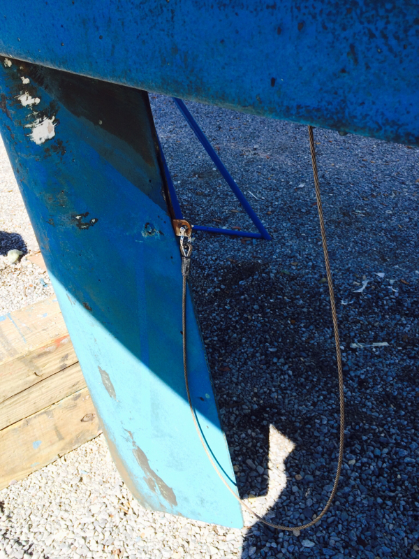

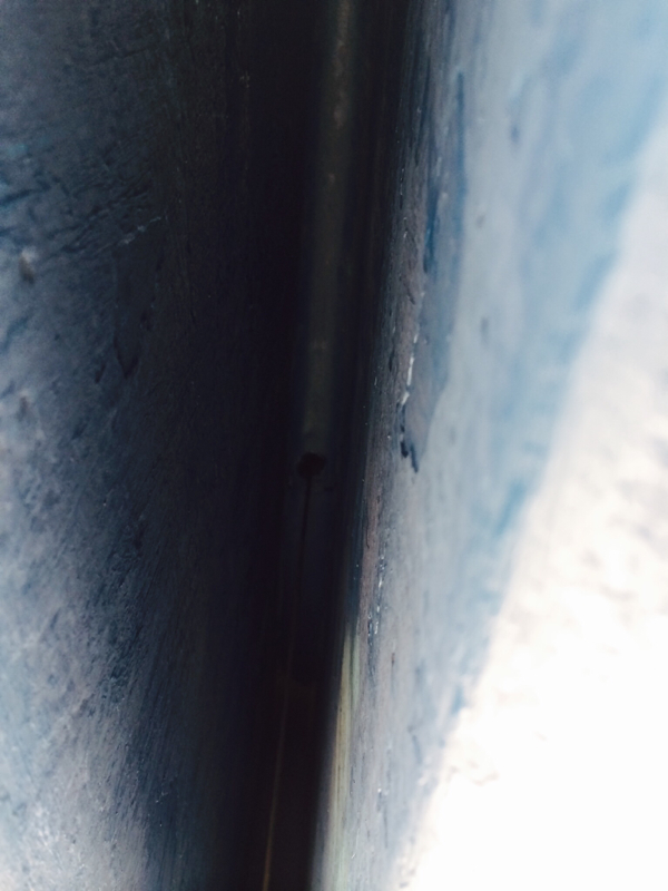

Oday 28 Niceville, FL
So I just got done replacing the cable on my 28 while I was in the yard. The previous owner had tied a peice of 5/8" double braid to the shackle. AS a result it was hard to pull up and the keel wouldn't go up all the way. I don't know how it was originally set up. But you can see the bottom end of it. The cable goes up the hole into boat and over a halyard lift block then to a cheek block on deck and down to a single block with becket. My cable runs all the way to the block and the swedge stops at the cheek block.
