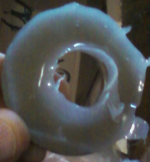

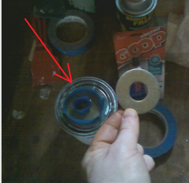

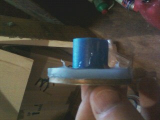

BUT!... with your pivot pin glassed over, you cannot easily inspect it. I've owned 6 different swing keel boats (and restored 5 of them) so I've done a lot of work on keels. What I have seen is the pivot pin gasket has failed and instead of removing the pin and replacing the gasket, the PO glasses over the head of the pin. It is the lazy way to keep the boat dry but it also just kicks the can down the road.
The pivot pin has a ss washer that butts up against the keel trunk. The ss-washer should have a rubber washer between the trunk and the ss-washer. This provides the water seal.

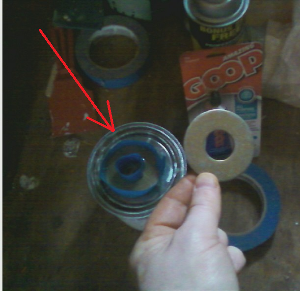

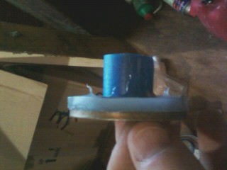

You can buy rubber washers from McMaster-Carr but they sometimes come in packs of 50+... you can also make one out of goop... like this one I made
First make a dam out of masking tape on both the inside hole and the outside of the washer... then fill it in with a layer of goop and let it set up over a 48 hour period... then you are good to go...
View attachment 220107View attachment 220108

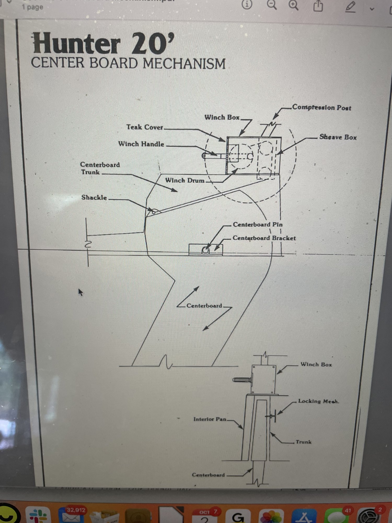

@Ryan61065
Attached is the diagram for your 1983 swing keel which should be helpful compliments from Al Fooks, owner of Sailboatowners.com.
May I suggest posting your inquiry for this boat under small boats under Hunterowners.com. I use to be a dealer

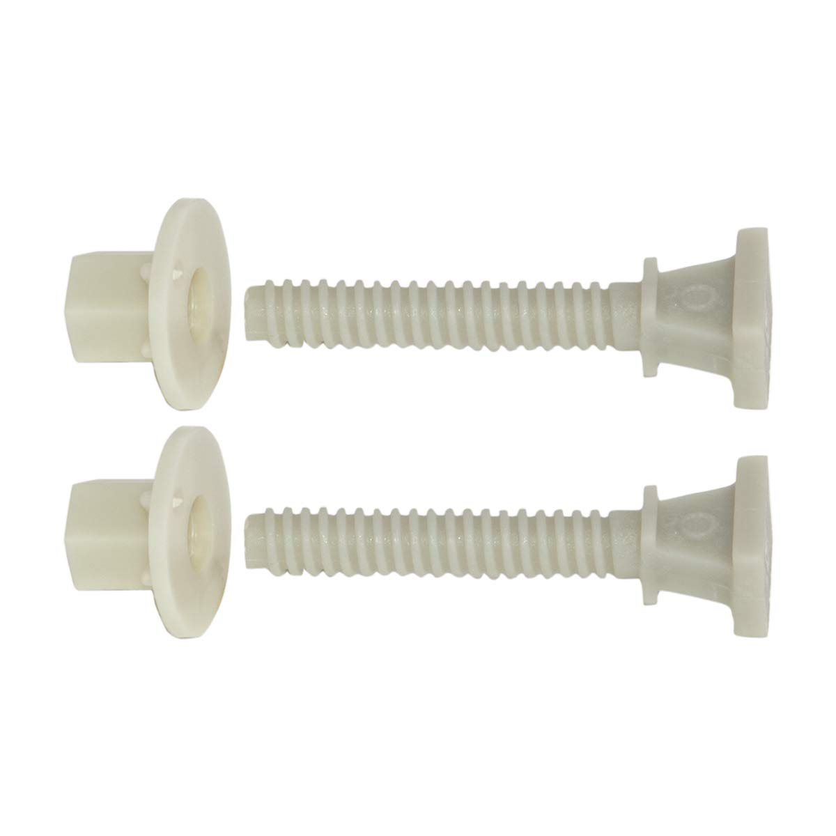

Well unless you are going to be someplace with breaking waves, your boat won't turtle and you will never need to lock down your keel... but if you are going to blue water your H20, and want to lock down the keel... I'd use nylon toilt bolts like this...
They will shear if you strike something hard.
  • Helpful
Likes: LloydB
10,536
-na -NA Anywhere USA
@rgranger
Good morning. Never heard back on the hunter 19
On the bolts you suggested have threads on them which I have seen waller out the holes in fiberglass and cast iron too. In addition, if it too wavy, too much wind, etc., I would caution the use of smaller sailboats out in blue water. I had to repair an older h 20 centerboard before I knew you when the owner went out at the coast in rough weather
