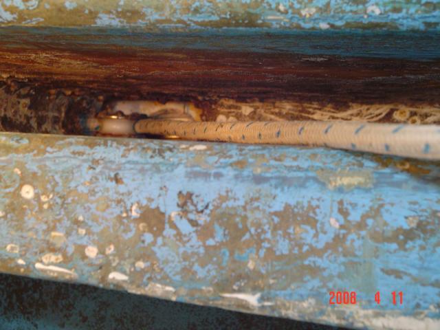

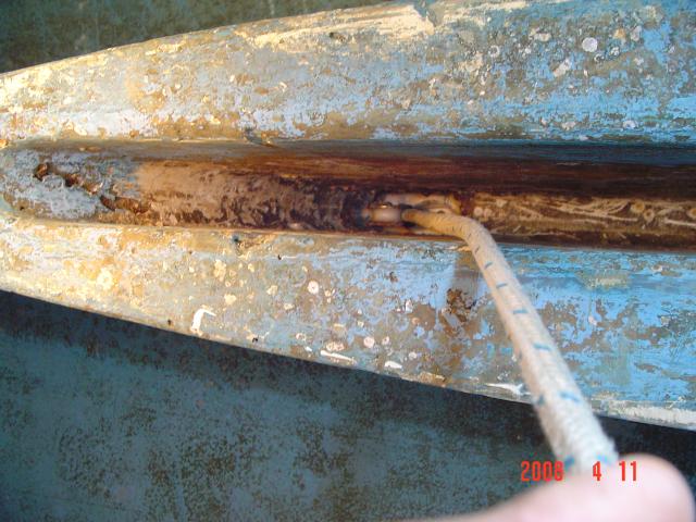

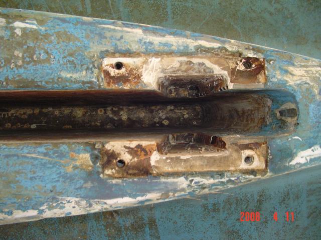

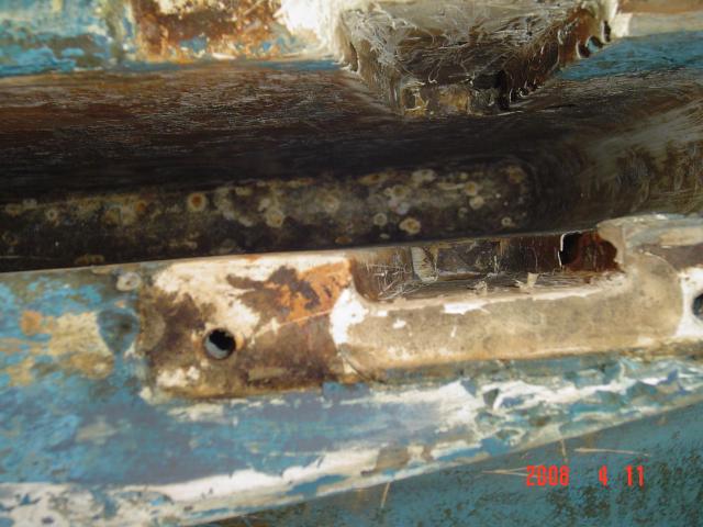

I've posted many pictures of my keel slot and centerboard and I have no idea where they put them. However, I just posted some of them in "My Picture Album" on page 2.
Chances are there's mud and pebbles all jammed up inside the slot between the centerboard. I have a lot of pictures of it. Here's a few. Don't try to poke anything from up above. You're better off getting it cleaned from under the keel. The keel slot is no deeper than about 14". I'd use something thin and flat to put in there to clean it out. If you're not too keen on swimming under the keel, and who would be? You could let the pendant line slack off about two feet and re-tie it. Then take the boat out into some turbulent waters. That's got to be a joke right? The bay right now is probably as calm as a mill pond which was the prime reason why I pulled my boat out two weeks ago. Anyway, maybe the mud and crap will fall out of the slot enough for the weight of the board to fall. When you see the pendant line tight with no slack, just work it up and down a few times and it will clean it out. I've had this happen on my boat a couple of times and it's always cleared itself in time. It's like an anchor when you pull it up and it's full of mud on the flukes. You bob it a few times and it all washes off. Good Luck with that James!

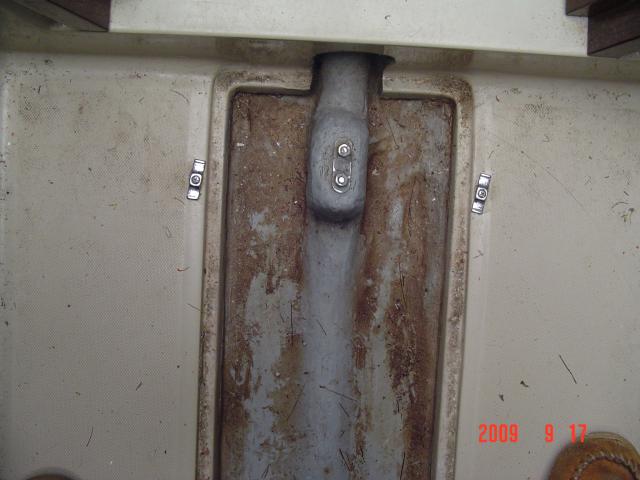

James!

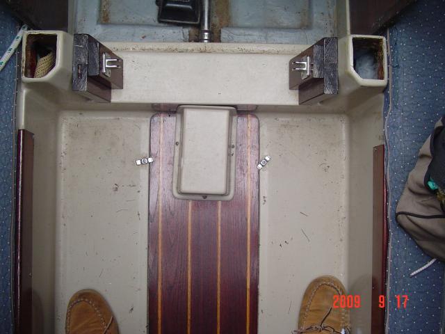

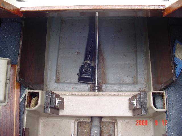

Here's a picture of the centerboard pendant line pipe in the cabin of my 222. The pipe leads into a hump on the sole which has a small backup plate, for the two nuts and bolts that hold the sheave in place inside the keel slot. As you can see, the hump on mine is all Fiberglassed over from the factory and would be very difficult to get at the sheave if it were to ever get damaged. Ed K. said that he was able to remove the sheave and reinstall it from under the keel with some kind of a long tool, but it must be real tricky to line up. Do you have something similar to this in your boat? I'm just curious. In case you're wondering, I have a detachable step inside my cabin that makes it easier to get my 50 qt cooler in the area behind the step.
Joe

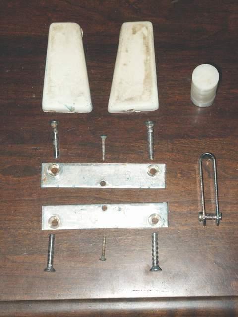

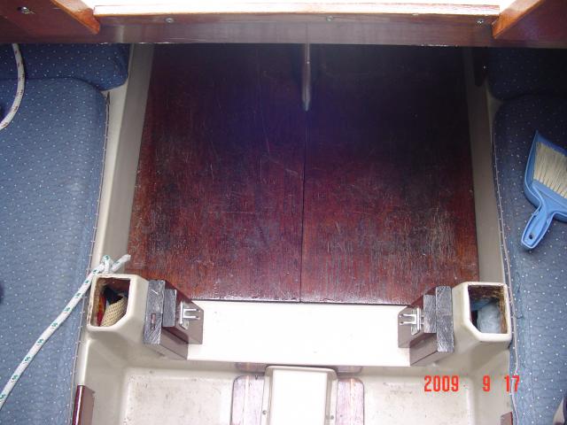

Hi James,
It's possible that you may not have that sheave up inside the centerboard slot in your boat's keel. The only way to really find out is to look up in there with a flash light, I guess. That detachable step inside my boat is a mod that I made a number of years ago using Teak and marine adjusters.
Taking a boat off a bunk trailer is a slow hard process, and it can be dangerous. I try to take every precausion when I do it. One of our YC members uses the farm's backhoe to lift the bow of his O'Day 25 after he raises the stern high enough to clear the trailer. He shores up under the stern with wood blocks and uses the boat stands to keep the boat steady and straight. I think he has a special pit under the keel that he uses to let the board all the way down into. One of our other YC members told me that he used a metal eye beam to get the bow of his OD 25 high enough to clear the trailer. He told me that it was a little scary, but he managed to get his trailer under the boat. There's a guy in your area of the Providence River who built a beam out of 2X6s, lags, and Gorilla Glue. He used it to hold the bow of his 1973 O'Day 23 in order to get the trailer out from under it. He goes under the name of Bay Sailor Bill. He's retired and reconditions boats for a hobby. Anyway, I'm glad that I was able to help you in some way. Enjoy the rest of the season. As for me, I'll still be out on the water with Penny in my kayak on mild days.
