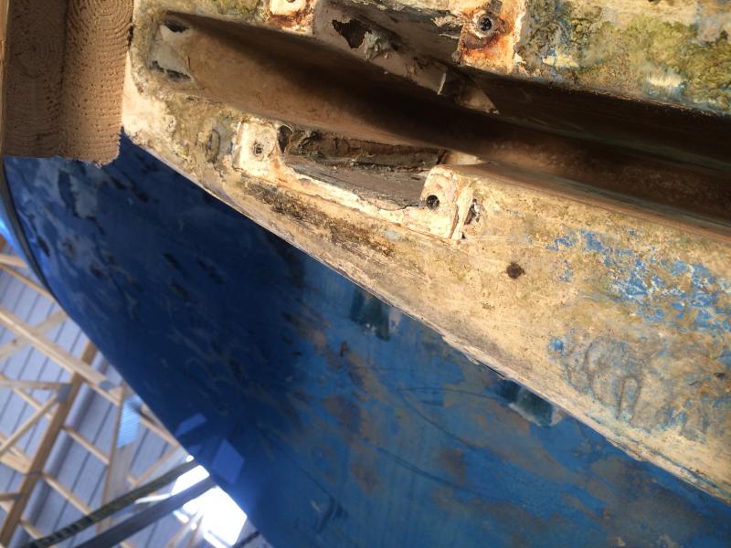

Thanks for the 3M 5200 sealant remover idea. that should work and I will look up the procedure on the precision site.
Jun 2, 2004
1,955
Oday Day Sailer Wareham, MA
What sheaves below the pivot pin?? There aren't any sheaves there, at least not in the stock setup and I really can't see any purpose for sheaves there. The pivot pin is held in by 2 fiberglass wedges that are in turn held in by a pair of stainless-steel plates held on by 3 screws each. There may be silicone sealant on those screws and under the plates, bu silicone sealant should be easy to pry apart. DO NOT USE 3M 5200 or ANY OTHER Polyurethane sealant for anything htat you might want to remove someday!! It is almost permanant and will most likey damage the fiberglass as yo utry to remove the plates, the seacret to avoid that damage if a previous owner used 5200 is one of the un-bonding chemicals sold for this purpose.
3M 5200 is often used by boat builders to bond the hull and deck together, it is that strong.

Are you sure it's silicone? The Precision keel/centerboard boats use 3M 5200 polyurethane adhesive to attach their CB pivot assemblies inside the trunk. Precision has a procedure on its web site for using solvent to loosen the adhesive if the assembly has to be replaced. West Marine sells solvents for both materials. Googling "3M 5200 solvent" turned up many discussion threads on various boating forums.
I got it out with a water based 5200 seal breaker

Thanks for everyones help. I ordered a 5200 seal breaker and used a heat gun large knife and a strong putty knife. It did not take long. Note that the centerboard is cracked in Half!
