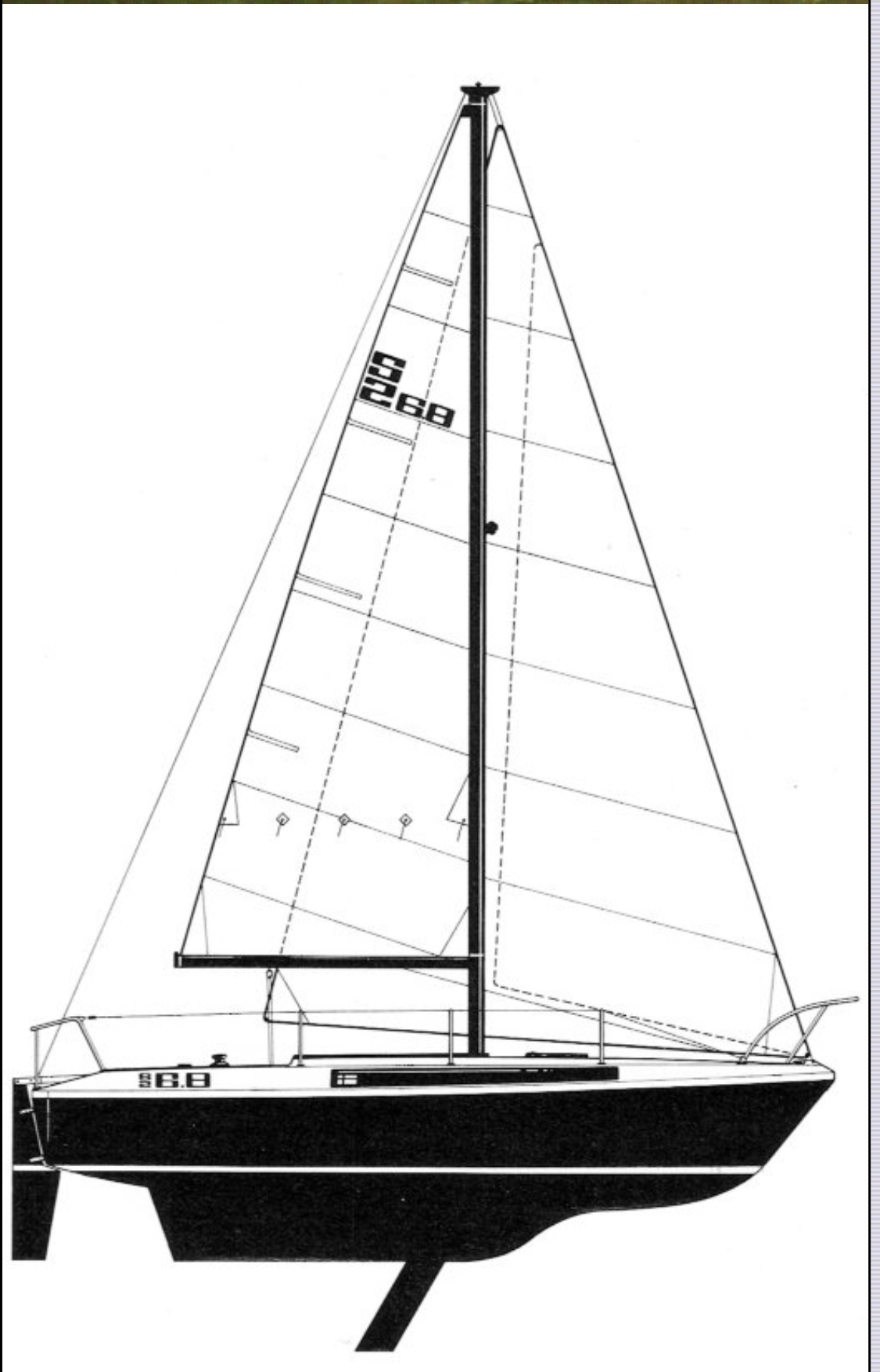

On my 6.8m S2 I have a shoal draft keel(2ft) and a swing keel/centerboard that extends 2.5ft below fixed keel. I have not been able to notice a performance difference with the swing keel retracted or extended. So, I don't use it much. When should I notice the greatest effect of having it extended?
