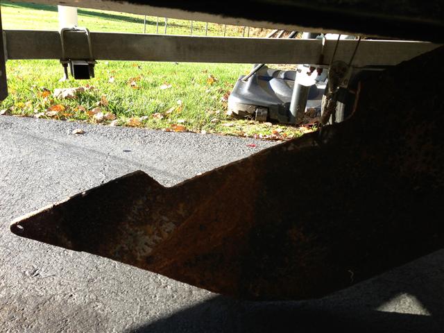

He e-mailed me last night to say the front end of the keel dropped down while he was towing it home. He asked some quesitons about how it should work, be attached and how it could have dropped. Also asked if I sailed it this way.
I think it would have been impossible to raise up and down with the lifting line if it was like this while in the water and I did raise and lower it while showing it to a few people.
The marina has a very good reputation and I think if they spotted this, which they would have had to if the keel dropped while in the water, they would have said something.
The buyer says the hinge bolt appears to be intack in the keel trunk but he has not removed the bolt yet.
I checked the bolt in May by supporting the keel, taking out the bolt and putting it back. It showed no wear. I sailed the boat many times since then, raising and lowering the keel as needed.
The only thing I can think of is that while in the salt water the SS bolt and iron keel had a disimilar metal reaction allowing the bolt to wear almost to breaking. Then he hit a bump and the bolt broke.
What do you guys think?
