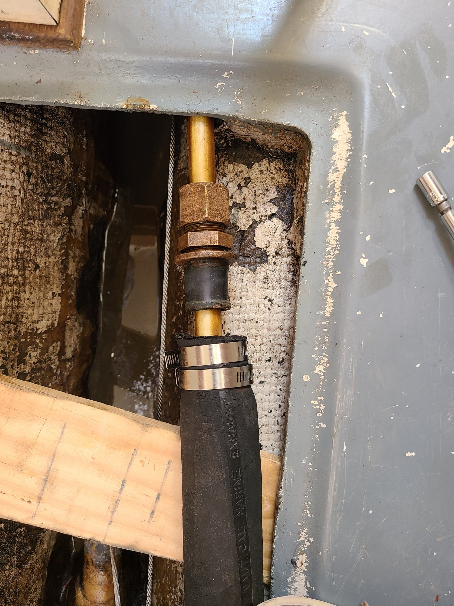

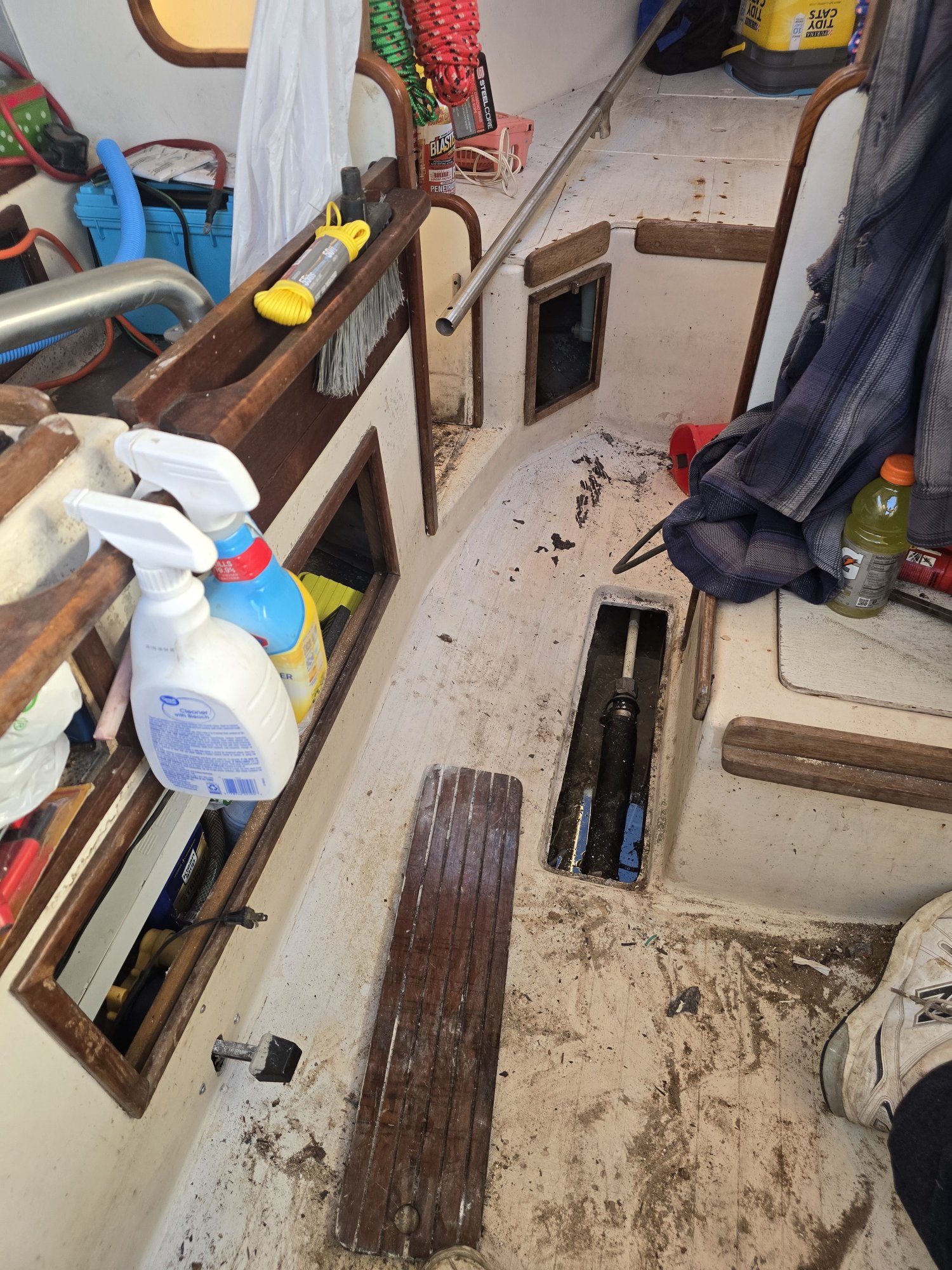

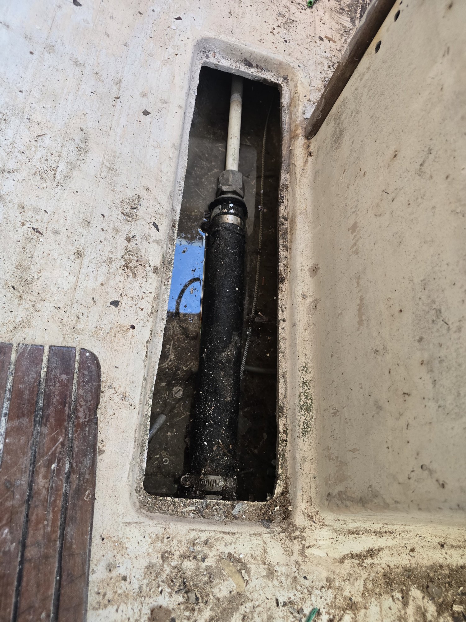

Is the stuffing box on these normally sealed with packing or is there a compression nut type of thing in them? I opened it up and don't see any packing but she is a new to me boat that I have never seen in the water. Trying to reduce the chances of a leak when we do finally get her launched.
Attached are a couple of pictures of the stuffing box in various states of disassembly.

The (nuts) should unscrew.
There should be some packing material inside one of the bigger nuts deep lnside the cavity.
Depending on the state of the material, you might be able to add another wrap of packing.
Many UTube videos available to learn more

I agree with @ggrizzard, there should be packing material (usually about 3 rings) inside the large packing nut. A sharp pick of some sort (I used a thin nail with the end bent over a bit) should help get any material out. You should be able to feel “metal on metal” with your pick if all the packing is out.
The other thing I see in your photo (although I am not familiar with your boat) is that the hose that connects the stuffing box to the boat hull (stern tube) does not look like it is connected. Maybe you took it off, but just want to be sure I mention it. Those 2 hose clamps should be on the hose over the end of the bronze stuffing box.

thanks ggrizard and Greg. I will have to dig into the larger nut more and see what I can find in there.
Greg, yes, I disconnected the hose so I could get to the stuffing box, otherwise it is under the cabin sole.

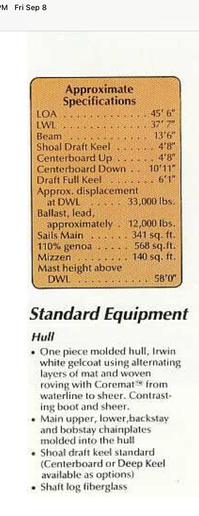

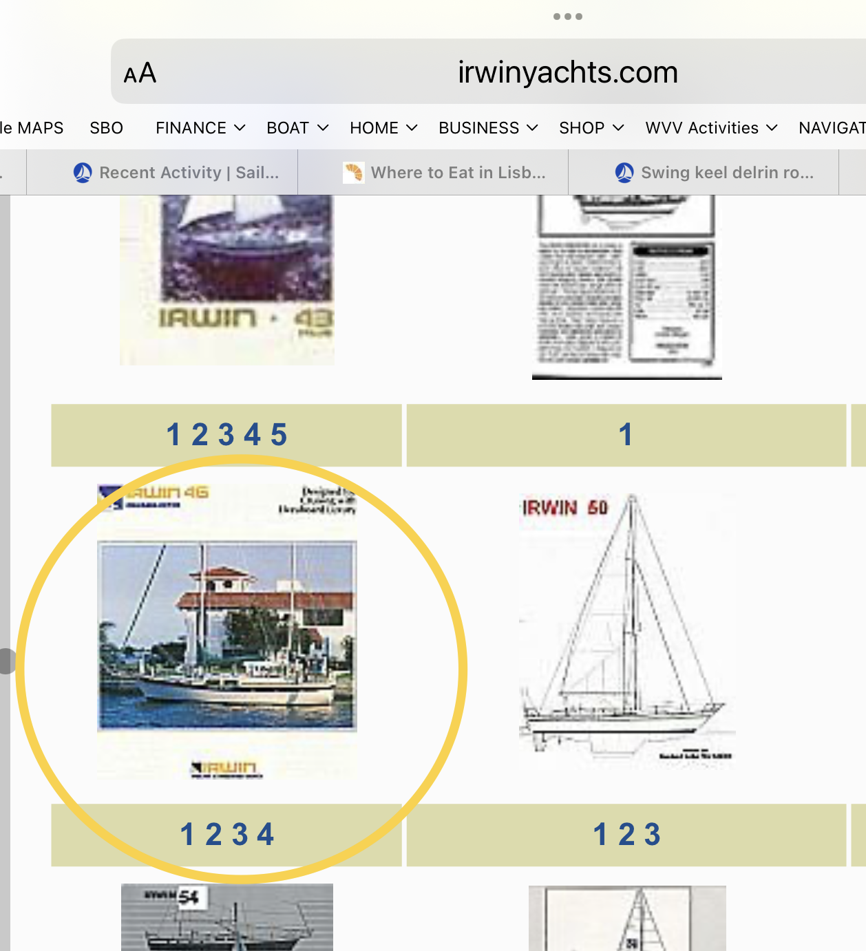

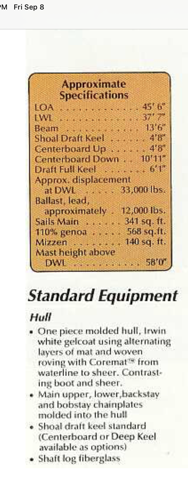

1694219881074.png This is an image from a brochure on your 46ft Ketch. It says that Irwin made this boat in a couple of variants.
Here is the source site. Irwin Yachts - Center Cockpit Models
Your boat, I believe is the one to left of the Irwin 50 on the page.

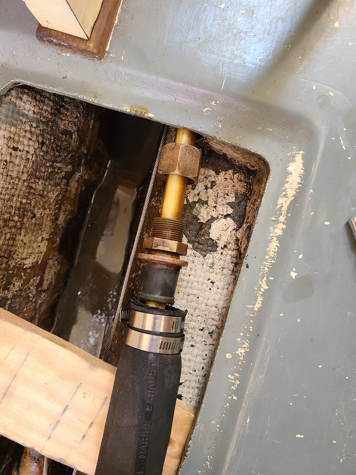

Sep 28, 2025
18

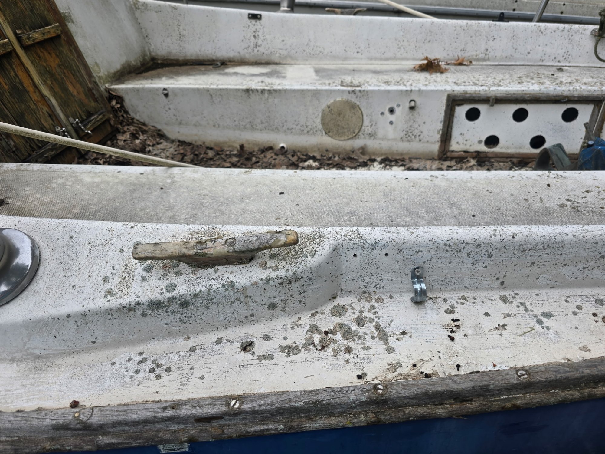

Irwin 23ft Tamaroa

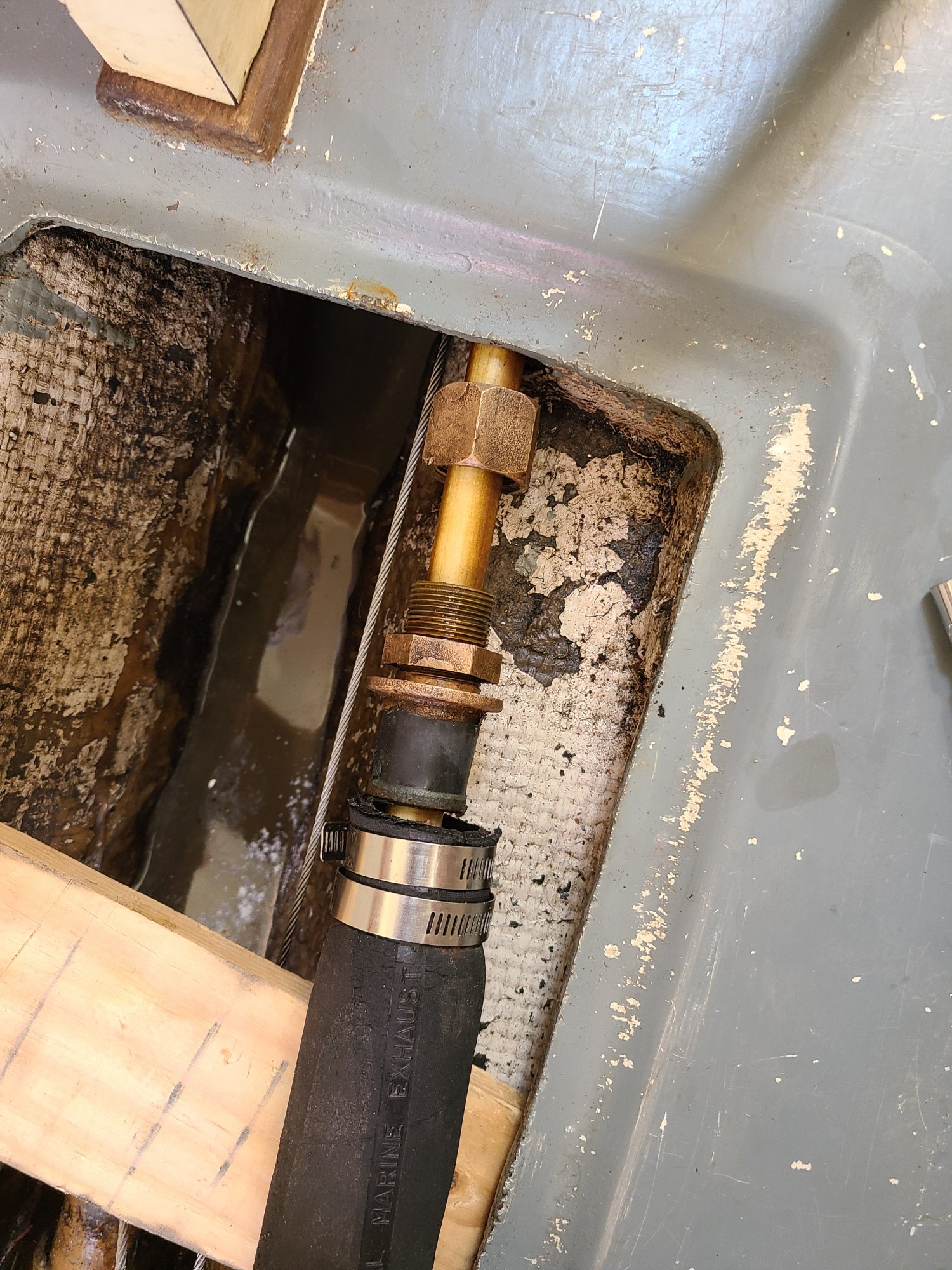

is this what I have? Trying to identify what I have. Thanks
24,454
Hello @termitec4 and welcome to the SBO forum.
Yes you have a stuffing box. It is made up of two nuts with packing inside. Flax is a common material.
The black hose is called a “shaft log hose”.
You will unscrew the two nuts. They will slide apart. You remove the stuffing and replace with fresh. If you do it while the boat is in the water, water will start spilling out into the bilge. If you have a good bilge pump, the water will cause you concern but the pump will keep you afloat.
The first time you play with this project it is recommended you do it when the boat is out of the water.

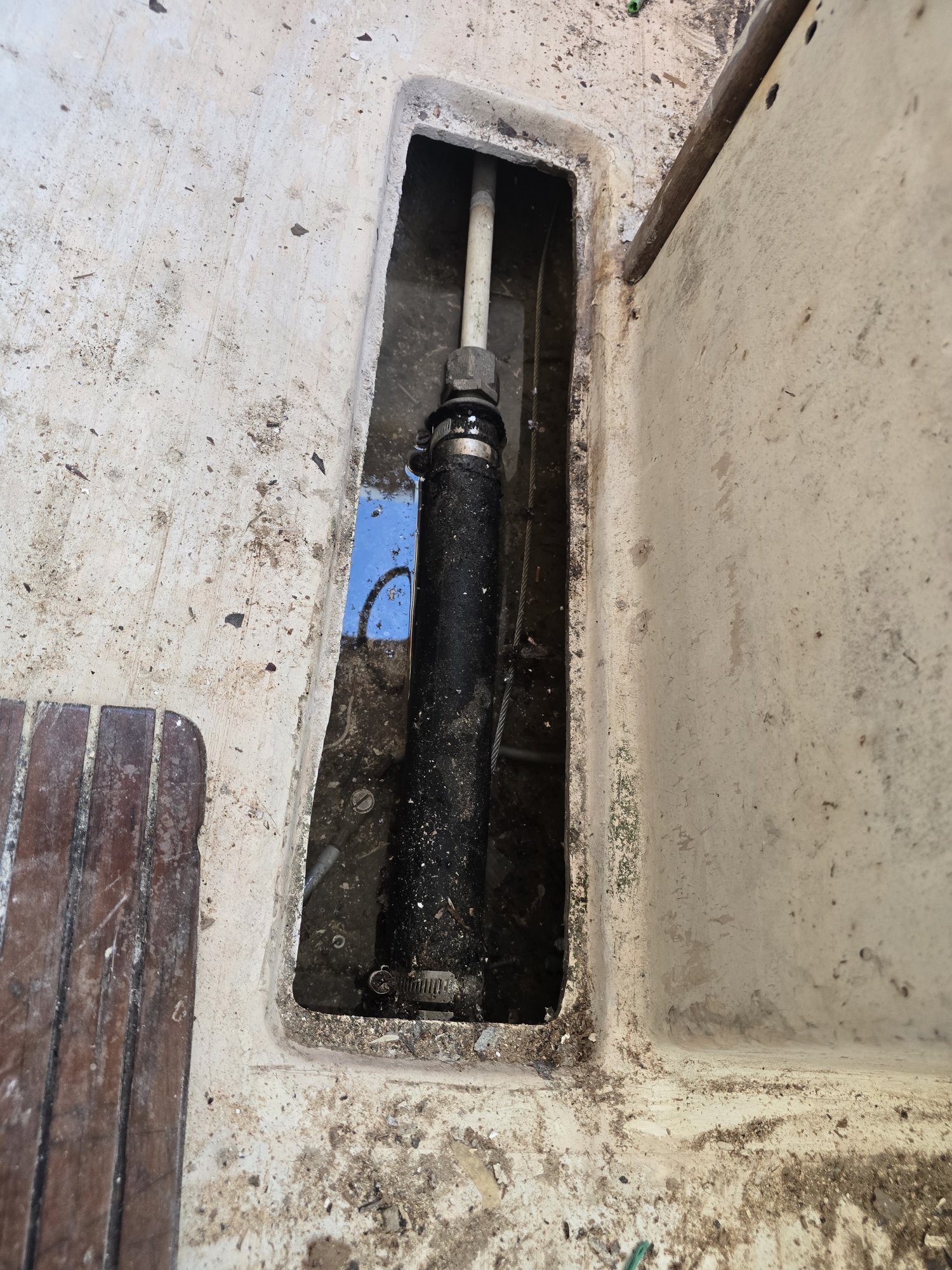

Likes: JoeWhite
13,951
Since the Irwin 23 is an outboard powered boat, you don't have a shaft log.
I'm not specifically familiar with the Irwin 23, so I won't be too specific. Centerboards are raised by a cable, the drawing on Sailboatdata.com indicates the CB on the Irwin is attached to the CB trailing edge with a cable. That cable will lead into the boat and to a winch. The winch can be located most anywhere, some are in the cockpit, some use a winch on the mast, some have a winch in the cabin. You'll have to look for it, it should be obvious. Except for a winch on the mast, they look more like a the winch on a boat trailer than a sheet or halyard winch.
The CB cable will exit the boat below the waterline. The black hose with the gland on it serves to keep the water out of the boat. Again, armed with a flashlight, follow that hose in both directions.
Sep 28, 2025
18
Irwin 23ft Tamaroa
Ok. The cable runs to the starboard side in the cockpit on the side of the seat area.ive not had it off the trailer to look for the slot in the keel area currently it's obstructed by a couple of boards on the trailer. Thanks for your help I'll let yous know when I do get it off and what I find.youll see winch on the right side of the inspection cover.
7,935
I hope I don't have to say this but if there is a swing keel, be mindful of it hitting an observer if it suddenly released. It could put a dent in one's IQ. Likely it will be a challenge to drop.
That board, if it exists, can wait for your attention. The boat will sail reasonably well without it being down. You'll lose a bit of windwardness. But there's more pressing projects at hand.
