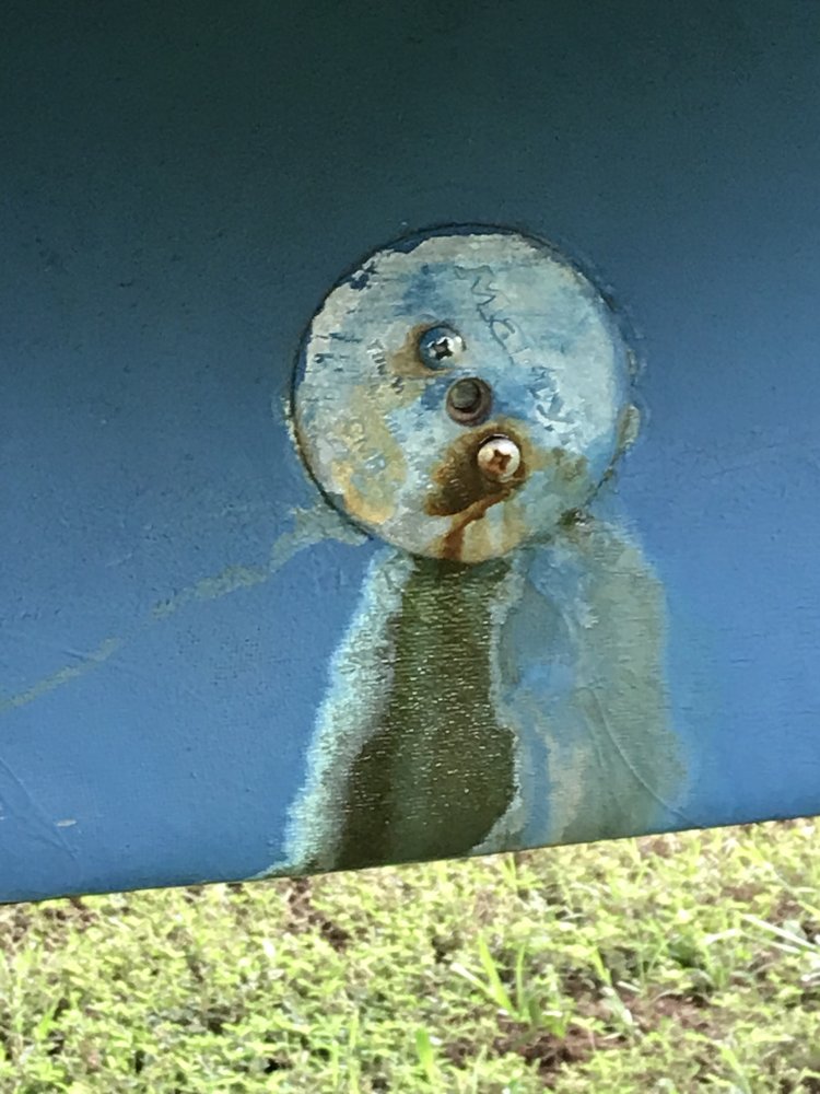

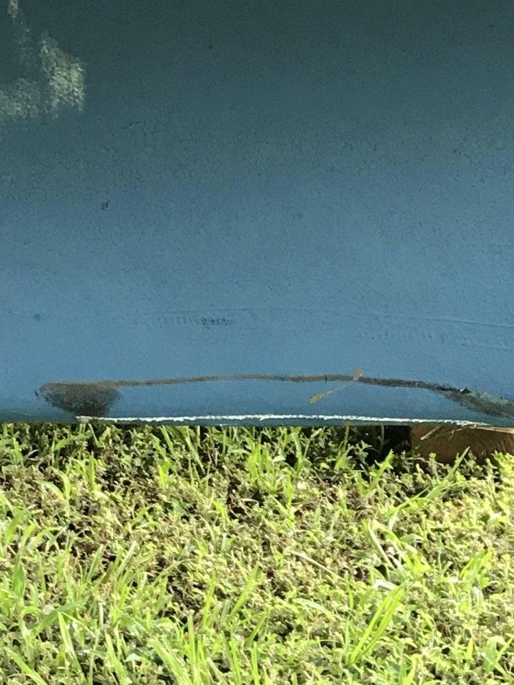

Ok guys. I did have a local fiberglass/boat specialty shop refinish the keel. I finally got to take her out yesterday and had a great day. This morning I was checking out the keel and it’s already showing signs of wear. Is this normal or something I should take it back to them for?
22,828
Take her back. (My opinion) The fiberglass mat was not fully saturated. You can see the strands. That is going to draw water in time. You should also get a coat of barrier epoxy paint and bottom paint over the repair.
Check out the West Systems sight for understanding of epoxy repairs they have some good explanations of process and images of finished work.
