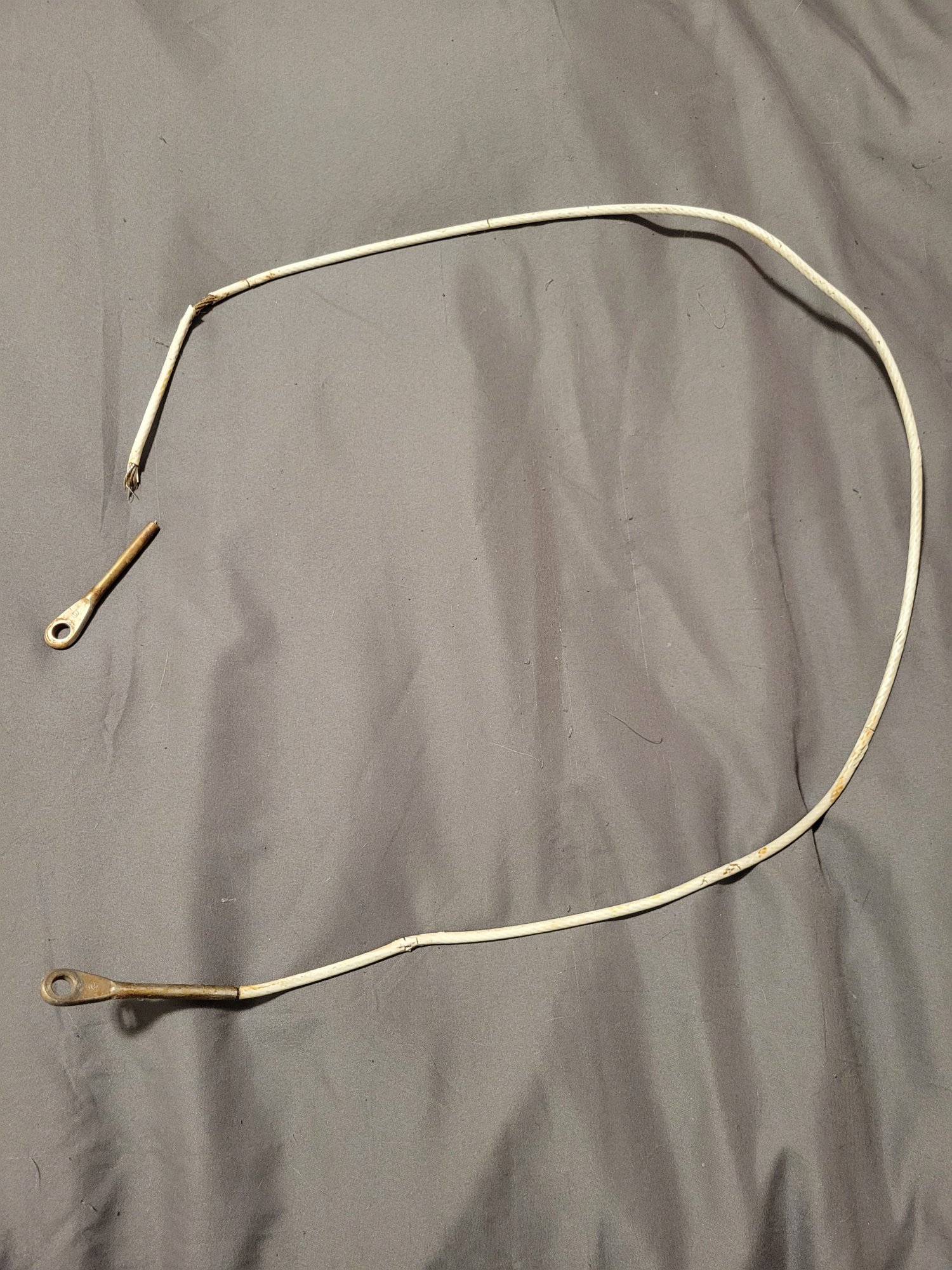

The center section of my transom swings down to open the swim ladder. The steps are inside the part that lowers down. There are two lanyards that hold the steps at the proper angle, one has broken. The OEM lanyards are vinyl coated stainless steel stranded cables with swaged eyes on the ends. The eyes are bolted to the steps on one end and the transom on the other end. The picture here shows the broken cable.
I am considering replacing the lanyards with Spectra but I'm not sure how to terminate them so they can be bolted the same as the original. Are there metal eyes that I could splice (or tie) a spectra line to? I might be able to use a thin jam nut to hold the bolt out with room to tie the spectra on, but then the rope would be on the threaded part of the bolt and susceptible to chafe.
Is there any easy way to do this?

SS cable is best for many things. But this one failed from corrosion and kinking, things Dyneema will better withstand. Maybe.
But holding a platform should be nothing, so there is an impact component. Amsteel will stretch more than steel cable. Just a fraction of an inch, but that could lower the impact force 50% without noticeable mush under body weight.

How much use do you think it took the wire cable to fail? I would stick with the cable and perhaps figure out better attachment fittings so that the wire doesn't kink.
As mentioned above, Dyneema does not like tight bends (like the one shown????) and the boats using it for rigging use special, large, solid thimbles, which may not suitable for this use.
This was my thinking. Having said that, the original took 40 years to fail so maybe stainless is the way to go. It is the kinking that is a bit of a pain, it is hard to get it to fall in place when retrieving the steps and I wanted to tray Dyneema to see if it would be easier.

The line used was covered stainless cable, which we know is not the better composite construction to use. The covering promotes corrosion. The current set-up lasted 40 years. By going to uncoated stainless wire rope, you will lower the corrosion problem. I can't tell from the photo how much kinking played into the fracture, but iif it was a major component, then using a greater wire count wire rope would minimize that concern. But still, with the same wire type, is 40 years really an undesirable lifespan?
Dyneema would never last that long. While fairly resistant to UV degradation, it is not immune. What would be the life-span using dyneema? Realistically speaking? More likely 10 years at best. But I see no scenario where it would be close to 40 years. then you are adding in other failure modes not currently present.
Hey, using dyneema is fine. Just doesn't seem as great an option as going to uncoated stainless wire rope.
