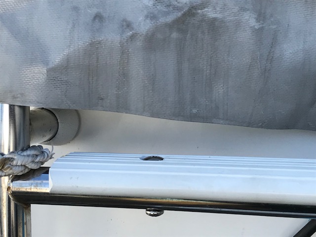

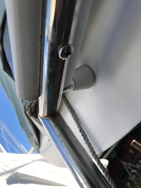

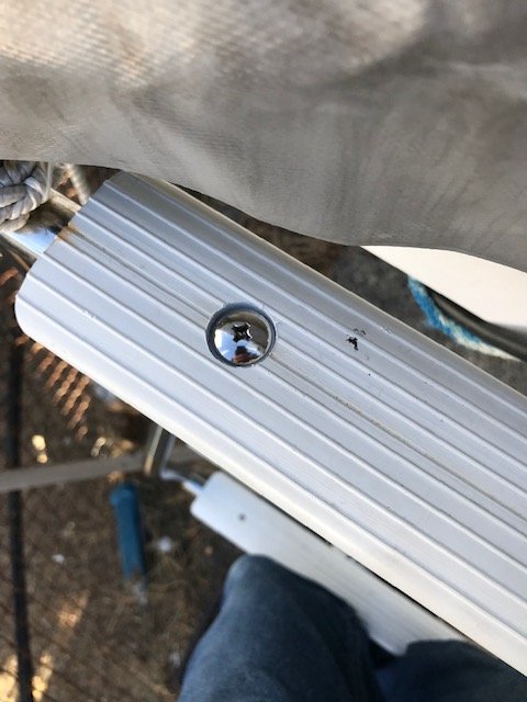

Thanks for all of your replies. The holes for the rivets in the ladder tubing were elongated, so I drilled them out to 9/32", counterbored the top of the step to 5/8" to recess the bolt head and used a 1/4-20X1" bolt and 1/4-20 barrel nut to fasten the tread to the tube. Much stronger and more reliable than rivets. Also, looks neat and clean.

Here you go Leo and all. Cold, windy day, best pics I could take with numb fingers. Alan, #189
