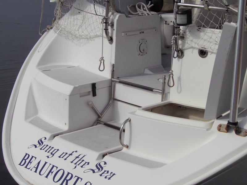

I got tired of the ladder getting in the way when boarding from the stern too. I wanted to keep the original ladder but had to figure out a way to make it a two piece ladder. After some discussion with my welder we came up with this idea and it seems to work very well. He first cut the ladder so that no step would protrude above the deck. Then he welded a solid stainless steel rod inside of the ladder and fitted it together before drilling a hole that would allow the the two pieces to be fitted together and pinned. It seems to work very well and is easy to rig up when we get underway. Here's the pictures:

214
Catalina 310 #147 Oakville Yacht Squadron
Kent Like this.............. paulj :troll:
Paul
Did you just replace the standard powerboat underside stainless mounting angle with aluminium channel? If so; what did you do for the crossbrace that keeps the ladder from swinging free on a powerboat, or hitting the transom on ours?
My plan was to have a local shop weld on a stainless fastening strip on either side bottom mirroring the top strips but the aluminum channel may be more economical; I just wasn't sure how to deal with that crossbrace.
