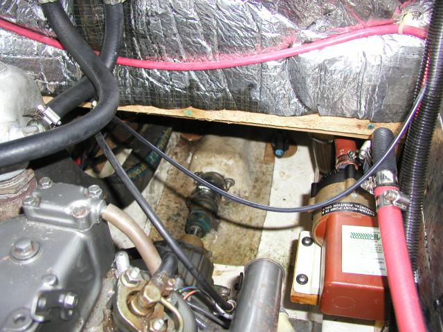

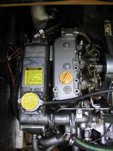

That sounds like the water outlet from the heat exchanger .. It should be connected to the exhaust elbow. The muffler and exhaust hose will overheat in a few minutes if the water is not flowing through the exhaust.. Here is what the connection looks like on the 3 GMF. It is the small hose out of the back of the heatex that connects to the ell fitting on the silver exhaust ell at the very top of the picture. In the brighter picture, it is on the left . The hose goes through a vented loop that is set above the waterline, then into the exhaust ell. Here is a helpful link to your engine's service manual that shows the hoses and stuff.. Sounds like ya done good !!!

What's the red pump thingy to the right of the air intake nozzle? AC raw water pump? Hot tub fill? Where's your Racor hiding?
Also, is the hose off your engine raw water intake thru-hull shown in the pic just beyond the pump thingy?
10,247
Dan, Yup.. That is the AC raw water pump.. I don't have the RACOR installed yet (it is in the cabin awaiting installation) but the primary filter is aft under the ledge, kinda starboard of the packing gland. The thru hull that you note is the AC raw water and the sink foot pump.. If ya look on the other side of the shaft log, you can see the reinforcement pad for the engine raw water thru hull.. Note.. probably not a good place for the AC pump because in the summer, the temperature in the engine box will get hot enough to trip the thermal breaker in the motor.. I have to put a little ice on it to get it running.. I am going to put a blower on the box this year to suck the hot air out of the engine compartment.
