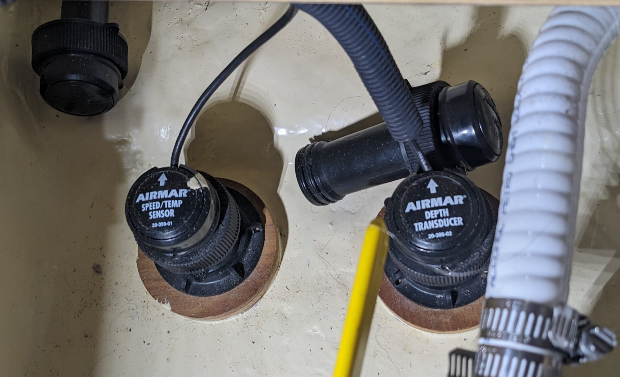

On my 2007 H41AC, the water speed transducer is near the centerline of the boat while the depth transducer is slightly offset to starboard. Because of the hull shape, this results in the depth transducer beaming along the hypotenuse of a triangle rather than directly below the hull. Has anyone swapped the depth transducer and water speed transducer in a similar situation?
I'm being hauled out tomorrow and will be on the hard for about a week. I intend to see if I can swap the transducers while out of the water.

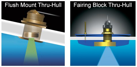

In this image, you can see a Garmin flush mount transducer that has the angle adjusted to address the angle of the hull.
