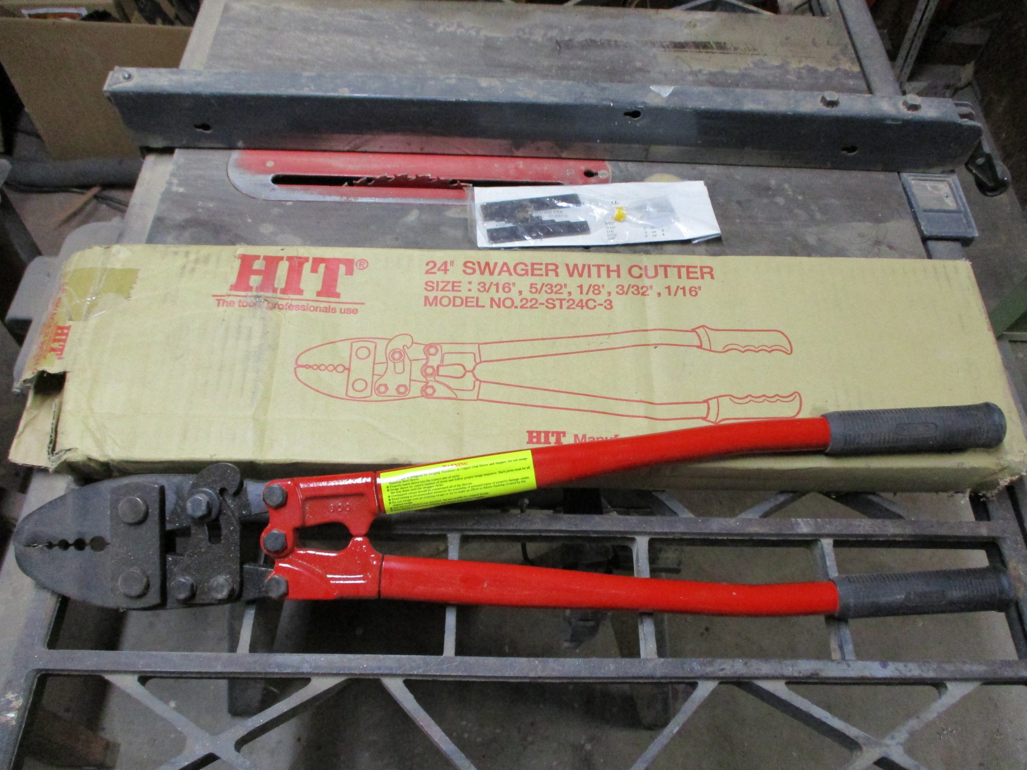

I've been using this tool for 15 years or so. still available on Amazon etc for about $200. and does a great job for anything I've had a need for from 3/32 to 5/32" (made in Japan, not China btw). the longer handles make crimping that much easier, especially on the larger size rigging. I built all new 5/32" standing rigging for my Mac 25 12 -13 years ago, and several others since then, using zinc plated copper swage (x2) and had no corrosion problems. I generally get my sleeves from Rigging Warehouse. price varies a LOT, depending on source, so it pays to shop around.
