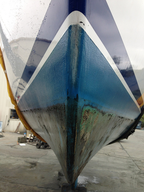

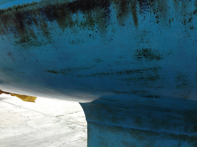

So, I just got back from the survey and I have to say that you guys are pretty damn good. You all hit on the things that were questionable, sight unseen.
The surveyor is doing the final write-up right now and says he'll have it over to me tonight. The things I remember are:
1. The moisture meter/hammer test did indeed find some water along the center chainplates and forward toward the chain locker. The surveyor actually asked if we wanted to stop the survey right there and skip the haul-out, but I said we could proceed. Later, he said there was little chance of the mast toppling over or anything horrible happening (there was no "squishiness" in the deck), but that I should definitely get it fixed as it will only get worse. Said it would run anywhere between $1,500 - $3k. "The problem will come back on the day you decide to sell the boat."
2. Some of the wiring was done incorrectly, and apparently with wires/connectors that aren't "up to code." I guess the PO used a couple of those plastic wire connectors in a few places with no electrical tape?
3. The propane to the stove isn't run properly. He said it's possible that it could leak, perhaps even into the engine compartment.
4. The last 8" of hose from the holding tank is in rough shape and will need to be replaced.
5. There's a small fuel leak in the engine. Strangely, I seemed much more concerned about this one than he did.

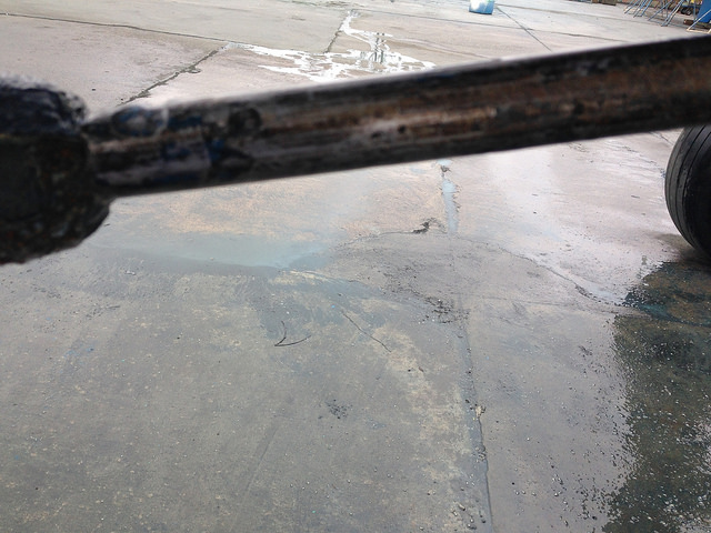

6. I can't remember what it's called, but there was some scarring on the propeller shaft, above the two "egg-like" things that are made of zinc? (We actually replaced those while it was out of the water.)
The hull appears to be in "very good" shape, and the sails, running rigging and belowdecks all look fantastic.
@dunlookin That's funny, on my way off the boat I noticed there was less than 1/4 tank of diesel on the gauge... I guess I can still ask them to fill the tank up and see if it leaks before I sign?
As things stand now, I'm still leaning toward a "yes" if I can get the boat insured and therefore into a marina. I did expect there to be some work necessary, particularly given the low price.
That said, you guys are much more knowledgeable about this than I am. Should I be backing away slowly?
Thanks again to all of you.

His recommendations/deficiencies were:
- Light fuel leakage at the auxiliary engine mounted secondary filter.
- The propeller shaft had localized moderate pitting.
- Single strand 110VAC wiring was located at some locations, i.e. outlets, etc. & a 110VAC wire was spliced w/ wire nuts inside the Salon forward hanging locker.
- There was light crazing &/or fracturing of both upper standing rigging swage fittings.
- The propane system was improperly installed in the cockpit starboard locker, & not in compliance with recommended standards. (Note: System should not be used until serviced)
- The bow running navigation lights were inoperative.
Under the moderate/deferred maintenance and repair he had the chainplate issue:
There was lower main deck delamination at some locations:
Port = Percussion delamination: between chain plates, Moisture meter: "wet" between forward lower & trailing end of fixed portlight,.
Starboard = Percussion delamination: between main chain plate & chain locker, Moisture meter: "wet" between aft lower chain plate & chain locker.
