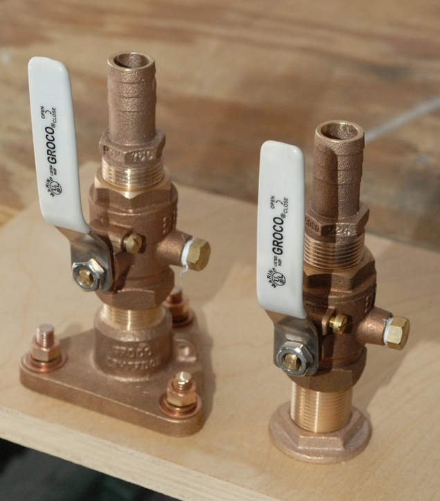

Are your through hulls ABYC approved and flanged as shown on the left or not flanged as shown on the right hand side as shown below. Perhaps mention if they are factory installed or not.
Taken from Marine How To with big thank you to Maine Sail for his excellent display and photographic skills.
I think we all know the perils of the NPS / NPT valve through hull and if not, this MARINE HOW TO article tells you everything you'd want to know as well as a few things you may not want to know.

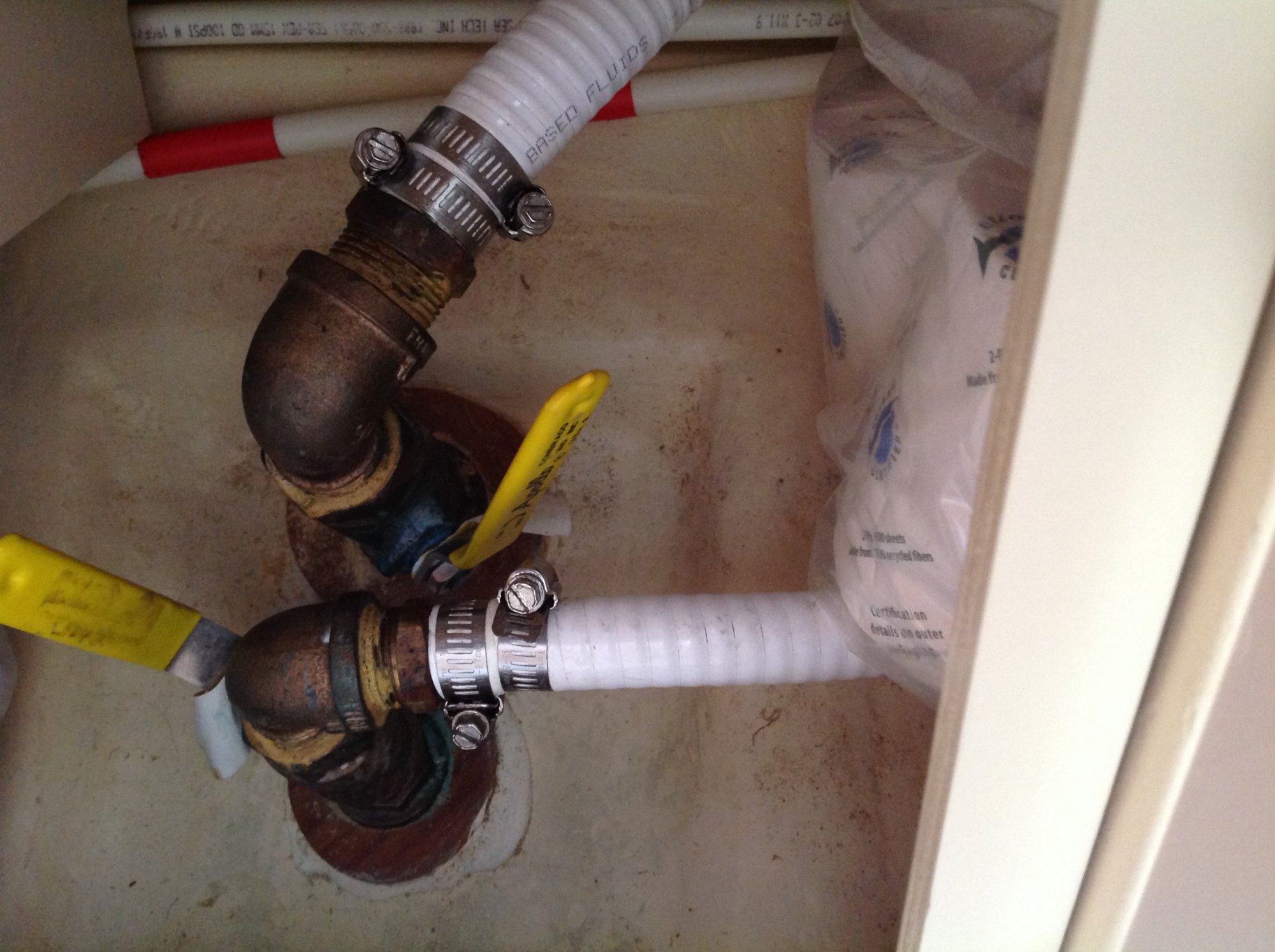

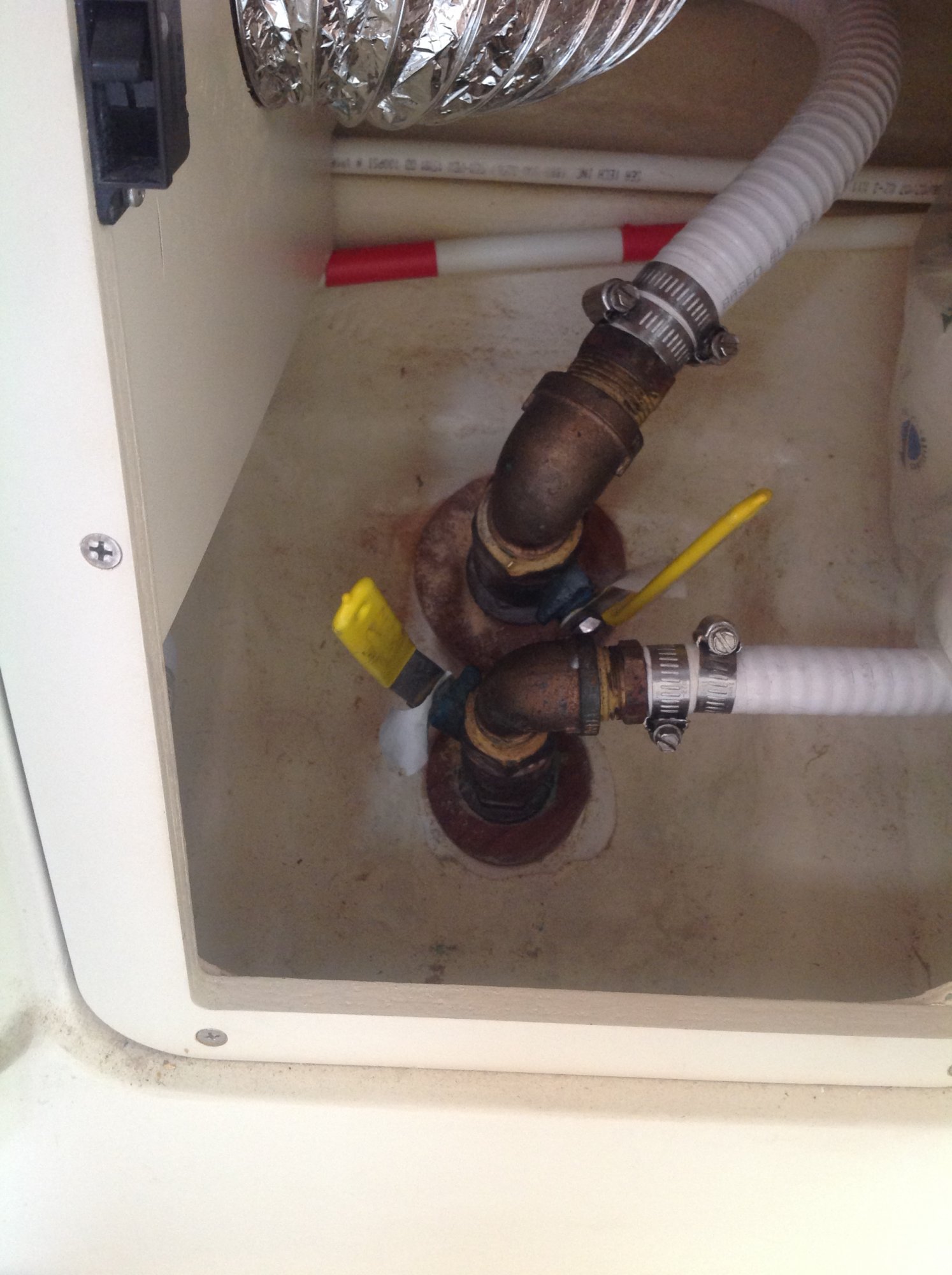

If I could add. My 2000 340 are not flanged either. Still working smoothly and solid to the hull.
I totally agree with Fastolson, check them often and exercise those handles regularly! It‘s you best defense against a potential problem.
And if can add another word of caution….don’t get heavy handed with the grease. I did and it led to a completely stuck (in the open position) thru hull. I couldn’t move that handle for all the money in the world.
Finally after my winter haul out, I was able to apply heat from a heat gun and melt the grease out of the fitting. Now it’s the easiest to open and close thru hull I have on the boat.
I don’t know why I used to much grease that year but I did.
Now I’m very light on the grease!

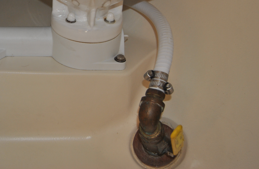

7,204
Not flanged. Original 1994; just replaced one. I will probably do them all next haul. No, I don't exercise them as often as I should. BTW, the major manufacturers would probably take exception to this construct not being ABYC compliant. I know Hunter tested them and they were in compliance with ABYC side loading. FWIW.

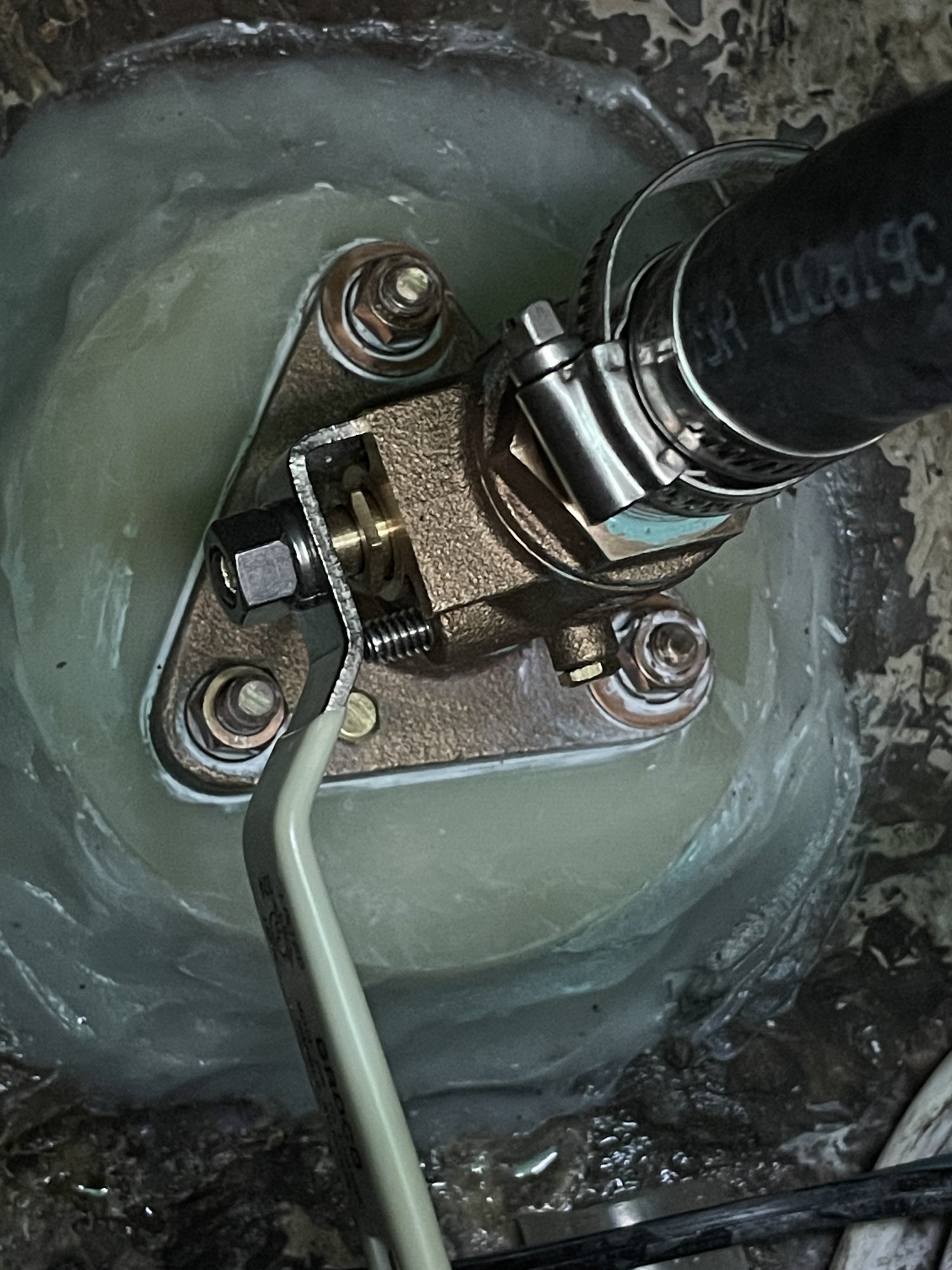

I replaced 3 of the 5 with Groco flanged seacocks, as described in this thread:
After 2 years, I'm glad to say that the new thruhulls and seacocks are holding up just fine. (Some questions were raised in the thread about polyester resin sticking to the Groco backing plates.)
The backing plates have also been painted with gelcoat since then (and yes, I did use hose clamps: this was an in-progress picture).
The remaining two are on the head sink and galley sink, which have appallingly bad access, so I'll have to get pretty far ahead on my project list before they rise to the top.

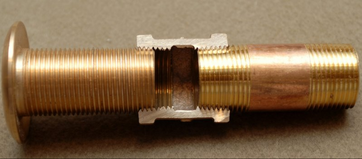

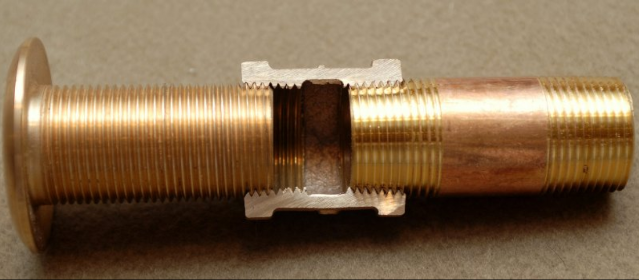

I really must clarify this - the wording of this sentence implies (not saying that's what you intended) that non-flanged installations are not ABYC approved and that the approved ABYC installation are flanged.
My primary concern dealt with mis-matched threads on the thru-hull to seacock joint.
ABYC 27.6.1.3 Threads used in seacock installations shall be compatible (eg. NPT to NPT, NPS to NPS).
If the valve assembly is flanged, it's almost assured to have an NPS inlet thread.
Mushroom headed thru-hulls, to my knowledge, are invariably NPS and are sold with an NPS nut. When I see that nut, it means just grab an NPT valve, screw it on, and you're good to go. That's where I believe the problem lies. Or actually, more like here below:
Courtesy of Marine How To

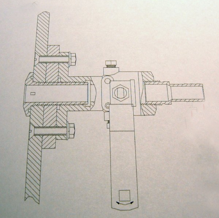

You now have an assembly guaranteed to fail ABYC 27.22.4 in addition to having mis-matched threads which violates ABYC 27.6.1.3
Additionally, I'm not to keen on having an exposed section of NPS threaded pipe subject to sea water corrosion on the I.D. and wide open to the boat interior on the O.D. In his Marine How To article on thru-hull fittings, @Maine Sail did the research for me and concluded that the wall thickness at the root of a 1" dia, thru-hull is 1.54 mm. or just under 1/16".
My cooling raw water inlet to my engine is 1/2" dia. Any guesses as to the thickness of that thru hull at the thread root :yikes:.
I do not want my first line of defence against sea water ingress to be less than 1/16" thick bronze and no upstream valve. Given a proper thru-hull installation as shown below:
................ you are protected even if the NPS thru-hull should corrode away due to extreme stray current.
The more I look at NPS threads mismatched to NPT threads with less than 1/16" thickness at the thread root, the more determined I become to change out all of my old thru-hulls to proper flanged installations .................... next year :pray: !
