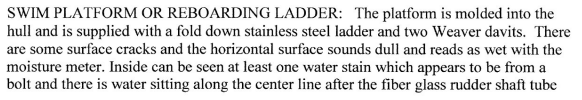

Hello,
Curious your thoughts on a 2yr old survey of an 1997 Oceanis 321 - specifically these comments below.
Is this considered "normal" for a Beneteau of this age? Would this be considered a deal breaker? Other thoughts?

Too vague to make an informed judgment but generally, it would surprise me to find any 25 year old boat with no leaks or elevated moisture readings. Plus a 2year old survey is way past it’s usefulness.

The rudder description would worry me…not so much on the swim platform. But I would inspect the rudder tube carefully if there is evidence of leaking.
Greg
I agree with Greg.
The last comment about the cover for the steering cables, to me would be no big deal. That cover is solid fiberglass at least on my boat and has no wood in it that would be compromised.
which begs the question how reliable any of those moisture findings are if its solid glass.

Appreciate the feedback! The area around the chainplates was said to have been repaired and the other areas left untouched. Nevertheless, having another survey conducted by a different individual this Friday to validate no serious structural or safety related issues.

1,393
