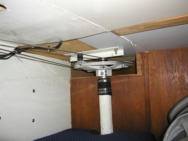

Steering Cable
Original wire rope on my boat, 30 years old. It is inspected and lubricated each year. Easy to get to and well protected on the H-34
