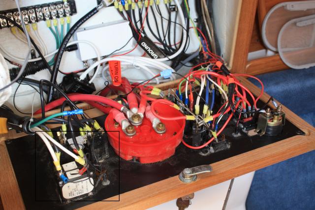

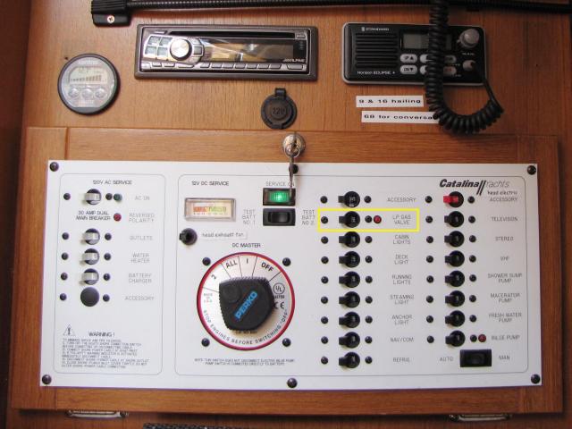

So today was the big day. In a nutshell, the survey/haulout/sea trials went extremely well. The surveyor basically told me that the boat is in above excellent condition and was very well maintained by the PO. The only deficiencies included: worn alternator belt, need to put a cap on the exposed post on the alternator, need to move the CNG switch from behind stove (it's on the panel), need to mount the smoke/CO detector (it was sitting on a shelf), isolate the AC and DC portions of the panel and replace fire extinguishers. That was it. He did suggest a few things as PM for the future and they included rebed bow pulpit (there was some moisture but no sign of delamination), put white lithium grease on the motor mounts and prop shaft flange bolts, and a few other maintenance suggestions.

"isolate the AC and DC portions of the panel"
This should be interesting topic.

... need to move the CNG switch from behind stove (it's on the panel), ... , isolate the AC and DC portions of the panel ... put white lithium grease on the motor mounts and prop shaft flange bolts.
These are curious items. Were they modified from the factory configuration?

2000. I should have said behind the panel. Apparently the two ne'er shall meet. I've done this for two friends who had the same issue on their surveys years ago. I used PVC work boxes and the insurance companies were OK with it.
Originally Posted by gpd955
No modifications. Mine is in the same spot. His opinion of "behind the stove" may be different from mine (to the right and back). He suggested that to limit corrosion so the bolts will be easy to loosen during adjustments.
