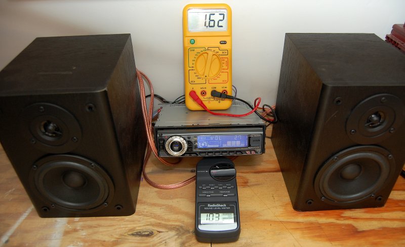

Stereo power consumption is very dependent on how many speakers it is driving, impedance and the design efficiency of the speaker.
Here are three photos the ONLY differences are the speakers. One set is a highly efficient 4 ohm set and the others (KEF) are a set of 8 ohm inefficient speakers. The SPL meter and the amp meter don't lie. This clearly shows why it is best to use 4 ohm impedance speakers with car stereos and how a simple thing such as what speaker you choose to use can play a HUGE role in power consumption..
In this first photo the Kenwood stereo is powering the set or 4 ohm rated speakers and the volume is set to 27 the power consumed at volume 27 is 1.62 amps and the SPL meter reads 103db. The SPL was hoovering between 103 & 102 (mostly 102) so to be fair I'll call it 102db not 103db..
In this second photo the Kenwood stereo is powering the set of KEF 8 ohm rated speakers and the volume is also set to 27. The power consumed at volume 27 is 2.12 amps. The SPL meter reads 94 db but to be fair it was hoovering between 95 and 94 (mostly 95) and I happened to catch it at 94. I think it is fair to call it 95db. It should be noted that this is NOT an ideal location for an SPL meter but it was in the same location for both sets of speakers. Unfortunately to catch it all with the camera it needed to be where it was..
At the same volume setting the 8 ohm speakers produced less volume output and consumed roughly 131% more current than the 4 ohm speakers did. While all speakers will be slightly different it is safe to say that 8 ohm speakers will draw more current at a given volume than a comparable set of 4 ohm speakers.
The meters used are 100% impartial. That's why I used an SPL meter because my ears, while fairly good, can't determine a 1db difference in output volume. All things were tested exactly equal at a steady voltage input and the same stereo volume setting and test tone CD....
Car stereos on boats will consume less power using 4 ohm rated speakers and will also generally play a little louder at teh same input volume.
Lets assume that your personal volume comfort volume level is 102db. With the Symphony 4 ohm speakers I used you would consume 1.62 amps to achieve 102db, as in the photo above. If you wanted to achieve the same listening level of 102db with the 8 ohm KEF speakers it would require 4.58 amps (I caught it at 101 but it was bouncing between 101 & 102 the meter is very sensitive) !!!!!!!!!!!!!!!!!!!!:doh::doh::doh:
Is it safe to use 8 ohm speakers with a car stereo? Yes & it won't hurt it any but it certainly won't save any amp hours..
