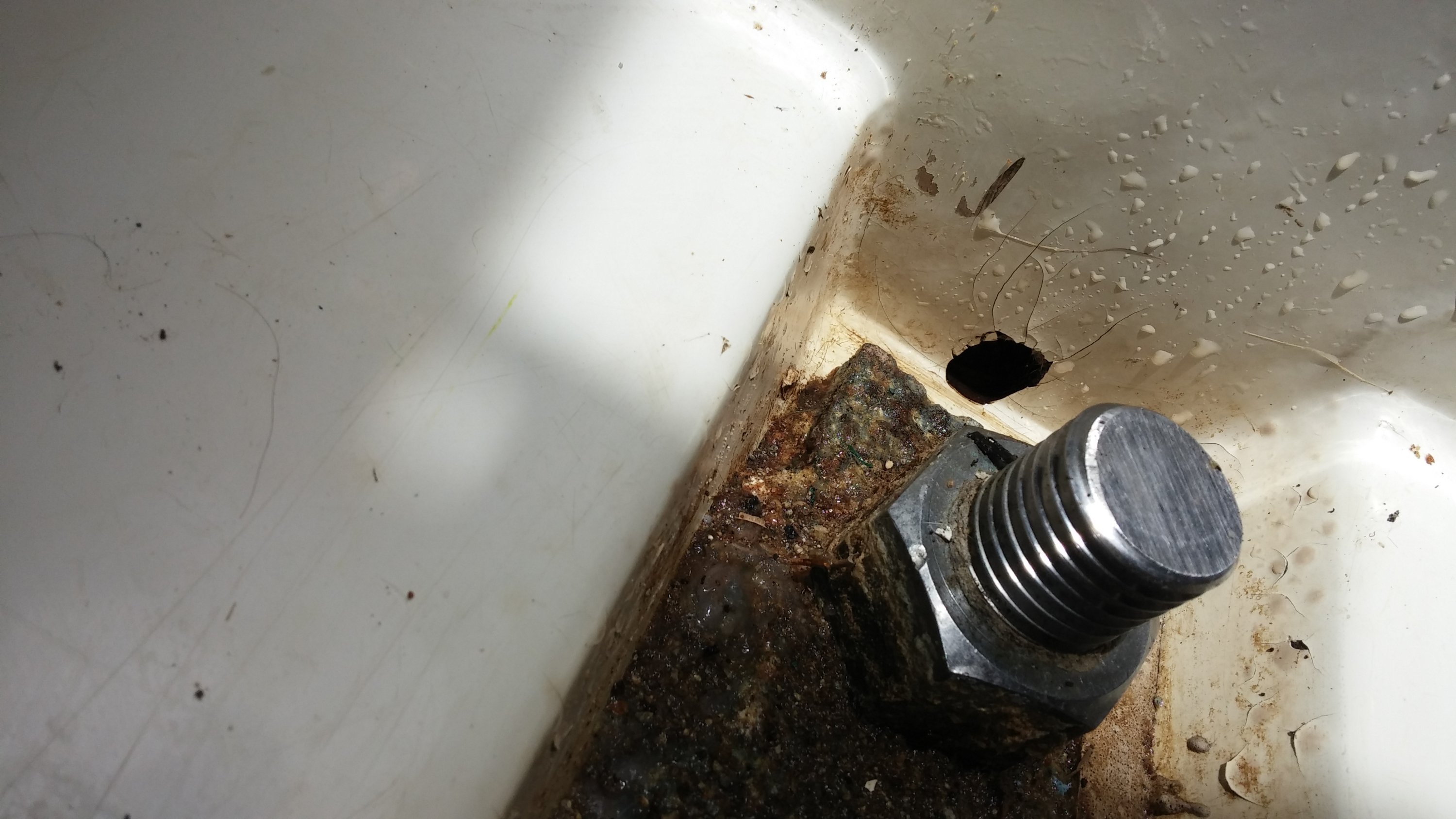

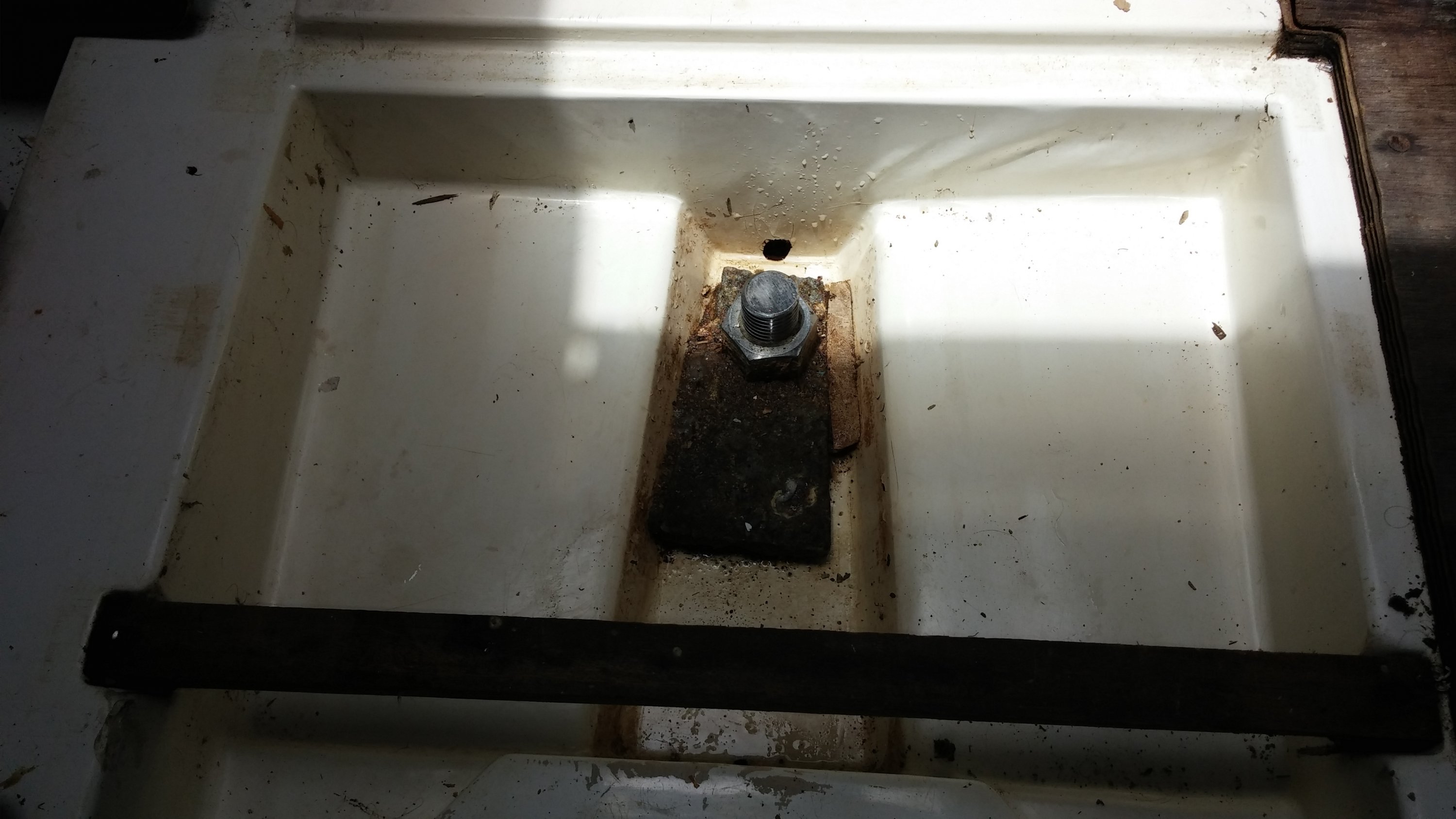

Issue #1: Just forward of my companionway steps, under a teak grid that serves as the sole at that location, is a sump that also allows access to three of the keel bolts. There is a "weep hole" (approximately 3/8") in the aft portion of this sump (see pictures). The weep hole enters from UNDER the engine bilge. We took approximately 1.5 cups of water out of this sump with a sponge yesterday, and today I took out approximately 1/2 a cup. Anyone know what area(s) under the liner this hole will be draining?

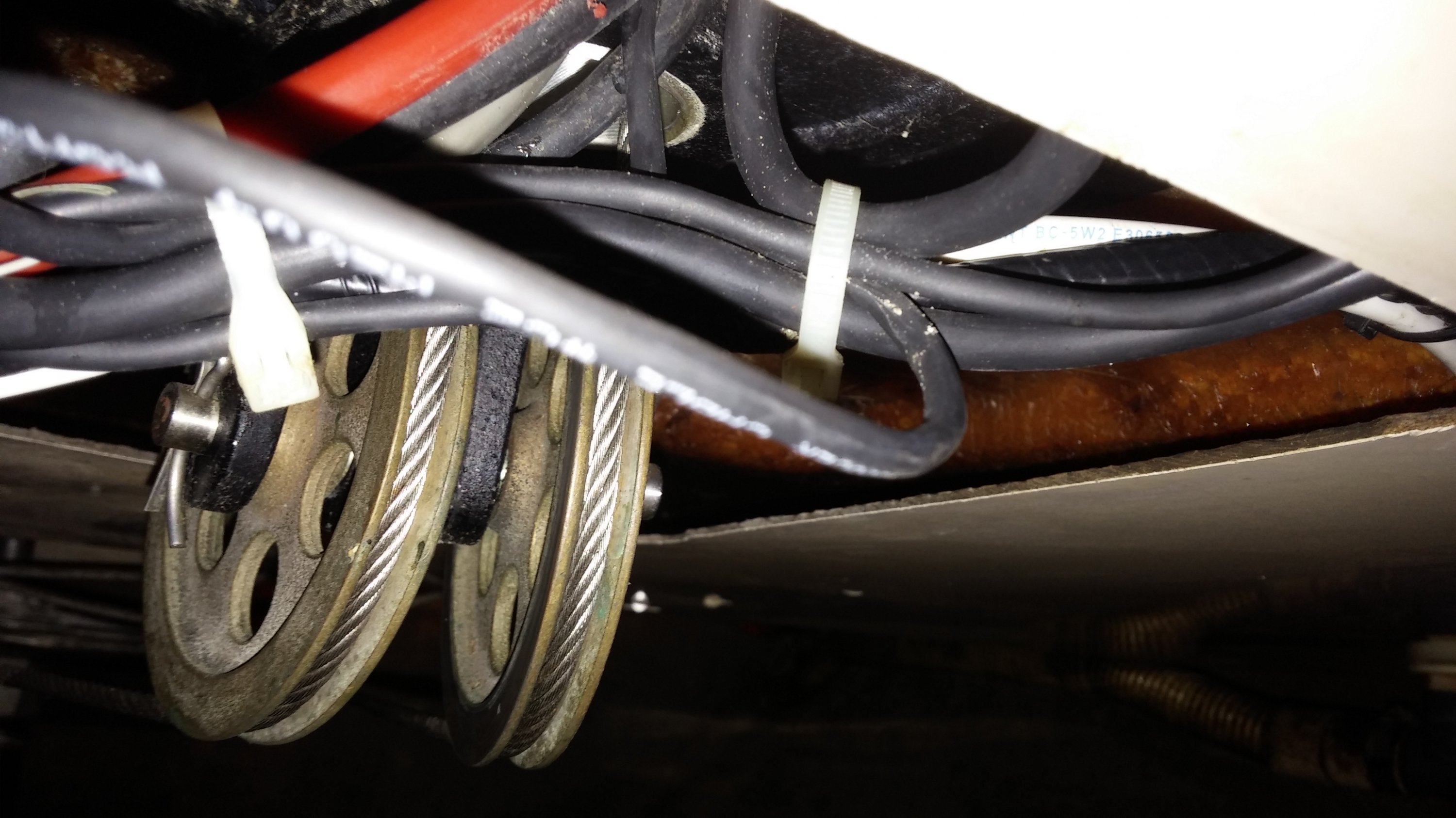

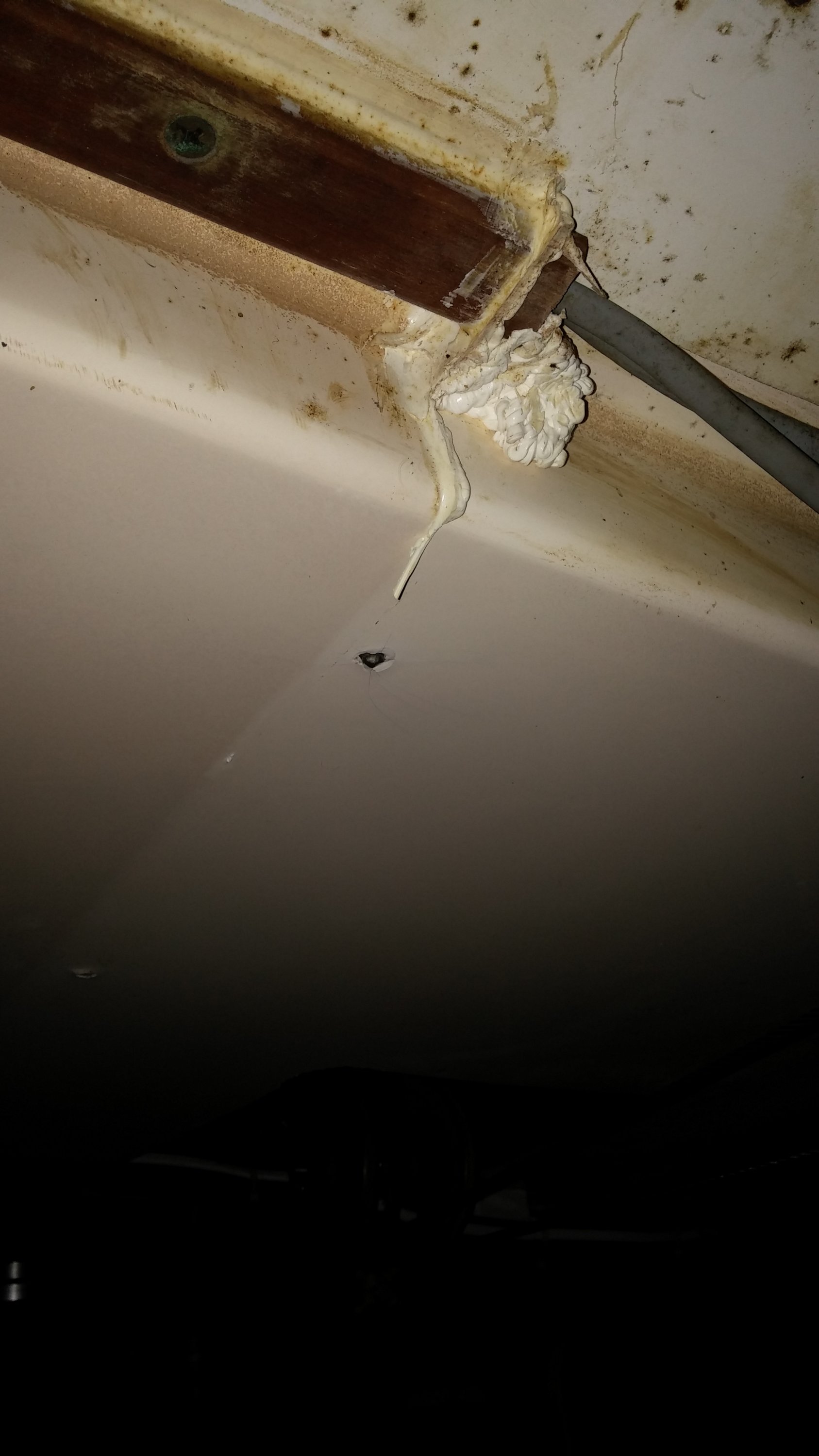

Issue #2: I had more water than I wanted to see on the items I had stowed in the port quarter berth. After removing all those items, and while drying the fiberglass in the berth, I felt a drip from above. Looking up I found a series of (dripping) old fastener holes in the false ceiling, which is about 2 inches below the cockpit floor. (See left picture below). Right picture below is taken looking aft (ish) through the steering cables and gear, to get an idea of the space between that ceiling and the cockpit floor. I was able to remove some pooling water that was sitting on that false ceiling using a rag wrapped around a flexible rod. Any thoughts on where that pooling water may be coming from?

Cockpit drains at cockpit floor? Is there an opening port in the aft cabin /cockpit sidewall? and the worst.. the pedestal mounts.

Anyone have thoughts on Issue #1 - I was stunned when I saw that limber hole running from UNDER (not through to) the engine bilge. Is this just one of the holes that Hunter put in to help water eventually move to the (false) bilge?

Ray, your area that holds leaks from the engine compartment is very clean. Nice work! That area remains a bit of a mystery to me. The first thing I always do with standing water is taste a tiny bit of it to see if it is fresh or salt. By itself that tells you something. I have small amounts of water that that accumulate in the same spot. The water is usually salty. I have poured water colored with food coloring in various places in the aft of my boat. What I have discovered that drains to that area which by design does not go to the bilge, is obviously the engine compartment. Also, when you go into the deep "pit" of your starboard cockpit setee (facing port) your left foot is in one drain area that goes to the bilge and your right foot goes in an area that drains, (this includes the area underneath your galley sink) to the area you found water. I have a little water in that same area from time to time but I am convinced it is coming from a little water that leaks from my dripless seal on my prop shaft only when using the engine in gear. I am still not sure where else may drain to that area.

Port in cockpit wall; many times a leak is not visible.. the rain water can come in around the port frame from the outside and gets into that space with the false ceiling. From there it will find a "someplace" to drip out. The pedestal base joint is just above the turning sheaves for the steering cables,, You may be able to see by getting in there during a rain event and watching.. Leaks could be from the thru-bolts or the flange/cockpit floor joint. Much more difficult to keep rain out than it seems! Happy hunting.

Mike, thanks for the long response. I want to emphasize that that limber hole drains a blind area located UNDER the engine bilge. The engine bilge itself is entirely self contained, with no plumbing leading anywhere, no holes of any sort, no cracks, no way for any fluid to escape. Which is ironic, as I have never seen a drop of anything in that area.

I have confirmed that the port cockpit scupper leaks into the cabin. The water appears on the underside of the cabin ceiling where the PVC comes through. If it leaks there, then the water had to have passed under the flange at the cockpit floor, and run down the outer PVC walls to get there. Can't remember if that is in the area of the false ceiling, but if so, the ceiling would certainly catch some of that water and pool. And if one is scupper leaking, the other likely is as well, which could be the source of the water in the basement. This will be my immediate priority, as I want to enlarge them and rerun the hoses.
