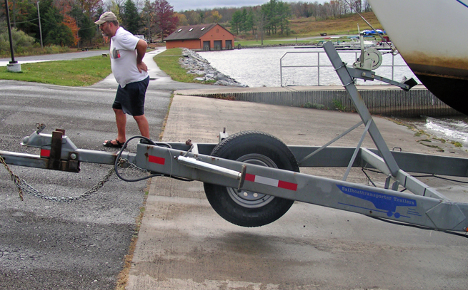

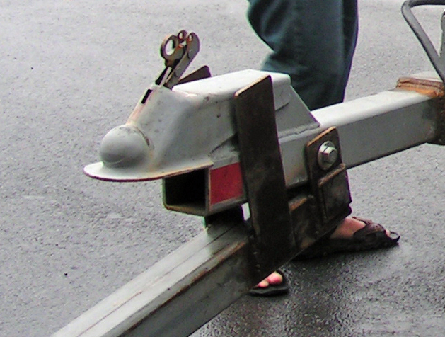

Not sure who your question is directed at, but if it's about my tongue extension:
The center frame member of the Calkins trailer is 8′ of 1/8″ wall, 3″ x 4″ rectangular box tube. To make the tongue extension, I purchased 10′ of 1/8″ wall, 2-1/2″ square box tube to telescope inside it.
I had my welding guy tack 1/8″ thick x 5/8″ ID washers on both sides of the inside tube at each of the connecting pin holes. Together, the washers take up the remaining space between the 2-1/2″ inner tube and the 3″ outer tube.
