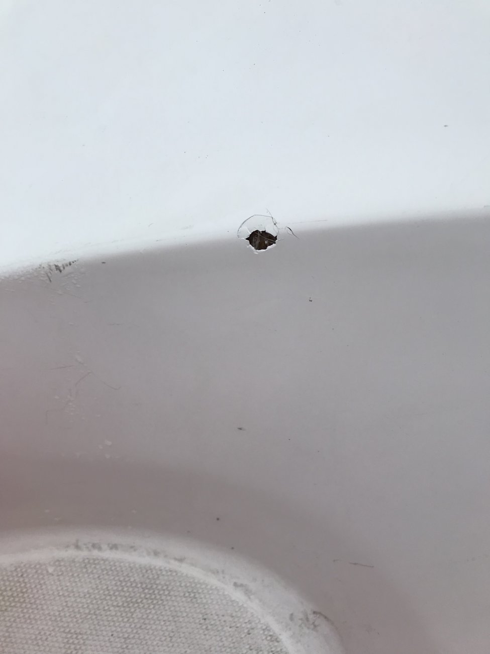

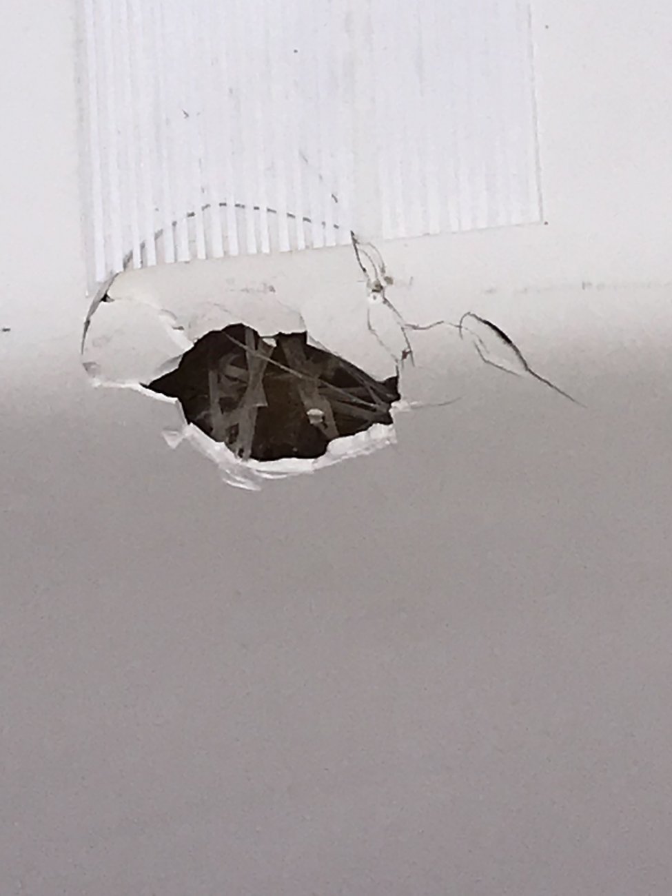

Here a photo of the chip. The tape above the chip is 1" wide for scale.
It is on a curved surface but I don't think it is a flex area. You can see the seat below it in the smaller picture.

The picture looks like a hole rather than a chip, but if indeed it is just a chip the above advice is what I'd do. In fact, even if it takes a long time to complete the gel coat part, do the epoxy part soon to keep water intrusion and winter ice from making it worse. It doesn't look like it will be a difficult repair except color matching.

Slightly different fix here.
It is difficult to get fiberglass to lay up in corners like this. It is common to find voids between the gelcoat and the fiberglass. Some cloth does not like to make tight turns. It is likely the fist layer of glass is mat, which is kind of stiff. This is not a structural issue.
Clean out the void a bit more and get a nice fair opening. Fill with thickened epoxy to just about where the gelcoat begins. Once that cures, wash it with soapy water and a scotch bite pad. This will remove any amine blush that might have formed. Rough it up with some 80 grit sand paper, clean the sanding residue with a rag and acetone and then apply gelcoat. Don't worry about getting the gelcoat perfectly smooth, that is what fine grades of sandpaper and wet/dry sandpaper is for.
Check the Boatworks Today Youtube channel. Andy has a lot of videos about working with gelcoat and different kinds of repairs.
You may hear that gelcoat won't stick to epoxy. That is sort of correct. If the epoxy surface is not prepped properly, i.e., the amine blush is not removed and the surface is not roughed up, it won't. The West System website has articles on this issue. Andy on Boatworks Today has also tested gelcoat on epoxy.

WOW that is some chip, caused by a dropped piece of conduit. How far did it fall to create that much damage? I suppose I would go with West System.
Feb 21, 2008
408
Hunter 33 Metedeconk River
Only about 1 foot. I guess it hit just right on the bend. ☹ Or just wrong.

You are correct. It looks more decorative than stress area. @dlochner has nailed th way to repair it.
Can you reach up under the area? If so I would reach up there with a piece of gorilla duct tape and seal the on the inside pressed up firmly against the fiberglass. It will help you to shape the repair. Make your mix thick like smooth peanut butter. You can use chopped up glass fiber to one of the manufactured thickners this will set up in temps down to about 50 degrees. If you cannot find a 48 hour period warm enough then you can try heating the space around the damaged area with a heater or lamps under a tent. If that is not possible, then cover the area until spring with tarps to keep water and snow off the area. Dry so water does not intrude. Then in spring when you get some early sunny days you can try the repair. Call up a friend and have then help with moral support. It is a project that you can do. And remember... Beer helps to lubricate the process.

John you are spot on with the repair. In the days before vacuum bagging, the wet mat was rolled by hand and sometimes getting into a tight radius was difficult, and not rolled properly.
From leighsail photo that seems to be the problem.

You’re going to have to grind it out to a cupped hole, removing the crack to the right, all the loose stuff and all the jagged edges. A Dremel tool would be great for that. The right way to repair would be to use fiberglass and epoxy resin. You’re not going to get a chemical bond to cured fiberglass and epoxy will give the best mechanical bond. Probably just mixing some cabosil into the resin to make a paste will make a repair that will outlive the rest of the boat though.
