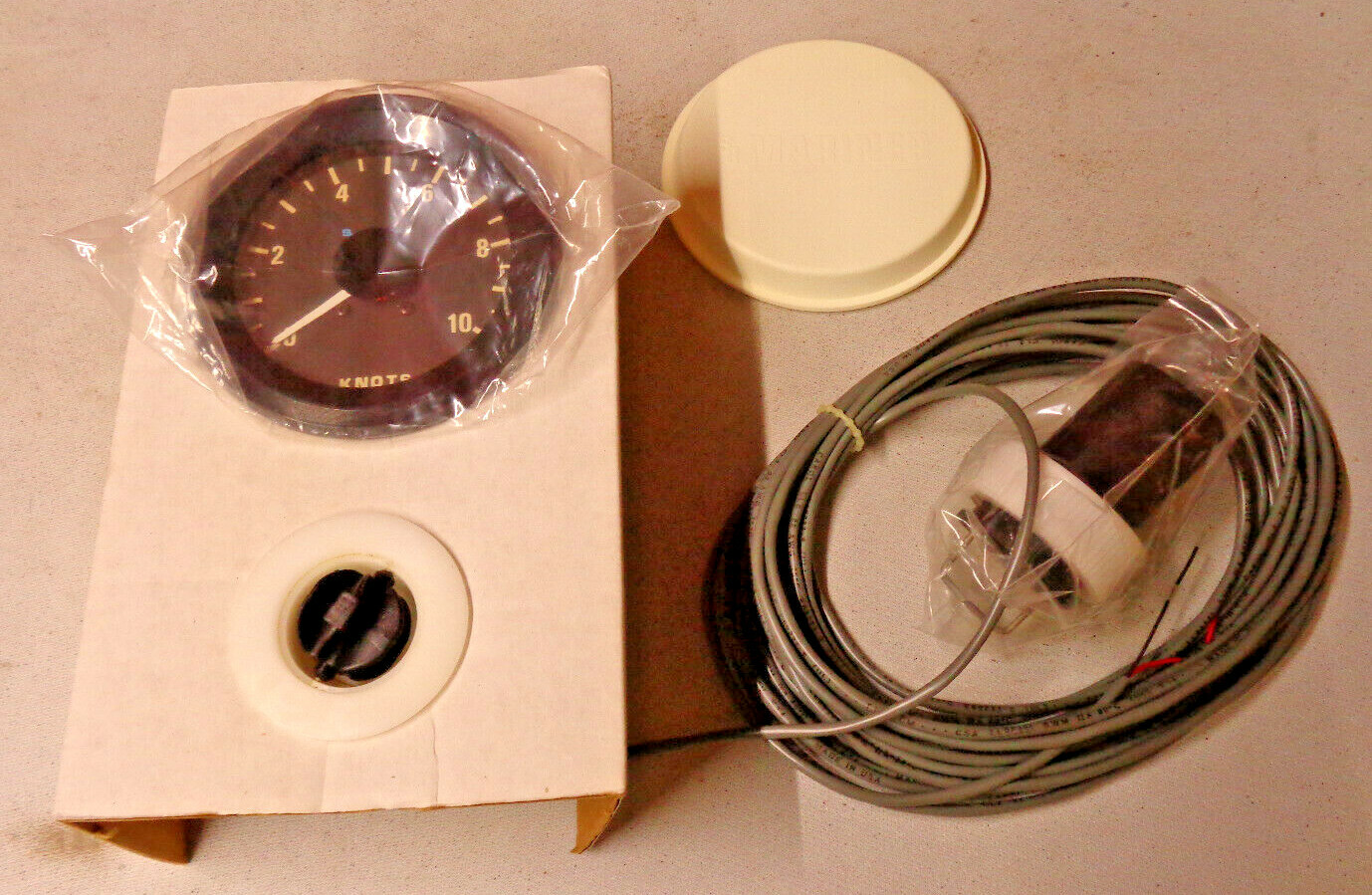

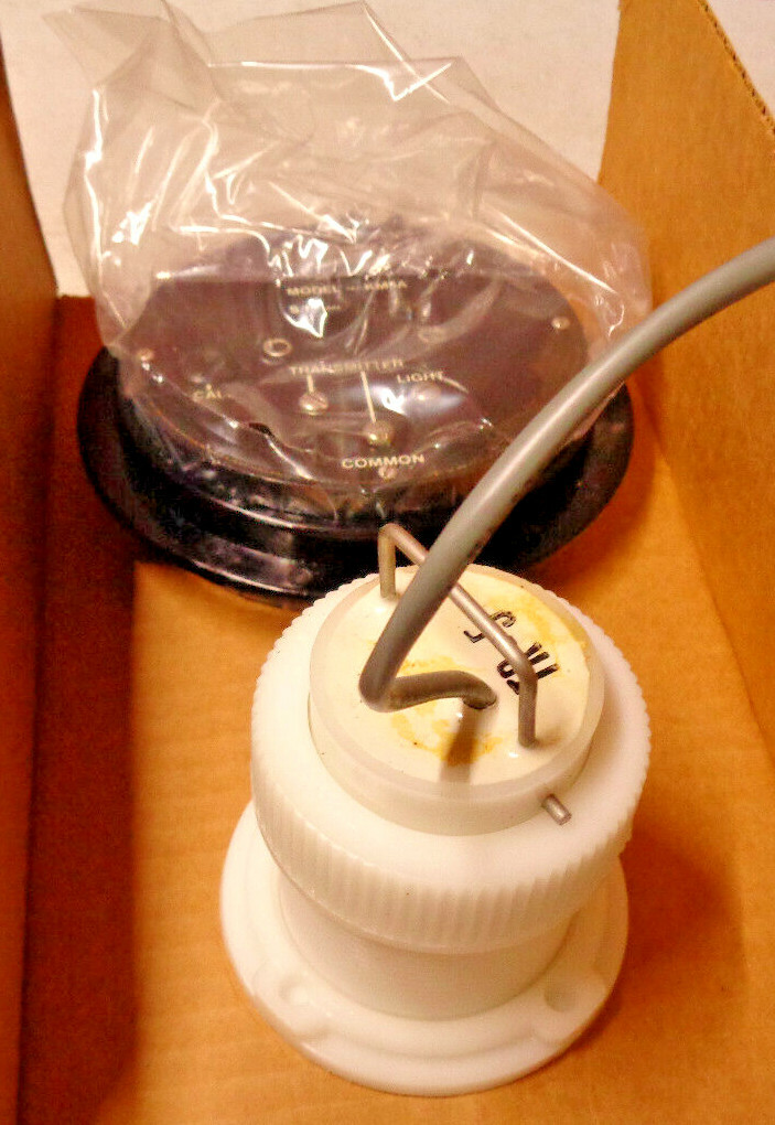

To be perfectly honest I have not seen the inside of it. Here are a few pics of what it looks like

Hmmm, an old thru hull for a speed transducer that probably doesn't work and is of suspect integrity... Sounds familiar -
I don't know the best way to fix it in your schedule, but I probably wouldn't just continue relying on the adhesive if the flange is gone.
