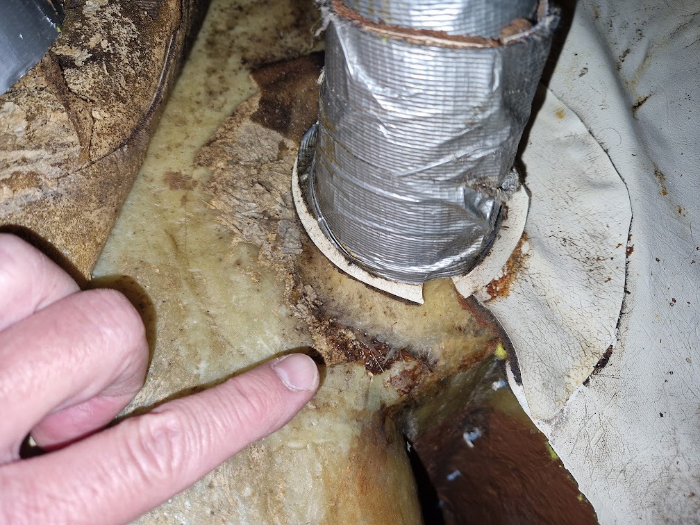

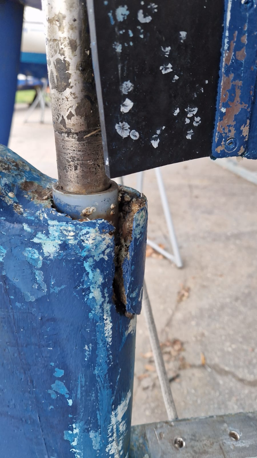

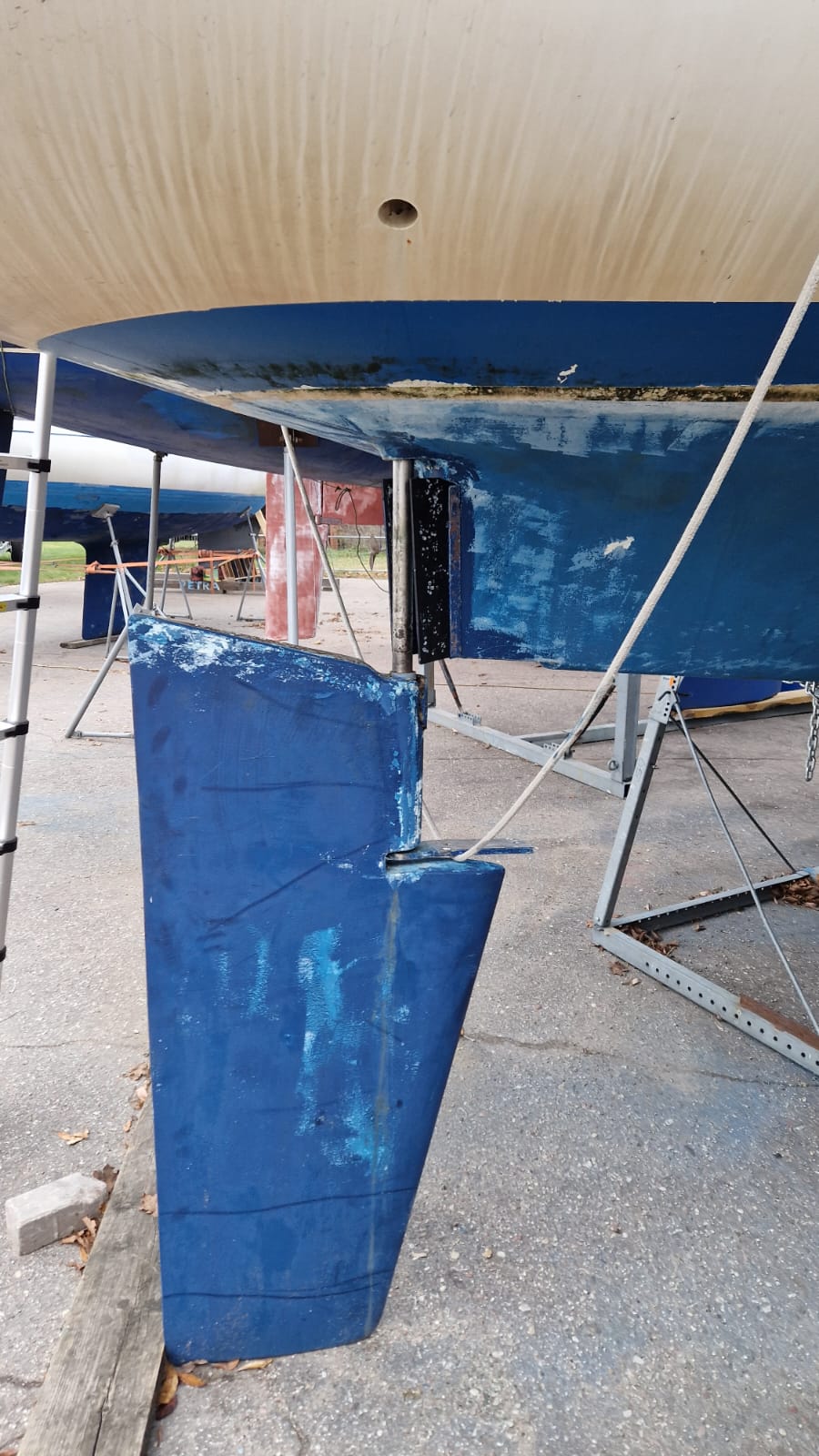

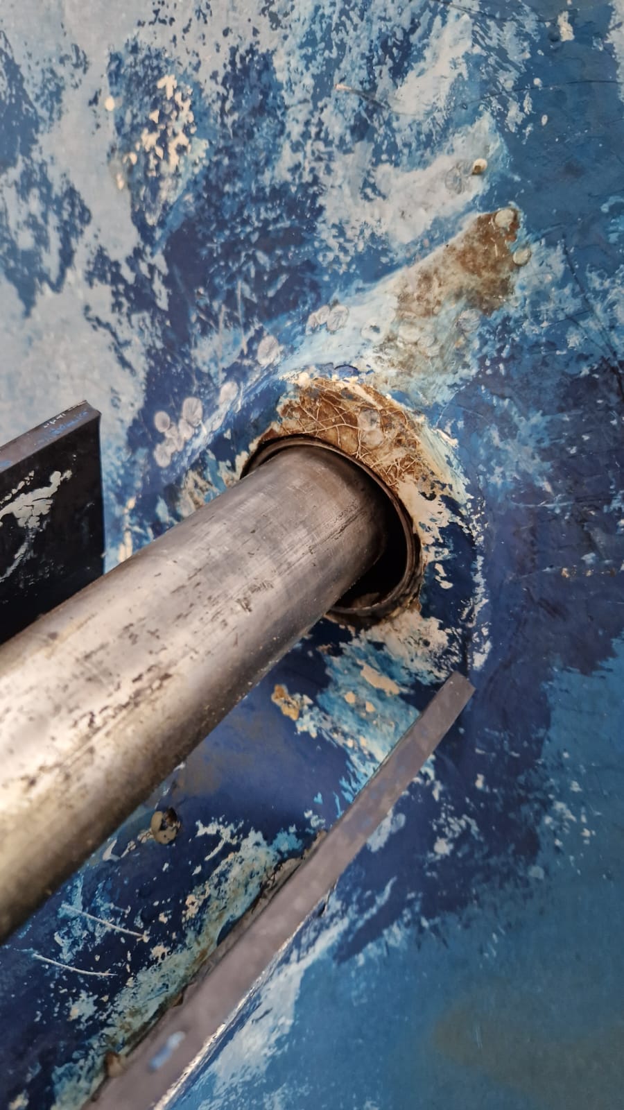

Thank everybody for the reply. My boat got some damages to rudder and rudder tube securing in hull. I am looking for repairs. Is it good to make repair with non-epoxy resin? (repairs planned inside and outside) By the way, what budget level of repairs could I expect?

Repairs are generally better made with epoxy resin rather than polyester. Epoxy has much better adhesion characteristics than polyester, it will form a stronger repair bond.
Because of the extent of the damage, the rudder should be removed from the boat and cut open to inspect the rudder post and the flanges. The barnacles suggest the damaged rudder has been in the water a long time. The foam inside and the metal may have begun to deteriorate and need replacing. This video series will give you a good idea of what's inside a rudder and how to repair it.
As for the cost of repair, I can't venture a guess as you are in Latvia and I'm in the US, don't have an idea about labor rates in Riga or the cost of materials.

Ouch! Take Dave's advice (above). We were quoted $5000 (USD) for a new rudder. That did not include repairing the shaft tube or bearings, which you will need to do.

You have a challenging project. Rather than tell you some of the ideas, I am attaching a source of knowledge that I trust and feel can help you in many more ways than just a single idea - quick answer.
Andy has demonstrated a deep and successful knowledge of the issues you will be facing. He is a valuable resource.
You have several issues. You need to repair the rudder shaft log. You need to establish new shaft bearings. You need to empty the water out of the rudder and reestablish water integrity so water does not again enter and destroy the rudder from the inside.
Andy has rebuilt rudders and recorded the process on his channel. If you are not a DIY type of person you will need to either buy replacements or hire the work to be completed.
