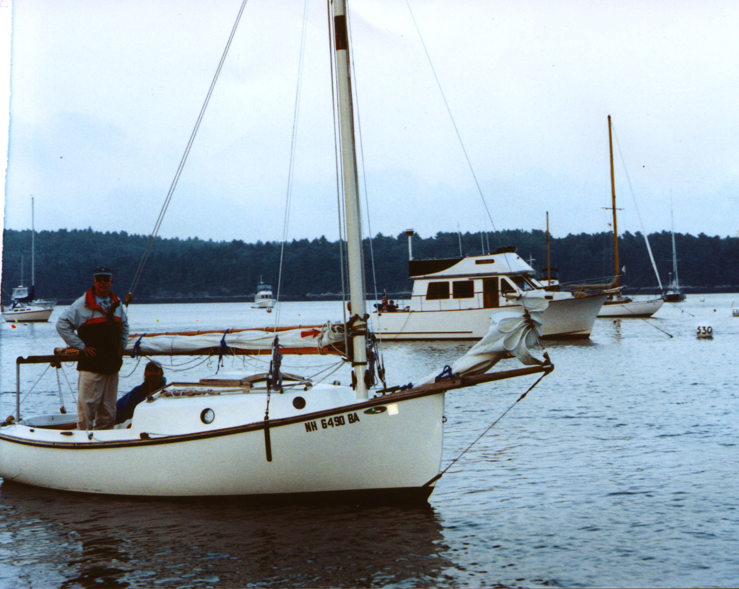

Oct 19, 2017
8,198
My father and brother aboard Puff, the Old Man's customized Suncat. He sailed her from Florida to Maine. She had a keel and a Volvo diesel engine, yet still managed a consistent 5 knots. My father said he could never understand it, but Puff did 5 knots no matter what point of sail she was on.
