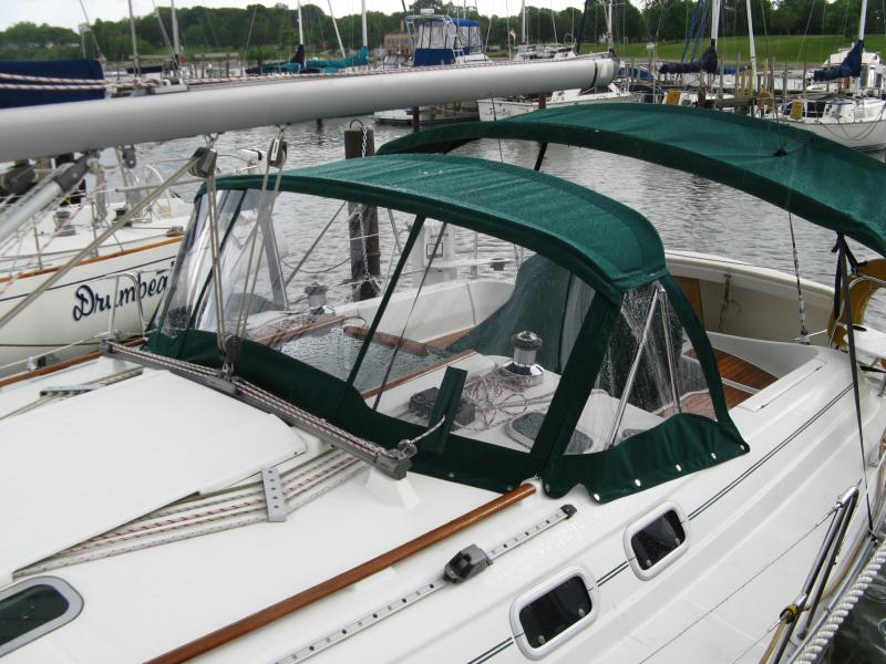

Ours has stiff panels on the front that zip out and soft panels on the sides.

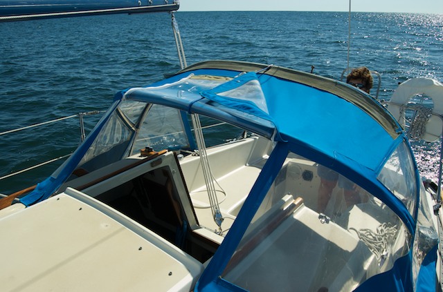

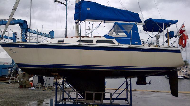

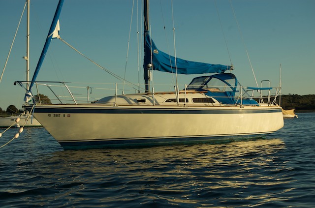

This is sunbrella and has connecting piece as well, just not on in this photo, very happy with it! 79 O'day 28

I looked at your photo and eb Site attached and have decided to call Boat Tailors. I will be making an appointment for them to come out and measure my boat for the Dodger. They look like a very good company ad I have heard no issues with their work.
Thank you and all the others who have given me comments on how to proceed.
