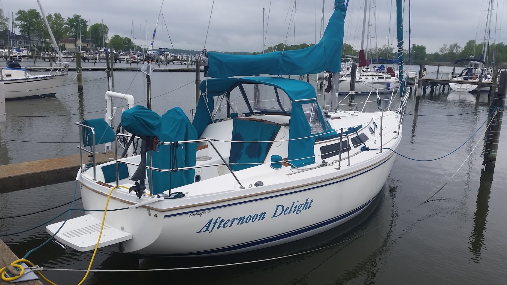

By far the best upgrade on my 1989 TR is the swim platform. Since we bought our boat we have done the following.
New cutlass and shaft
new motor mounts
new main sail
new furler
new standing rig
new VHF radia
new GPS
New depth transponder
new UV cover on head sail
Likes: 4sandybutts
Sep 25, 2015
60
Catalina 30 Middle River
The platform is basicly custom. I had the brackets made by a welder friend and the platform came from plasteak.
Likes: 4sandybutts
