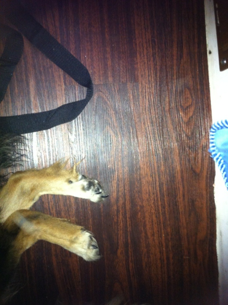

I removed it and installed peal and stick faux mahogany vinyl planks. We got a leftover box from Lumber Liquidators for under $40.
It is pretty thin and bends to the contour of the hull, can be cut to fit with a simple utility knife and the texture feels good on bare feet. Pet friendly also.

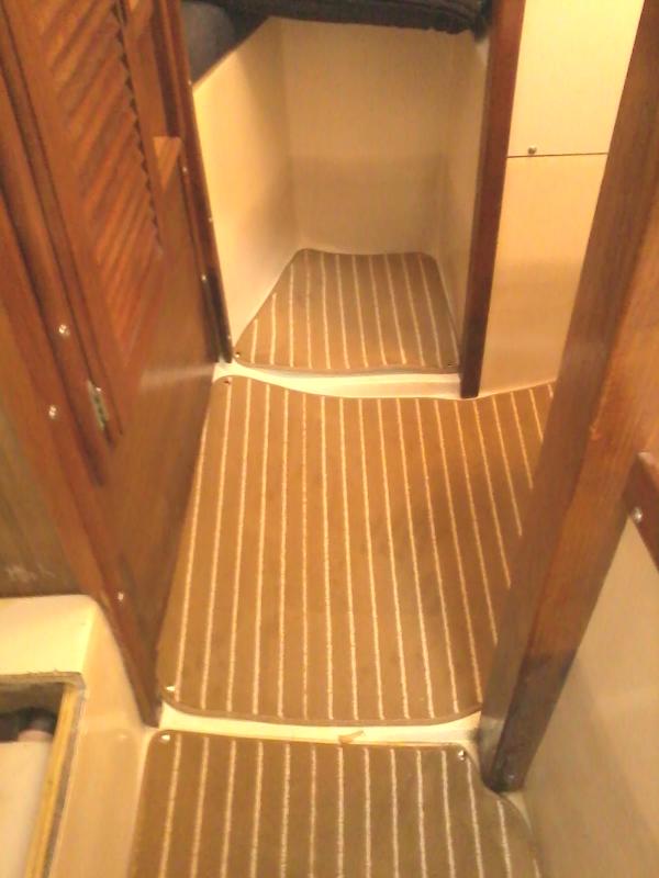

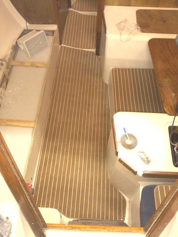

Towards the bottom of page 4, (link here: http://forums.catalina.sailboatowners.com/showthread.php?t=123450&page=4) You can see the snap in carpets I had made. Sent a pattern off and they made the pieces, even aligned the stripes from mat to mat. A previous owner had already installed snaps for fastening carpets, so that was an easy decision for me. Snaps came pre-installed and everything...
The carpets I had made were from an OEM carpet supplier to the marine industry, sort of a brother-in-law deal since I am a vendor to the marine industry, but I know others have the same capabilites.
I think the look of this carpet is really good on the interior. Kinda teak and holly looking sort of...

That looks gorgeous, I like this idea!

I bought a duplicate set of carpet panels for the companionway ladder. I figure that is the high-traffic locaiton. I also had them cut two boarding mats.
The stuff is run on a computer linearly, and based on standard width carpet rolls there is usually a fair amount of scrap. Your pattern will take "X" amount of length off of a roll. You will likely be charged "X" length times the width of the roll. Your material cost can sometimes be kind of fixed, as they can't do anything with the part of your total roll length not used; kinda like CNC-cut vinyl. So... with many custom-cut carpet houses, any material within that "X" length ideally should be turned into something. You pay for a fair anount of material regardless whether it gets bound or not, so doubling up on a few pieces adds a tiny bit of material cost, binding cost and labor. Total cost per square foot often slides downward up to the point where you use up a full width of a roll.
