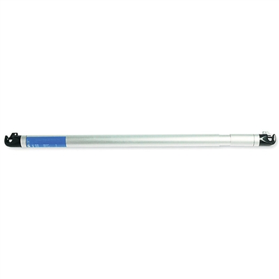

Here is a nice, lightweight whisker pole which I use on my MacGregor 26:
You could fashion one yourself from any number of telescoping devices (boat hook, paint roller rod, etc.), but a true whisker pole will come with the quick attach and release hooks at each end, and in the case of the Blue Water Yachts pole, two mounting brackets.
