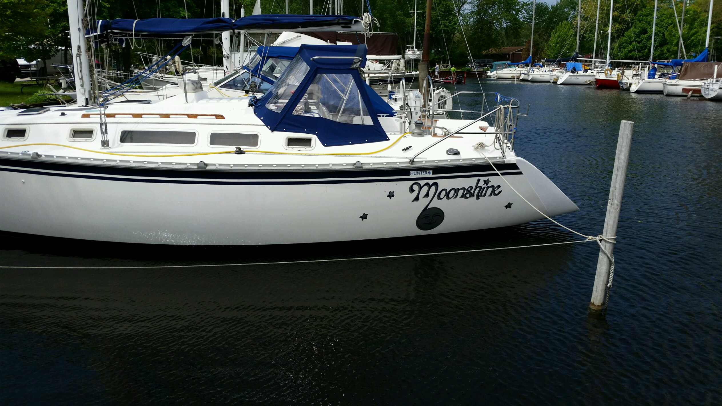

Interesting. I wonder what it looks like today. In the pics it looks added on. Some paint and striping would help integrate it. My goal next season is to get good at backing into my slip so we can use the walkthrough transom for weekend boarding. We're not getting any younger and my guests are land lubbers ! I have a stone jetty in front and boats on either side so it's a little intimidating.

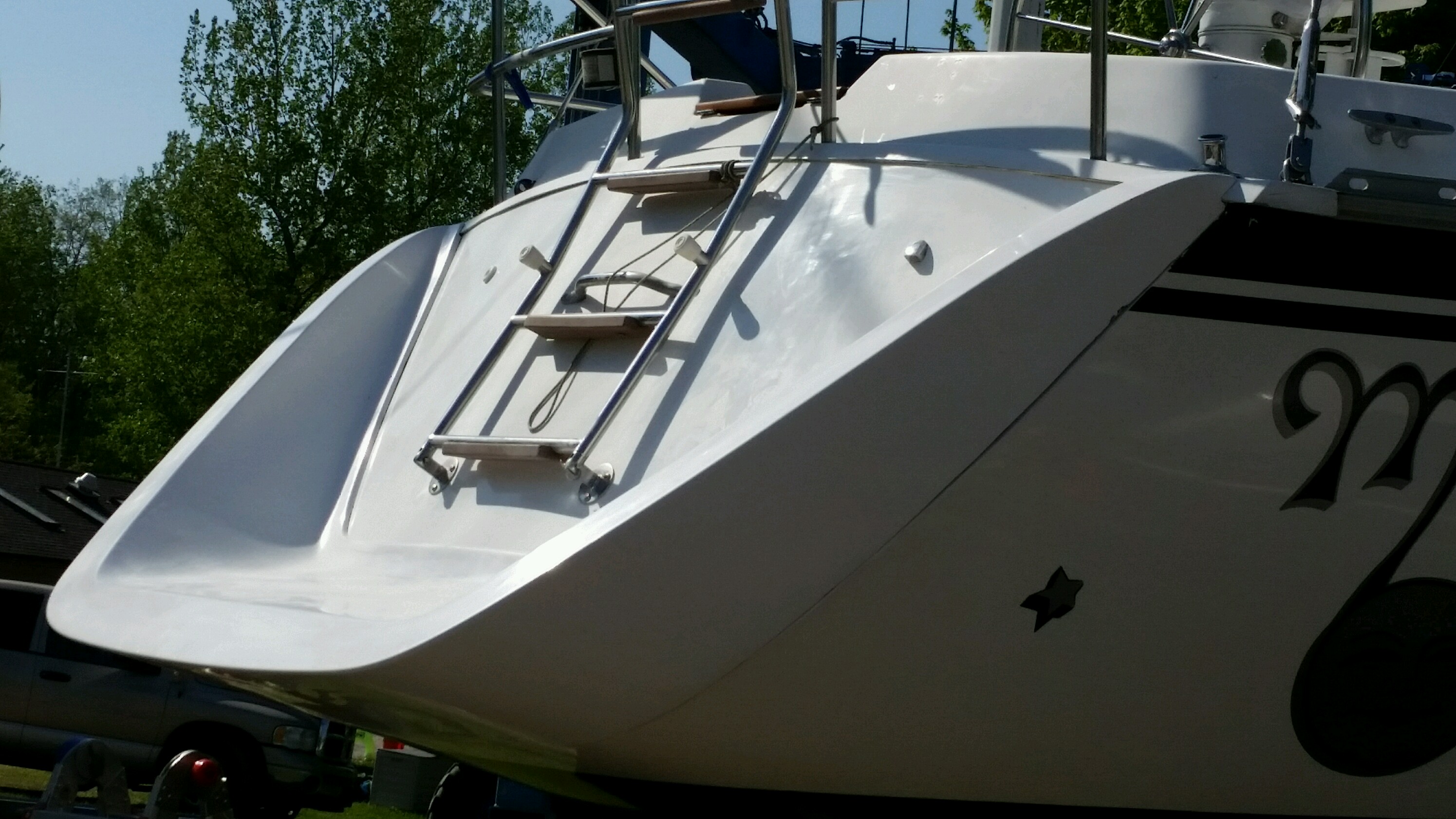

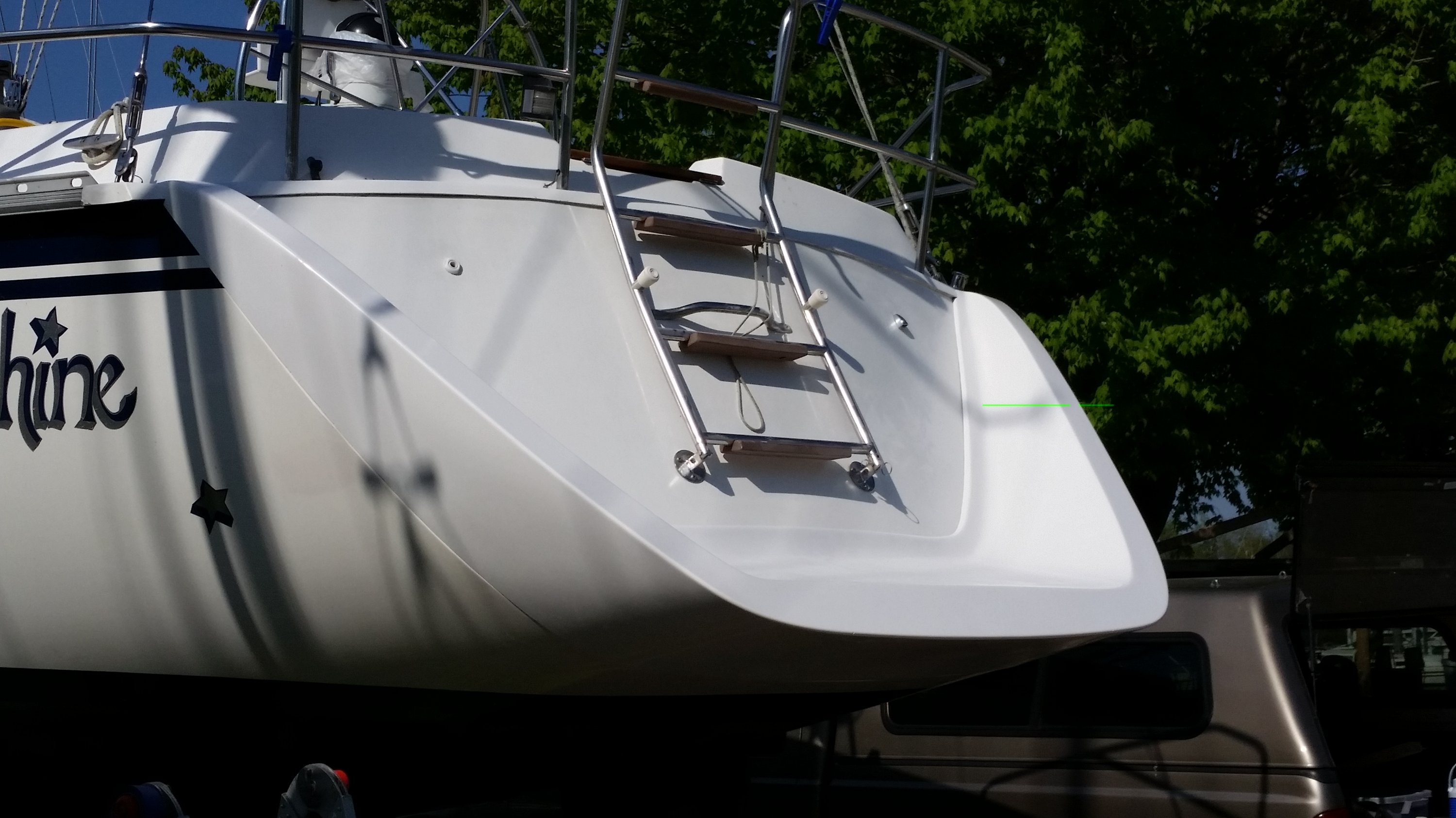

Hey guys I am a post virgin... yup post #1. I've stalked this site for many years and sucked a lot of great info from a lot of good folks; I thank you for your input. This past spring I installed a Sugar scoop on my Hunter 34 which we have sailed on Lake Michigan for the past 10 years. The scoop has made an incredible difference in the way the boat handles, it's like going from one boat to another! I have the mold to make this Sugar Scoop, if you would be interested in one for your boat, please shoot me an email at esmith755@yahoo.com. Have a great day!

Welcome EARL!!! Looking good Moonshine :O)
