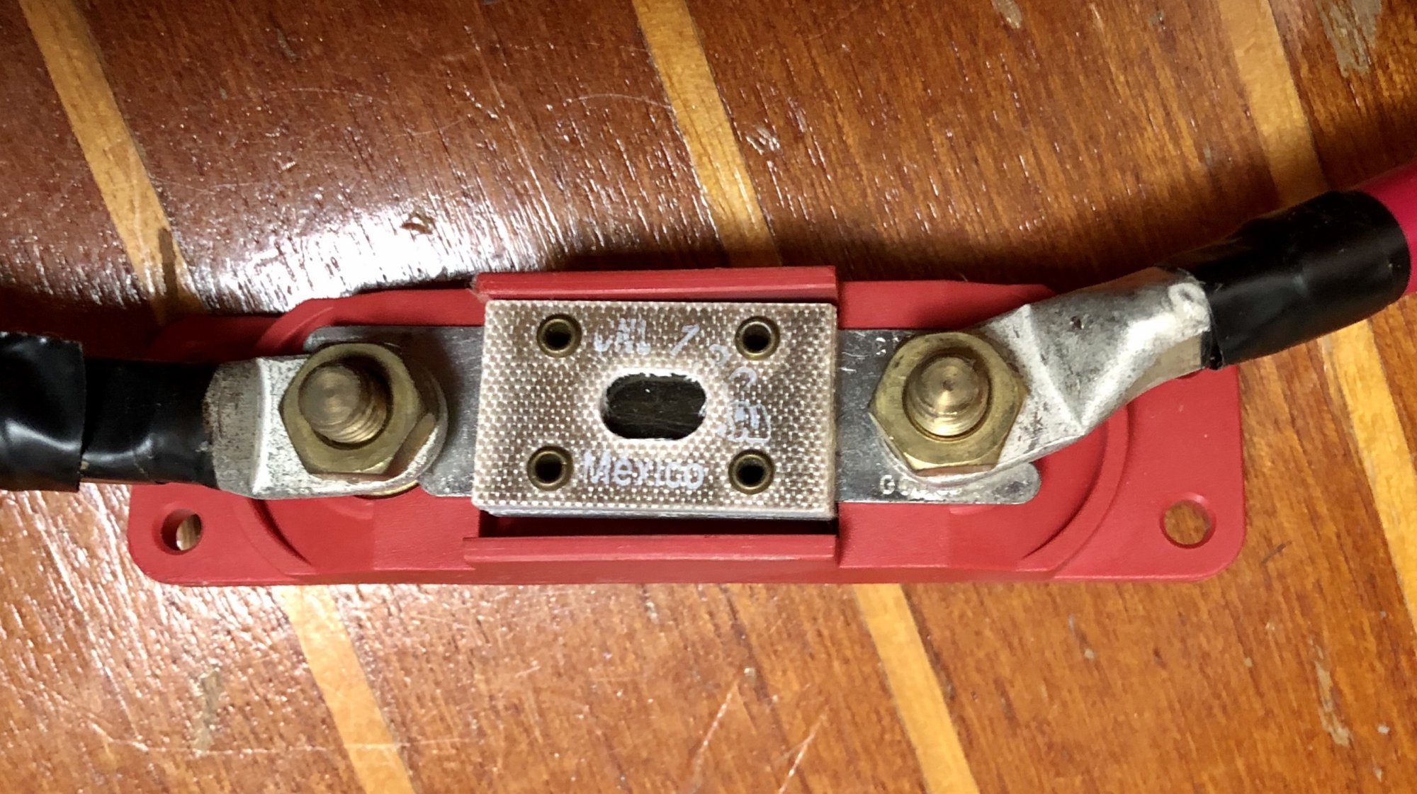

I'm not sure what you mean by "batteries did not supply their DC", since you are reading a charge of close to 13 volts. 13 volts is a full charge if your charger is not running. If you are not getting DC, perhaps you have an open breaker or fuse.
